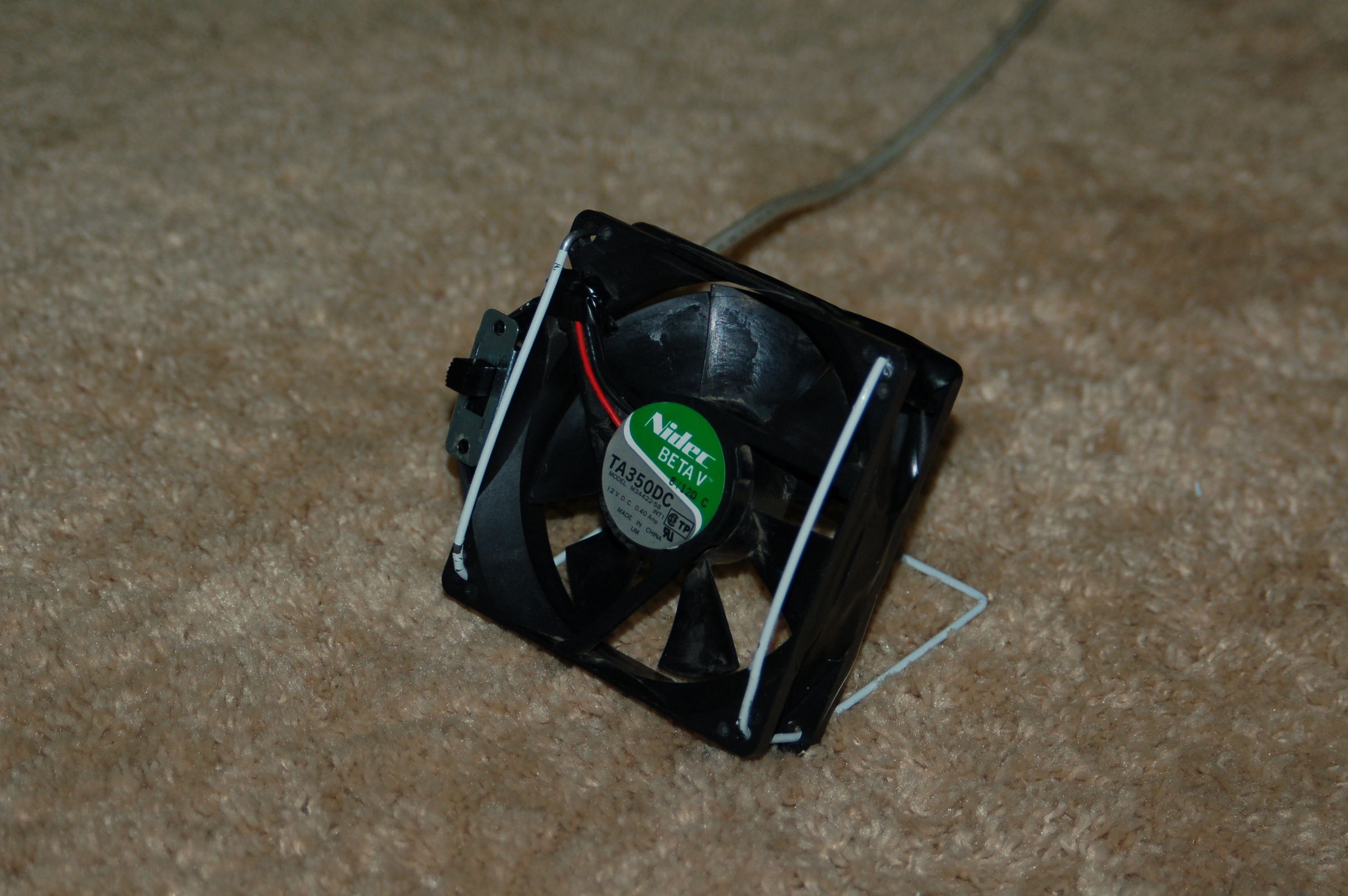

Step 10: Put Power Transformer, Amplifier, Voltage Regulator, and Fan Into Case.
Solder the audio output wires onto the proper points on the amplifier, and the power input wires to voltage regulator, the hot to the right pin and and neutral to the middle pin. Solder the speaker wires onto the appropriate parts of the amplifier as well. This is a good point to test your iCylindr at, so try it out now. If it doesn't work right, check everything. If it works fine, then continue. Squeeze the fan through the hole it is for and hot glue it into place, and hot glue the amplifier to the case so the volume control is freely moveble through the hole you cut for it. All of the things you have in the case right now, and the clock which you will add later should be grounded togetherif they have ground. the ground on the ipod jack would be the metal outside of the jack.

Step 13: Cram It Together
Cram everything in there and put the bottom of the case on, making sure the extention cord is in the designated slot you filed. Be sure to give the voltage regulator and heatsink some open area inside.
