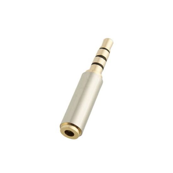

Step 4: Prepare the Headphone Jack
Take the sleeve off of the headphone jack by unscrewing it, and then snip the end off where the cord comes out of. Using the metal file again, I ground down the end I just snipped off to make it even again. Lastly, I took a box-cutter, and split it in half to accommodate for the LEDs I would be putting in there.
Step 5: Solder LEDs to Eachother, and to the Headphone Jack.
After the epoxy had set, I bent the leads of each LED towards each other, then solder them together at a very high spot close to the plastic dome of the LED. After I soldered them to each other I trimmed a lead from each end, so I effectively had two leads for two LEDs (instead of four leads). I then threaded the leads through the holes of the stereo jack, and soldered them into place.
Step 6: Re-Sleeve the Headphone Plug With Heat Shrink.
I took the cut plastic casing for the plug and re-sleeved the stereo connector with it. After the metal components had the original plastic on it, there was still a gap. I cut a small piece of 1" heat shrink, and slid it around the original plastic. There are many ways to seal heat-shrink, I personally like doing it with the barrel of a soldering iron. Others will tell you to do it with a heat-gun, and I have even seen it done with butane lighters.
