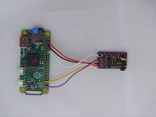

Step 1: Connect Hardware
I decided to use a different digital audio board to my earlier HQ Audio project, still a PCM5102A. This is because this one is easier to wire up. A number of connections (settings) can be set via solder bridges on the board. The one I got had the default settings already set and I only had to bridge the link to set SCK to ground.
First solder the PCM5102 board links. There is one on the top side to link SCK to ground. We need the board to use its own clock and it will only do this is there is none on the SCK input. Then, if needed, close 3 of the four links on the bottom of the board to ‘L’ (1, 2, 4) – for FLT (normal filter), DMP (De-emphasis off) and FMT (format I2C). Link ‘3’ to ‘H’ - XMT (software mute off).
There are 5 leads to connect to the Pi. However if the amplifier is being driven from the same power supply (common ground) it is better to connect the ground on the PCM5102 board to the ground on the amplifier input in order to eliminate noise on the ground wiring. The connections are:
Board | Connect to | Pi | Function |
VCC | 5v | pin 2 or 4 | Power |
GND | GND | pin 6 or 14 | Ground |
LCK | GPIO19 | pin 35 | data word clock |
DIN | GPIO21 | pin 40 | data |
BCK | GPIO18 | pin 12 | data bit clock |
The amplifier choice is very much a personal preference. Most can be connected via a 3.5mm phono lead. I used a JBL On Stage dock during the development and then disassembled a JBL Radial dock for the final system.

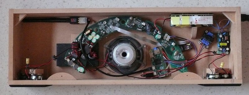

Step 6: JBL Dock Reassembly
I had an old JBL Radial dock that was not being used and hence thought I would move the internals over to a new enclosure that would fit my revised purpose. This dock has tactile switches for volume up/down and would be easy to drive from the Pi (if connected to ground - confirmed OK later). Node-Red can drive the Pi GPIO pins. I could also keep the switches in case I wanted manual control later.
The JBL Radial does not come apart easily! However it helps when one is planning to discard the enclosure. The metal grilles are held in place with hot-melt glue so a hot air gun – preferable a lower power type (e.g. for applying heatshrink film) - helps. A hot air soldering gun might work. With the screens removed the screws that hold the main halves together are easily accessible. Then there is a load more hot-melt glue to soften to get into the base to extract the input circuit board and volume control switches. Eventually one can separate the electronics and make sure all still works. I left the speakers in place for as much as possible as the very strong magnets soon pull something you don’t want into the cones.
Next came the question of power supplies. The dock is 24v and the Pi 5v. One option was two supplies and use the Pi to turn the dock off when not in use (via a mains isolated switch). The alternative is to use a single 24v supply plus DC-DC converter to give 5v and use a MOSFET or similar to turn off the dock.
The system would be off more than on and the idle current of the 24v supply around double the 5v supply. Hence the idle current would less using two supplies and turning off the 24v supply when the system is not being used. Logic driven mains switches are available on ebay – but beware the one I got does not have the track separation distances for ‘double isolation’. Hence only use these if you understand the requirements for safe use.
If you're running the Raspberry Pi without a screen there's no need to power the display circuitry, and you can save a little power (25ma) by running /usr/bin/tvservice -o (-p to re-enable). Add the line to /etc/rc.local to disable HDMI on boot.

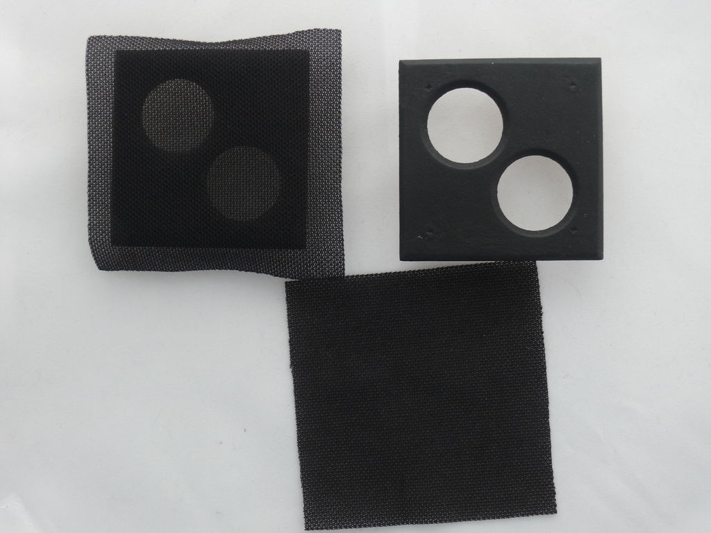

I made the enclosure from 9mm MDF board. I wanted to minimise the height for the under-cabinet location. This led me to mounting the woofer downwards plus making rebates in the top and bottom panels. I used a hole saw to make the holes for the smaller speakers and cut the woofer hole with a coping saw. I then made rebates for the speakers using a router carefully by hand.
I made speaker grilles from 3mm MDF. After epoxying screws in place I sprayed these black and then covered in speaker cloth.
See below the completed internals:
The plan is to finish the case in vinyl but we plan to change the kitchen units and hence will select the vinyl to match.
