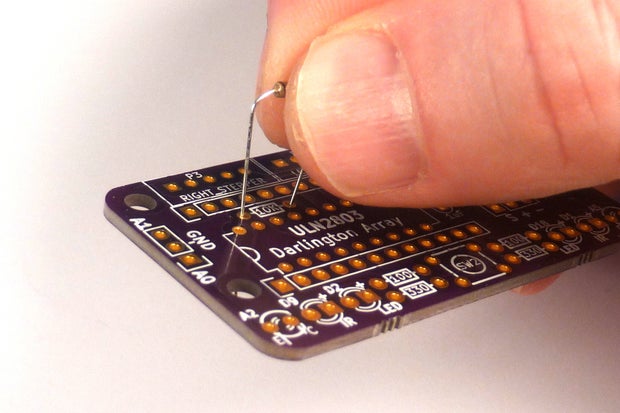

You can do one at a time, or all six at once.
  • Bend the leads to the width of the pads and insert the resistor.
  • Flip the board over and heat both the pad and lead for about two seconds.
  • Introduce solder, and maintain heat until the solder melts and flows around the pad.
  • Remove the solder, and then the heat, in that order.
    • If your solder gets stuck, just re-heat the joint.
  • Trim the leads with flush cuts.

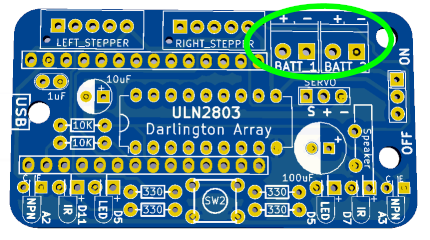

Power from the two battery holders are connected via the two black terminal headers. The openings face outward as well.
  • Solder one pin from each terminal.
  • Flip the board and verify the terminal is flat and openings facing out.
  • Solder the remaining pin.

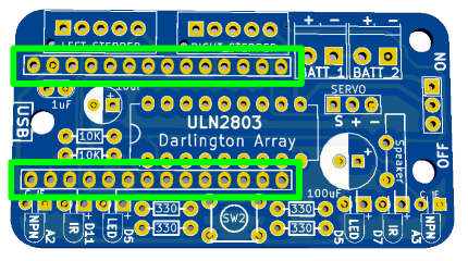

The control from the board comes from a microcontroller inserted in to two rows of 14 pin headers.
  • Solder one pin of the header (any location).
  • Verify the header is seated flat and vertical and adjust if needed.
  • Solder the remaining pins.

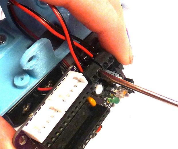

Step 17: ME: Batteries
Integrating the electrical components like motors and batteries with the chassis will fall into the ME's domain.
  • Attach the battery holders using two M3 flat-head screws and thread the wires through the openings under the motor mounts.
  • Put on your "EE" hat and attach the positive and negative wires to the terminals marked "+" and "-", one set of batteries for each terminal.

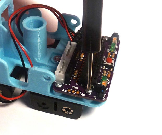

  • Attach the circuit board to the chassis using #2x1/4 thread-forming screws.
    • If the screws wont start, remove the PCB and use the tip of the screw driver to open them up a bit.

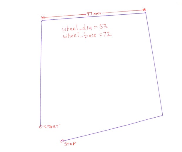

Adjust wheel_dia parameter first. Measure the length of side of the square. It should be 100 mm:
  • If the measured distance is too long, increase wheel_dia.
  • If the measured distance is too short, decrease wheel_dia.
After you have the distance calibration, adjust the wheel_base parameter which affects the angle of the turn. Place the robot on a fresh sheet of paper, turn it on and let it draw all four squares:
  • If the robot is turning too sharply (box is rotating clockwise), decrease wheel_base value.
  • If robot is not turning sharply enough (box is rotating counter-clockwise), increase wheel_base value.
  • Because of rounding errors in the stepping code and slop in the gears of the inexpensive steppers, you will never get it perfect, so don't spend too much effort on it.

If you are having trouble saving sketches to the ItsyBitsy:
  • Unplug and reinsert the USB cable.
  • When saving any sketch, the board should reset (you should hear beeps).
  • Ask for help in the comments or Adafruit forums.
No power when on-switch turned on:
  • Ensure you have fresh batteries.
  • Ensure batteries installed correctly.
  • Double-check battery connections to terminal blocks.
  • Disconnect servo & steppers.
  • Use a volt meter to verify voltage at terminal blocks.
