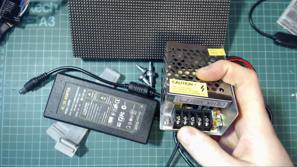

Power Supply
The first thing we'll need is a pretty large 5v power supply, Adafruit suggest that 64x32 matrix can require up the 8 Amps! This is worst case scenario (all LEDs set to white) so in reality you probably won't need one that big, but there is no harm in having the head room. There are two different types of power supplies that you can get:
Types of PSUs - Laptop style on the left
One is similar to a laptop and has a 2.1mm jack as its output and there other is more similar to type that comes with 3d printers.
I much prefer the laptop style as the other requires you to connect mains voltage wires to it, and working with mains voltage is something I like to avoid as often as possible! Here is a link to the same type of one I used (5v 8 amp laptop style)

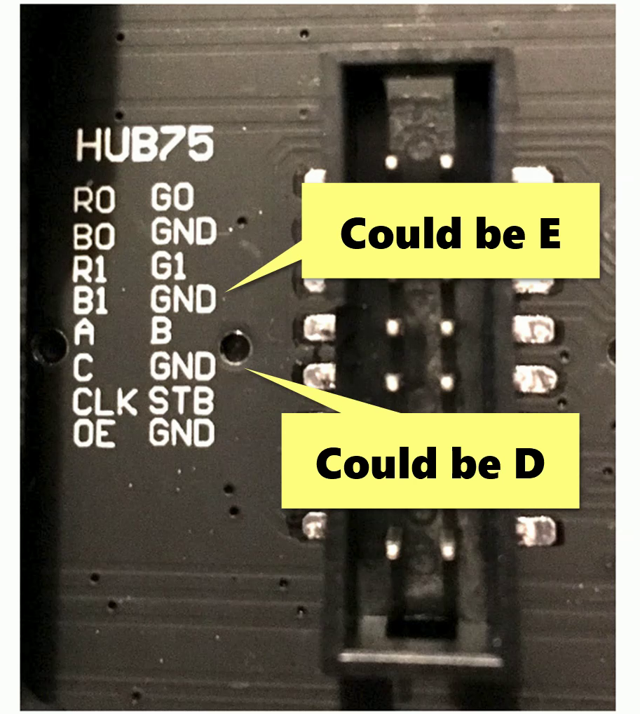

You'll notice on the back of the display that there are two connectors, the one you want to wire to is the one where the arrows are moving away from it
Some of the pins are not needed depending on what display you have, these are the C, D and E pins. The library lists instructions for when you need to connect up these pins based on the scan rate of your display:
Display PinESP8266 PinNote
C15 (D8)Only for 1/8, 1/16, 1/32 scan
D12 (D6)Only for 1/16, 1/32 scan
E0 (D3)Only for 1/32 scan
Although my display is a 1/16 display and I needed to for E connected up. This is what it looked like without it:
The best way to check if they are required for your display is they seem to be connected to ground on displays where they are not needed. Get your multimeter in continuity mode and check these pins against the ground pin, if the pin is connected to ground you don't need it

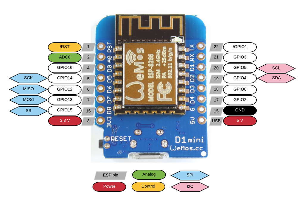

One other note. If you are using a ESP8266 that doesn't use pins labeled with a "D" in front of it (e.g. D1, D2 etc) you can use the following Diagram to map the pins to the ESP pins. For Example D1 is connected to GPIO pin 5, so if your board uses the GPIO pin numbers connect that connection to 5.
