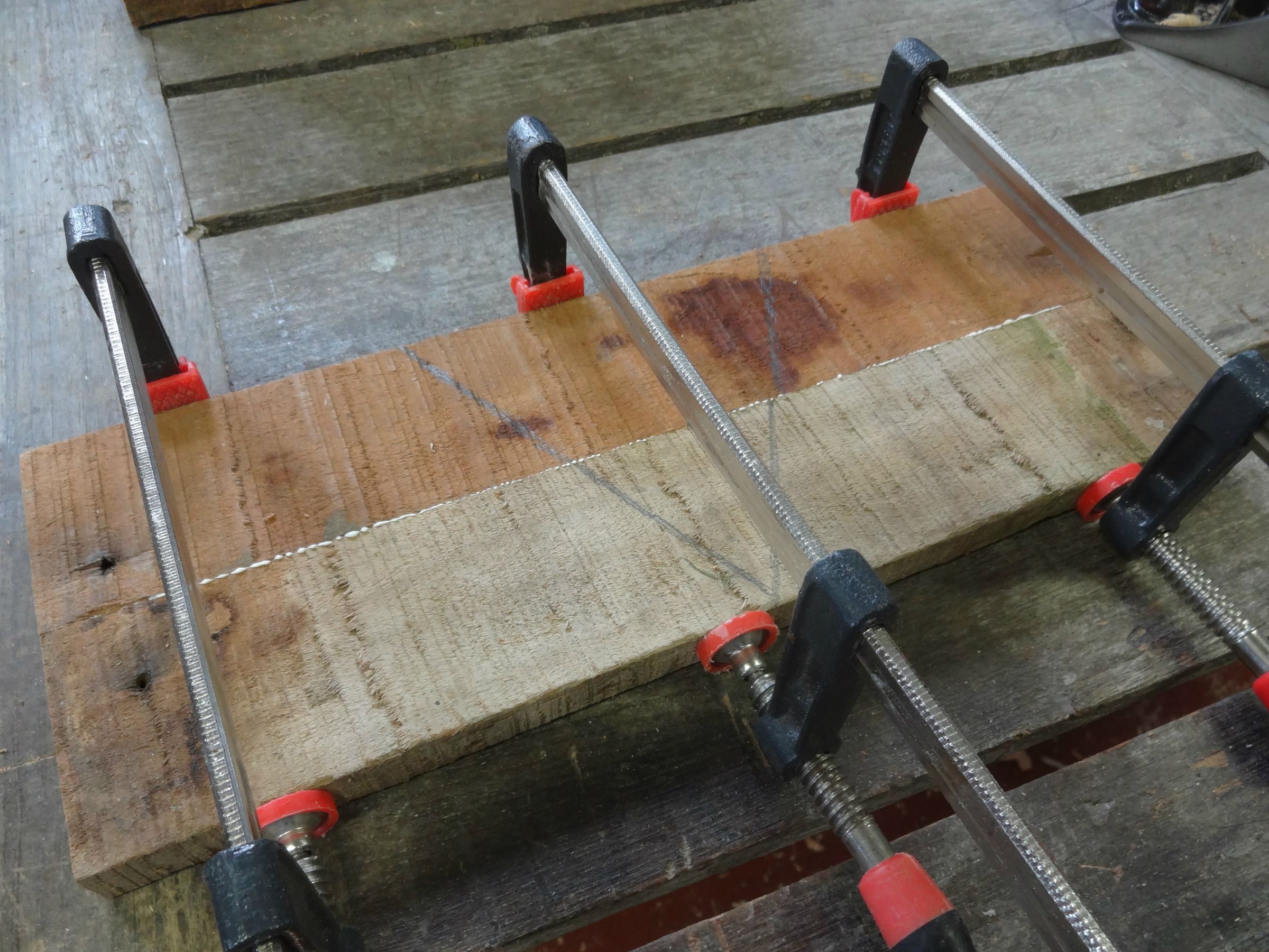

Step 2: Gluing Up the Sides
Decide what length and width you want your treasure chest to be. Then roughly cut your slats a bit over-sized (more or less 1 inch or 2.5 cm extra), as seen in picture 1. No need to be accurate here. To get the appropriate height for the box, we'll need to glue 2 slats together. Mark how they go together with a triangle (pic 2) and flip them so the markings are on the outside (pic 3). We'll plane both edges together, to ensure a seamless fit. Because the edges are so rough, first plane them with a scrub plane (pic 4). This is a Stanley no.5 jack plane that has been converted to a scrub plane. It has a cambered blade in it, that produces nice thick shavings (pic 5) that get you to a clean surface quickly. After the scrub plane, plane the edges with a smoothing plane (pic 6) until you get continuous shavings from both edges.
Test the 2 boards for gaps by holding them together. Avoid gaps near the ends, because that means your edges are higher in the middle and the glue up will eventually fail. A slight gap in the middle (meaning the edges are slightly hollow) is not a big deal because it puts extra pressure on the ends, so that they never come apart. Once you have a seamless fit, put some wood glue on 1 edge and rub it back and forth against the other edge:
Put some clamps on, and leave to dry for at least a couple of hours:
Do the same for the other panels, and you should end up with two long sides and two narrow sides (presuming your box is rectangular, like mine):

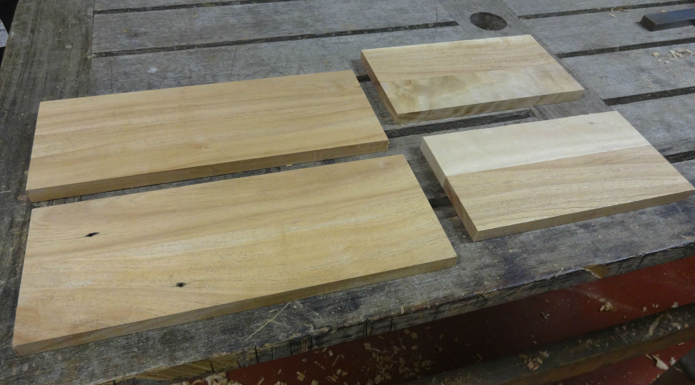

Step 3: Planing and Dimensioning the Sides
Now that we have 4 panels, we need to get them smooth and the same thickness. If you haven't done this before, I suggest you watch this video first. We start off with a scrub plane (pic 1) to get the roughness out of the board quickly. Then we come in with a smoothing plane to get a flat and smooth surface (pic 2). Don't forget to check this surface for twist with winding sticks (not shown). This flat surface is called our reference surface, and we mark it with a cursive letter f (stands for 'face'). Plane one edge square to our reference surface (pic 3), using a square to check. Next, measure the width of your panel from both ends, draw a line and plane to that line (pic 4). Now that we have 1 flat surface and 2 square edges, we can simply use a marking gauge to mark the thickness (pic 5). Lastly, we can just plane towards our gauge lines. If the reference surface was flat, this surface should be perfectly parallel to it and flat as well.
To ensure the other panels have the same width, you can use the first panel to mark them (pic 6). If there is too much wood left to plane away, use a rip saw (pic 7).
Leave a millimeter extra, so you can plane exactly to the line. When all panels are planed exactly the same thickness and width, you can cross cut them to length (pic 8).
To ensure the edges are square, you can use a shooting board (pic 9).
This shooting board was made from some leftover plywood, and is very easy to make. After a lot of sweat (and perhaps even tears) you will have 4 panels like this:

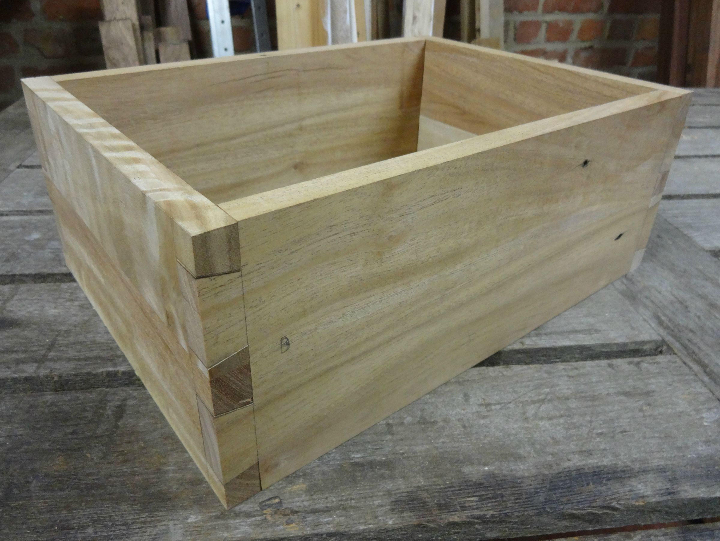

Step 4: Joining the Sides With Dovetails

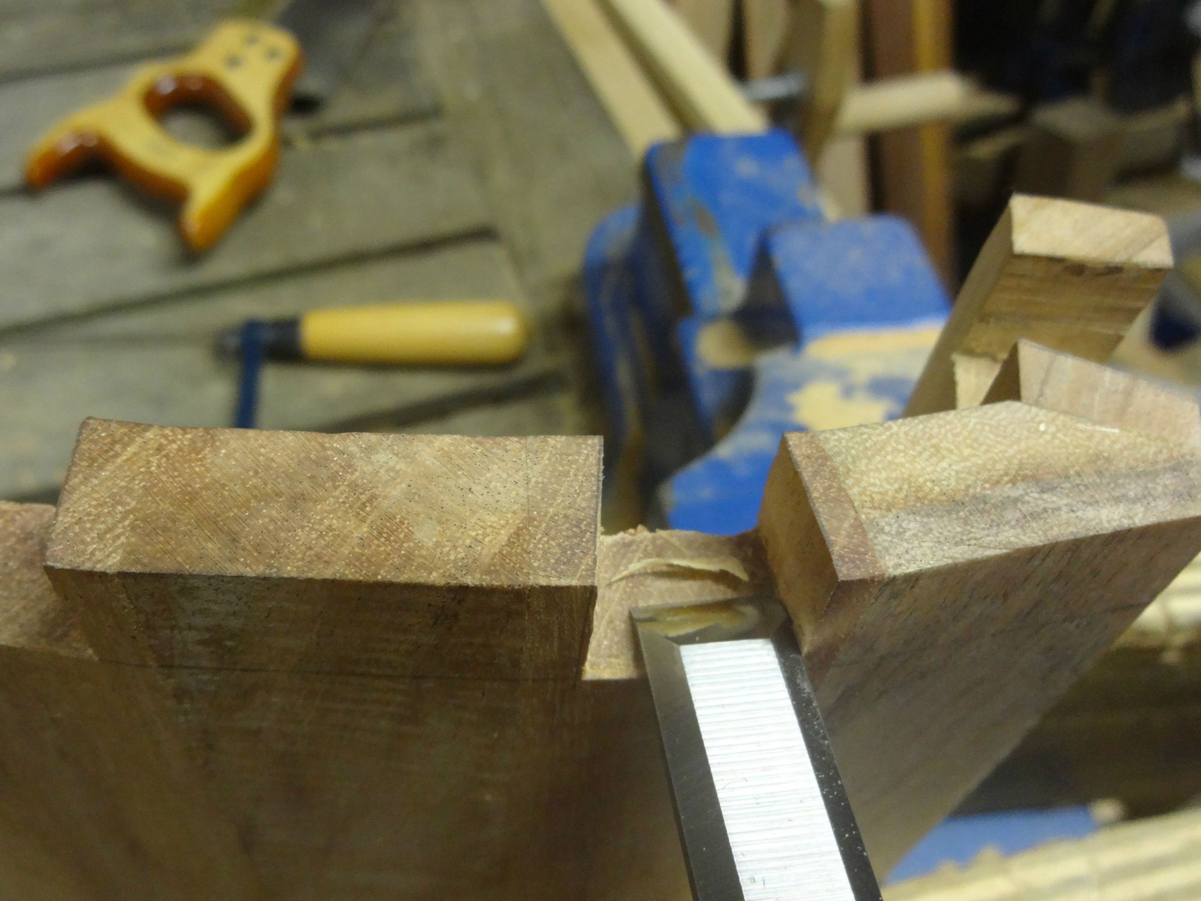

Now that we have our 4 sides, we can join them together. The simplest way would be to nail or screw them together (so called butt joints) but I decided to go for a fancier and sturdier construction with dovetails. If you're new to dovetailing by hand, watch this video first. I decided to make the tails on the long sides (the front and back) of this treasure chest, so that they are easily seen. If the pins were on the long sides, you wouldn't see the angled cuts and it would look more like a box joint.
I won't explain the dovetail method in detail, because the above video does this better. I will however give a brief overview of the process. I laid out the dovetails using a homemade dovetail template with a 1:7 pitch (pic 1). There are people that use compasses to lay out the distances, but you can pretty much choose whatever distances you want. Just pick something that is pleasing to the eye, and stick with it. However, on the ends of the tail pieces, leave enough space for a groove that will accept the bottom (see later). If you don't, the groove will run through the tails, and you'll have to plug them up.
Use a back saw to cut out the tails (pic 2) and make sure to cut on the waste side of the pencil lines. The corners can be removed with the saw, and the middle piece has to be chopped out from both sides (pic 3). Transfer your tails onto the pin piece with a sharp pencil (pic 4) and cut out the pins as well (pic 5). Notice the X's to indicate waste wood, so you know which side of the line to cut to. Chop out the waste (pic 6). Then test fit your joint:
The pins are slightly protruding, but that's what we want. We'll trim them flush later. If the joint won't fit, you'll have to find the problem areas and trim them slightly with a chisel. Usually, the problem areas appear as shiny spots because the wood has been burnished by the friction.
Now do this entire process three more times, and you should end up with something like this:
It's a very good idea to mark all your joints with letters, so you know how everything goes together.

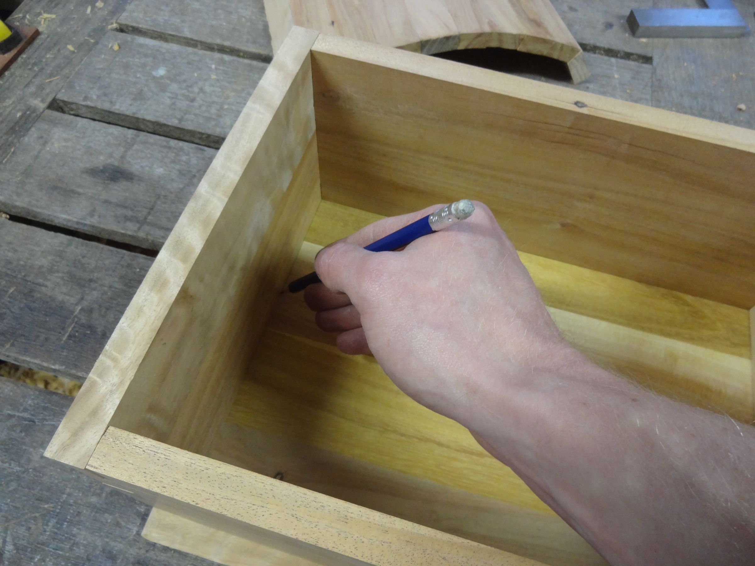

Assemble the sides and make sure they fit well. Plane the edges of both bottom and top (pic 1) to ensure that all sides are level. Try to skew your plane so that it registers on two edges. It's important to do this planing step now, because we will make a groove to accept the bottom, and we'll be using the edges as reference.

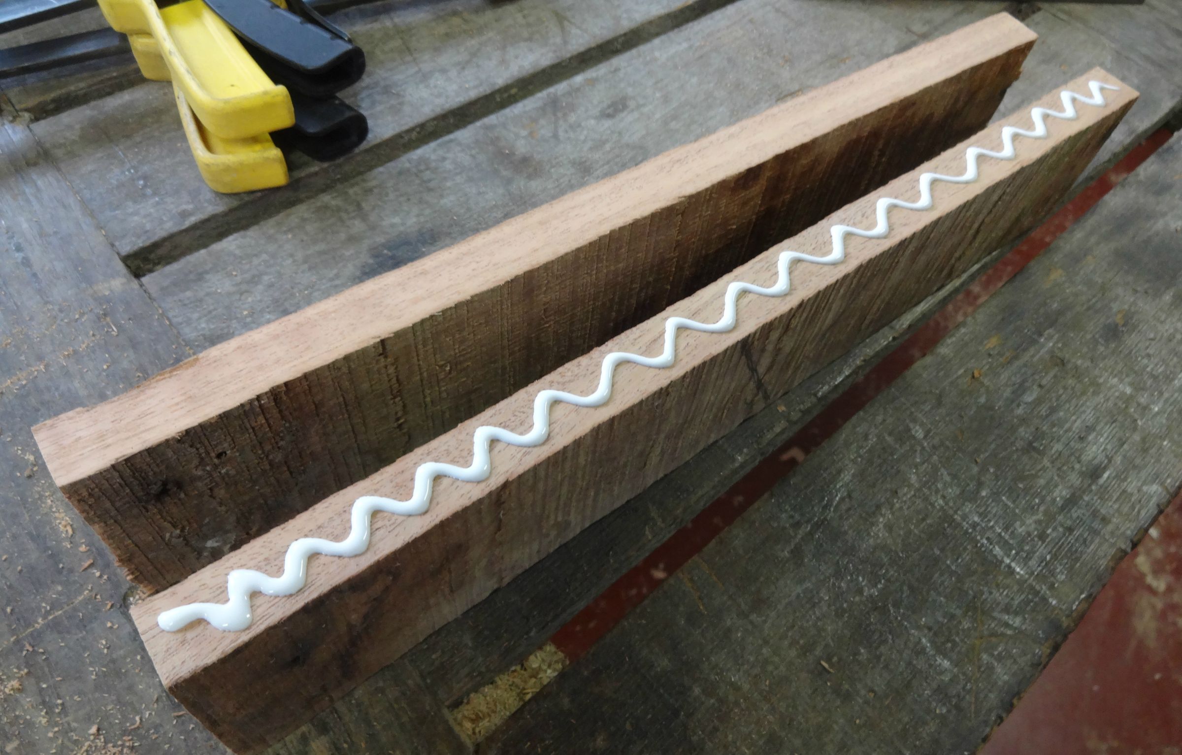

With a box this size, you can not simply glue the bottom on. Wood expands and contracts because of differences in air humidity, and this wood movement can not simply be ignored or your box might not stand the test of time. To solve this issue, the bottom panel floats in a groove, with a little bit of play. To make the groove, I used a Record 044 plow plane (pic 2) with a 5/16 inch cutter (about 8 mm) and a depth setting of 6 mm. It's a fantastic tool that makes grooves in no time. Notice the cutter is guided by a fence, so that's why we had to plane the edges flush first. Otherwise, our groove might not be aligned on all 4 sides. The resulting groove can be seen in picture 3. In determining the position of the groove, make sure you don't plane into the tail of your dovetails. That's why it was important when laying out the dovetails (step 4) to give yourself enough room here.
Now it's time to glue up a panel to fit into this groove (pic 4). This is the same procedure as in step 2, only with four boards instead of two. When the glue is dry, plane everything flat with a scrub plane (pic 5), followed by a smoothing plane. With this particular panel, I had trouble getting it nice and smooth without tear-out because of the way the grain runs. Planing across the grain seemed to work wonders, with both scrub plane and smoothing plane. This left a slightly rougher surface than you would normally get from planing with the grain, so I followed up with a card scraper (pic 6) to smooth it out. Notice the wispy shavings. If you're not getting those, it's time to sharpen up. Set your marking gauge just slightly less than the width of the groove (in my case 7.5 mm or so), mark the edges of your panel and plane to that line.

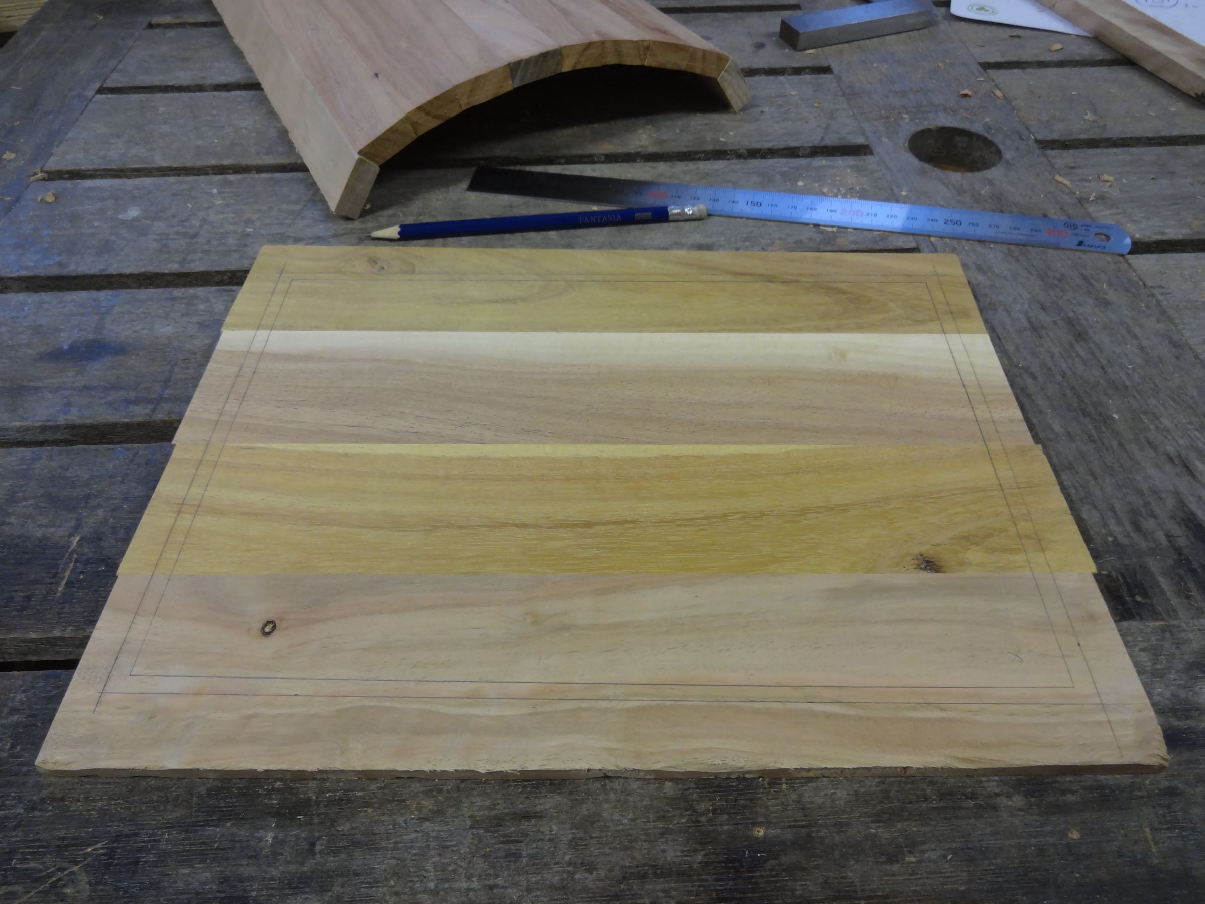

Now that our panel is the right thickness, we need to cut it to size. To do this, set the box onto the panel and trace the inside with a pencil:
Now add the depth of the groove (6 mm in my case) on the end grain sides (left and right on this picture):
Wood doesn't move in this direction, so that's why it can and should be a tight fit. For the long grain sides (top and bottom on above picture), subtract 1 mm from your groove depth (so add 5 mm instead of 6 mm in my case). This will allow a total of 2 mm play, in case the wood expands. It's difficult to predict wood movement, but let's hope this is enough wiggle room. Once it's cut to size, test fit the bottom, making sure all joints close up nicely:

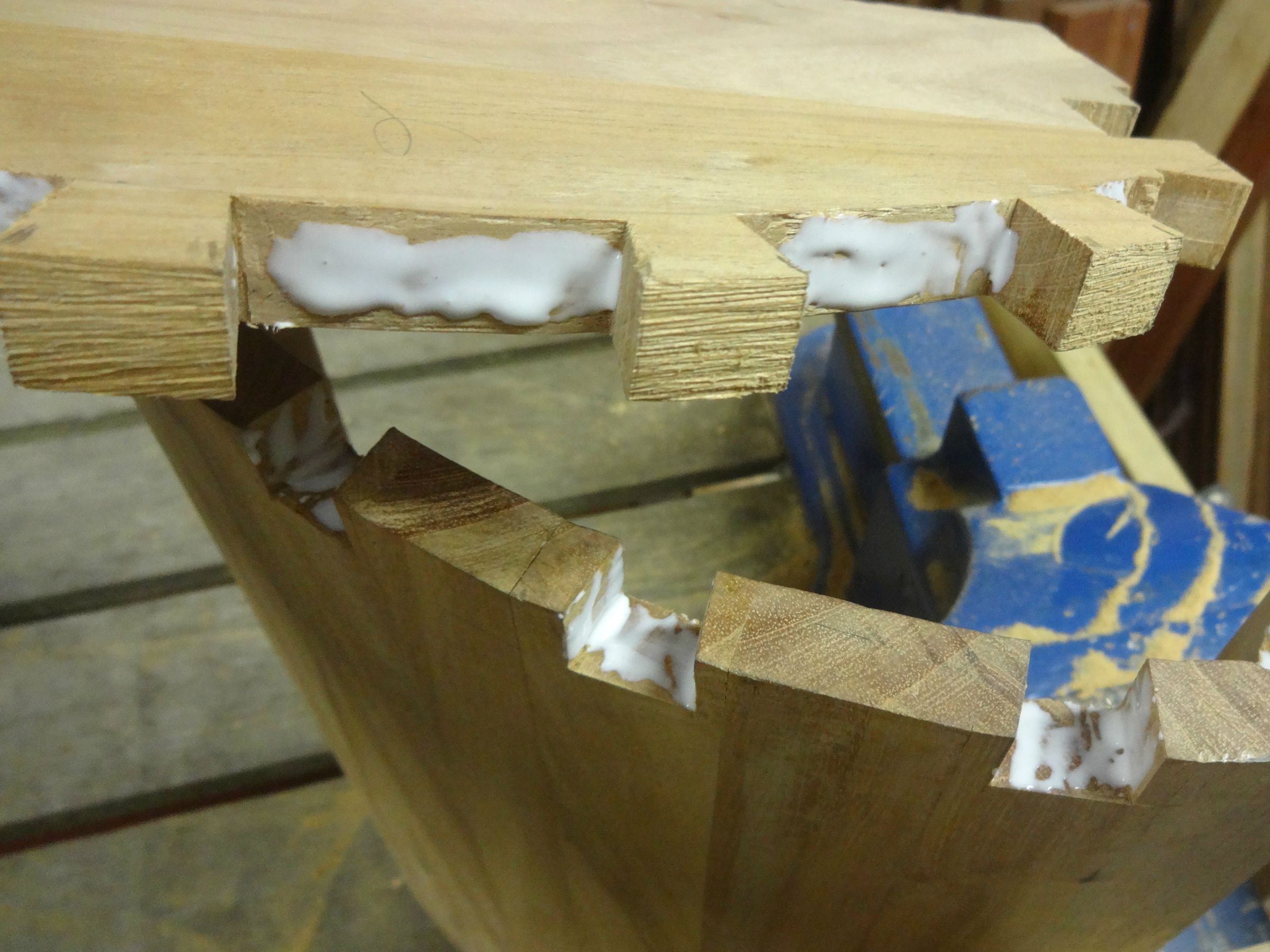

Step 10: Gluing Up the Box and Plugging Pin Holes
While you're gluing, it's time to permanently join all sides of the box together as well. Make sure you rehearse this glue-up without glue because it's possible to make a mistake while assembling. If your final piece is a pin piece, there's no way you can fit it in. So always leave a tail piece for last. For the gluing itself, I find it best to put a glob of glue on a scrap piece, and then use a thin strip of wood to apply it to the tail recesses (pic 1). Don't forget to put in the bottom before you glue in the last piece. Don't put any glue in the groove, so the bottom can move freely. Them clamp everything up from all sides (pic 2). Both diagonals should be the same if your box is square. If not, adjust this with hand force and then tighten all clamps.

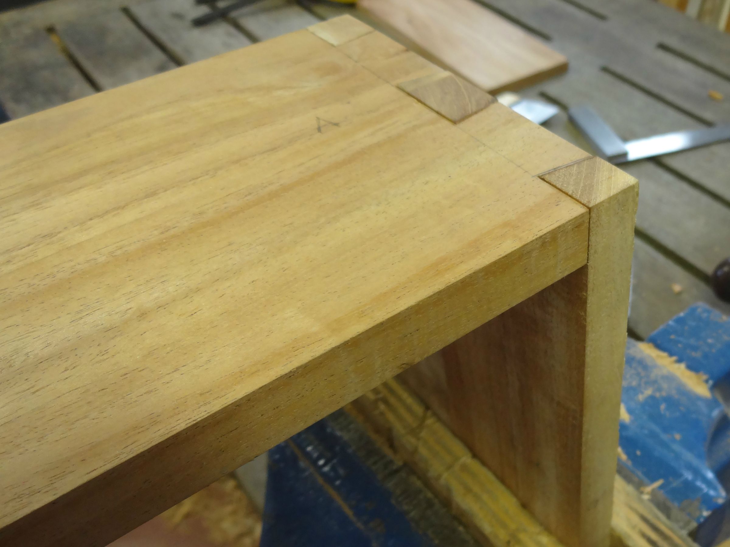

To fill the holes left by the plow plane in the pins of the dovetails, find a piece of scrap and try to match the grain pattern (pic 3). Saw this piece out, and shape it further with a chisel. It should be wedge-shaped on all sides (pic 4). Put some glue on it and tap it in. Once you sawed off the protruding part and planed everything flush (pic 5), it should be hardly noticeable, unless you know what to look for (pic 6).
