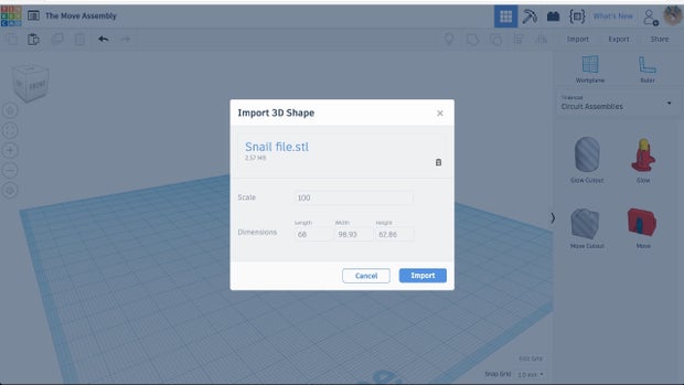

This is another choose your own adventure! Either download and import the snail file I've provided above , OR drag any other shape with a flat bottom from the shape menu onto the workplane. This is the shape that we will be adding the Move Assembly to.
If you choose to work with your own shape, scale it up big enough for the Move Cutout to fit inside, leaving space for an adequate amount of printing material between the cutout and the outside of the shape (at least 3mm). The snail does not need to be resized.

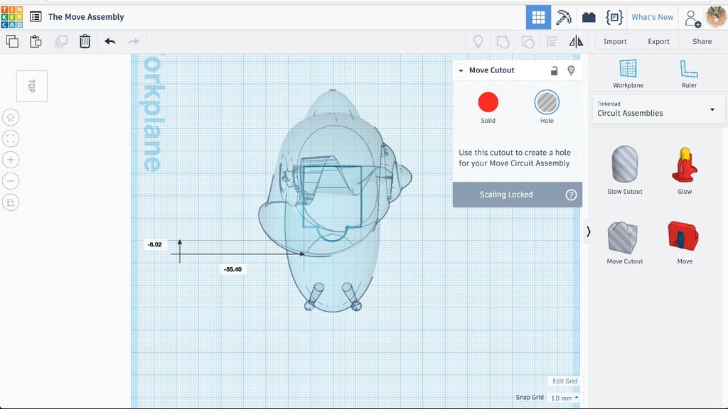

If you're adding the assembly from the bottom like I am, rotate the Move Cutout 90° so that the side with the finger hole add-on is laying flat on the workplane.
If your shape is long and thin like mine, rotate the Move Cutout another 90° on the horizontal surface so that it's longest length is parallel to the length of the shape – in my case, the body of the snail.

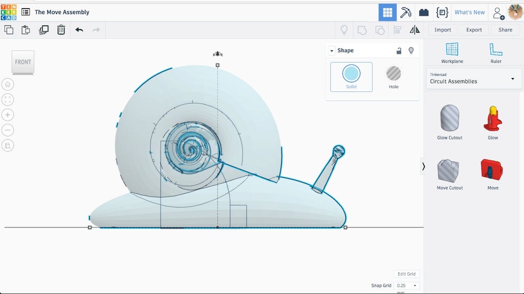

Make your shape transparent by selecting it, clicking on the Solid option, and then clicking on the 'Transparent' box in the lower right hand corner.
Now that you can see inside your shape, move the Move Cutout inside the shape and place it approximately where you want the Move holder to go.
Check the bottom and side views to confirm that the Move Cutout is where you want it, and that it isn't sticking out of any of the shape walls.
Make your shape a visible solid again by unchecking the 'Transparent' box. Double check from all views that the Move Cutout is placed correctly.
Click and drag your curser over the shape and the Move Cutout within to select both shapes. Click on the GROUP icon in the upper right hand corner of the workplane to remove the cutout shape from the main shape.
You should now have a hole the shape of the Move Cutout inside your shape/design.

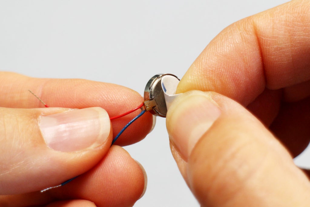

STICK ON THE TINY MOTOR
The tiny vibration motor goes on the Move module's upright 'wall' in the recessed circle.
Peel off the motor's self-adhesive paper backing.
Place the motor in the recessed circle and press down to secure it.

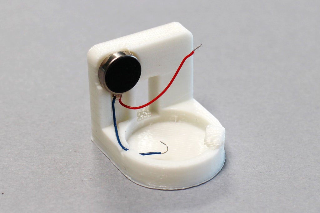

Pull the red wire out of the way, to the right.
POSITION THE BLUE WIRE
Place the blue wire into the thin channel on the left side of the base.
Direct the end of the wire into the center of the module.
As a finishing touch, I like to bend the stripped wire end upwards. It's this wire end that will make the connection with the NEGATIVE (-) side of the coin battery and this upwards bend ensures good contact.

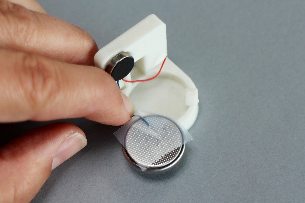

TROUBLESHOOTING A LOOSE BATTERY
Due to differences in printer resolution, there's a chance you may end up with a slightly 'loose' battery – meaning it moves around within the holder when you shake the module side-to-side. If this is the case for you, the looseness could compromise the contact between the battery and the stripped blue wire end.
There is a super easy fix for this! Use a small square of scotch tape to tape the stripped blue wire end to the center of the bottom NEGATIVE (-) side of the battery.
Like this! Then slide it back into place in the holder, POSITIVE (+) side up. This should fix any possible contact issues.
