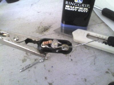

Step 2: Pry Open Battery Clip
pry open and remove both wires including the metal tabs that held them
Step 3: Drill Hole in the Middle of the Top Half of the Battery Clip
Step 4: Solder the Resistor to Positive Terminal of the Battery Clip Like Shown in the Photo
Step 5: Solder on LED
Note: solder the positive lead of the LED to the resistor (the LED and resistor leads have to be cut off as short as possible to save space as there isnt much left in the battery clip) and bend the negative lead out in the direction of the opening where the wires used to go out of. DO NOT CUT THE NEGATIVE LEAD OFF.
Step 6: Test the Circuit
Test the circuit by pushing the battery clip onto the 9V battery and pushing the negative lead of the LED onto the negative terminal of the battery.
You may also want to strengthen the negative lead of the LED so that the wire doesnt change shape when you push it, otherwise the switch will deform and stop working
Step 7: Close the Battery Clip If It Works
If the LED glows when you tested the circuit you are ready for closing the batery clip. It might take some squeezing to get it all in the right place and snapped shut.
Note: the negative lead of the LED has to be threaded through the hole in the top half of the battery clip before closing it
Step 8: Make the Blob Button
Cut the wires extending out of the battery clip to about 7mm. Put a blob of hot glue on it. Once the hot glue has hardened colour it in with black vivid. Theres the dandy light finished
Step 9: Finished Product
Heres the finished light. smaller than the one you can buy. I think it would be possible to use two LED's to make it brighter, or use a larger LED (5mm). I believe the light should last about 8hrs or more. after all the LED only draws 20mA of current which will take a long time to drain the battery.
