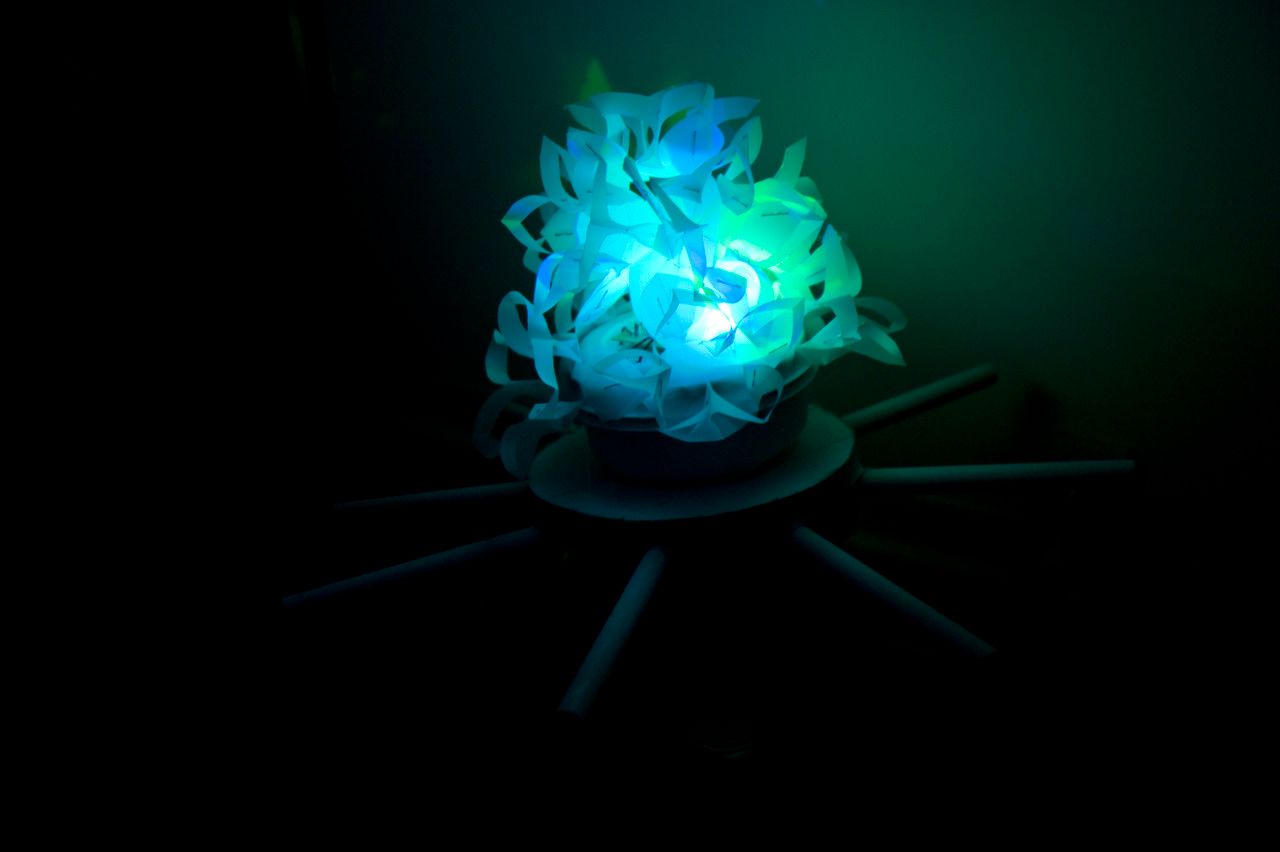

pHloat is a DIY kit that is made for use in conjunction with a pre-owned / pre-existing arduino microcontroller. Its purpose is to test the pH levels in local rivers, lakes, and streams due to the influx of air and water pollution often caused by acid rain. It is specifically designed to be used in areas that are home to refineries, chemical plants, and manufacturing industries that are causing environmental damage. However, it can be used in any body of water to test acidity levels.
pHloat has the option to be made from several recycled materials including but not limited to, styrofoam, paper, and plastic food containers. If these materials cannot be found they can be purchased along with the necessary electrical components for approximately $25. pHloat functions through the modification of a simple garden moisture and pH sensor that can be purchased at any home improvement store. It acts as both an environmental measurement tool and a floating sculpture, borrowing inspiration from Japanese floating paper. As the pHloat navigates down a stream it is taking a constant pH reading that is being translated by the arduino to produce a variation of colored light (produced by a low energy and cost superbright RGB LED). The different colors of light indicate the level of acidity in the body of water. For example, a normal pH reading would result in the emission of green light while a high pH reading would result in the emission of red light. Blue light emission indicates a semi-acidic body of water. The lights are housed on the top of the pHloat and are illuminated under a paper origami shade. As to not further contribute to environmental pollution, a rope (not pictured in the 3d models) should be attached to each pHloat so it can easily be retrieved from the water (this allows for the pHloats to also be affixed to a particular area measuring passing water).

22. Download the following code to your arduino microcontroller. After you download the code the light on the board should turn green. When the pHloat detects moderately high acidity levels in water the light will turn blue. When the pHloat turns red it has detected dangerously acidic. This code should achieve these results.

While you are making the shade I suggest unplugging your battery from your arduino, It is simply just draining power at this point. Do not replug in the battery until you are almost ready to use your pHloat.
Step 12: Finishing the Shade and Attaching It
This is not recommended to be used in the rain because the electronics exposed underneath the lid could become damaged. If you make a water right top, it would be suitable for any weather conditions.
