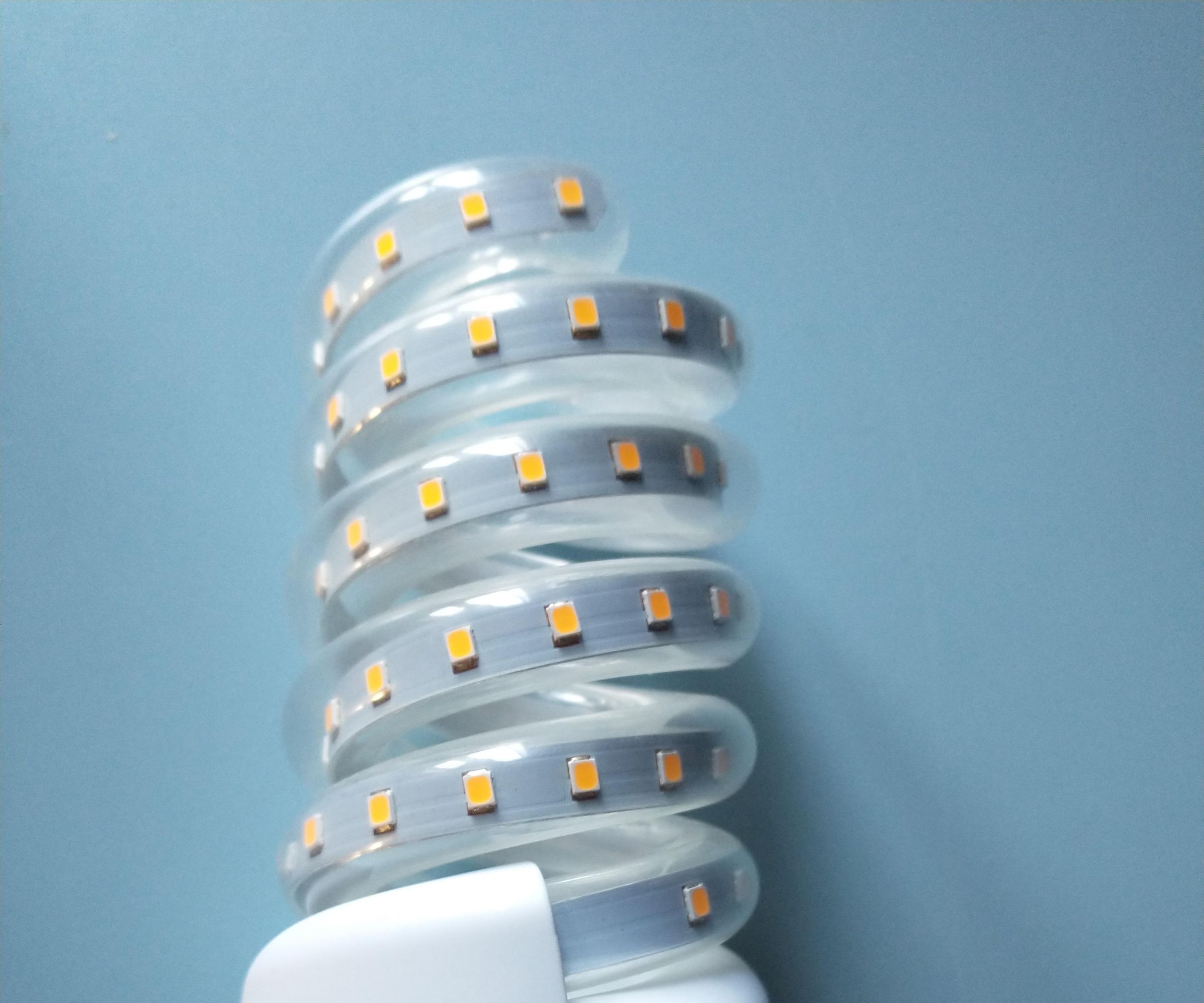

Recently I decided to check the reason for the failure of an old outdoor LED lamp that I had set aside.
As I expected, the AC/DC power supply was faulty and, being sealed, not repairable. The data printed on the power supply module indicated that it was a converter from 100-230Vac to 30÷34Vdc at constant current 600mA. This is consistent with the specifications of the lamp that I remembered being 18W.
To provide stable brightness LED lamps need a constant current power supply. In fact, due to the NTC behavior of power LEDs, a fixed voltage source would provide an increasing current up to a potential breaking threshold. Therefore, to test if the LED assembly was still ok, I powered it with my benchtop power supply by setting the max current to about 700mA and then slowly increasing the voltage from 0V until an absorption of 600mA was reached. The lamp was at maximum brightness and the voltage at its heads 31V. After few minutes the current was increasing and I had to reduce the voltage to keep the current at the nominal value of 600mA, confirming the reduction of the load resistance.
Instead of looking for a spare power supply on the market, I decided to build one with cheap and easy-to-find (and probably already available to you) components. With the occasion, I made the lamp "smart", with the possibility of dimming it remotely via Wi-Fi
