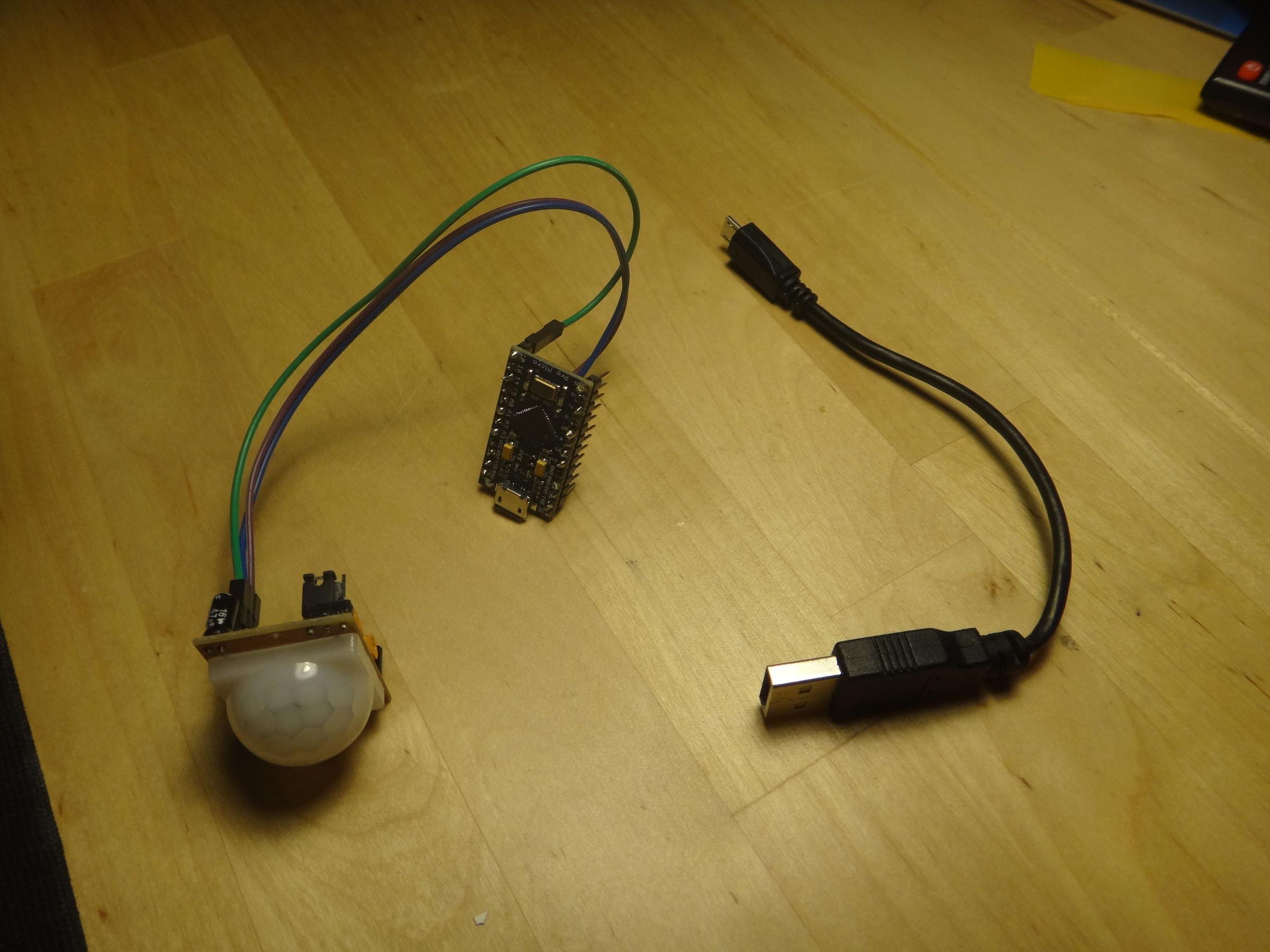

- Sparkfun Arduino pro micro(mega32u4 which support keyboard library) as receiver
- Arduino pro mini (mega328p) as transmitter
- PIR sensor
- RF 315 transmitter-receiver module
- USB cable
- Jumper wires
- computer or laptop (only support Windows OS)
The parts for this project should be ~100RMB. All the parts should be easily to find in Taobao in China or somewhere from US.

transmitter
PIR sensor:
- VCC >>> VCC in Arduino
- GND >>> GND in Arduino
- OUT >>> D7 in Arduino
RF 315 transmitter:
- ATAD >>> D9 in Arduino
Arduino
- VIN >>> VCC of 9v battery
- GND >>> GND of 9v battery
receiver
receiver is simpler, you just need wire the Arduino Sparkfun Pro Micro to the RF 315 receiver
- DATA (the PIN next to the VCC) >>> PIN 9 in Arduino
