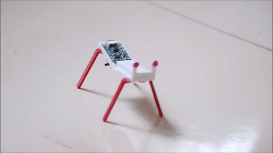

Step 3: Building Circuit
The circuit is pretty much straightforward for this project.
The charging board has terminals for battery connections and to these, we are directly soldering the battery, Wires of battery were cut to the required length before soldering so as to utilize the most of spaces.
Now at the base of the body i have given slots, These slots are for connecting the wires of the vibration motor to the charging board.
The other terminal of motor is connected to the board via a mini switch, the soldering part is a little complex if you are a beginner into soldering, if you have prior experience this step is very simple.
After all the components are soldered i secured everything with hot glue, make sure you are not leaving any loose hanging parts which may cause problem when the robot is working

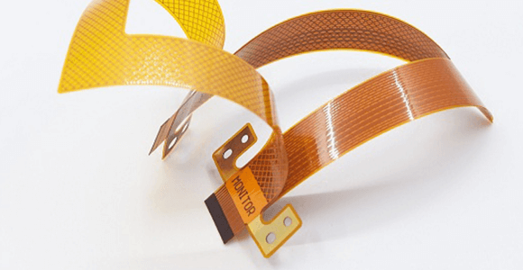

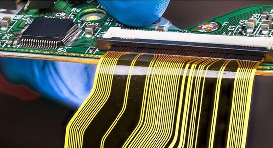

Check Here for Rigid-flex Pcbs with this your circuit becomes flexible! I have added the images to this step kindly check.
A revolutionary solution that combines the best of both rigid and flexible circuitry to elevate your electronic projects to new heights.
With their expertise in advanced manufacturing techniques, they offer a seamless integration of rigid and flexible components, ensuring enhanced reliability, durability, and space-saving benefits

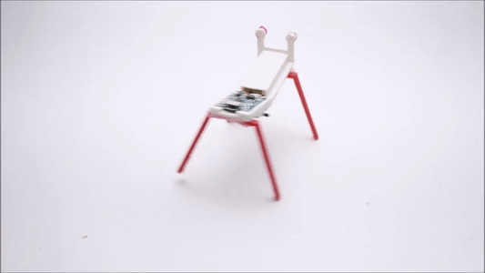

Step 4: Adding Legs
Legs are the part that help move this robot here and there, The method of adding 3d printed legs to the robot is very easy.
I marked down the areas where this will be glued, In the first place add a drop of superlue and couple it to the body of this robot.
Now when the glue is dry completely add drops of hot glue to the same place and wait for dry.
This gives the strength to withstand vibrations from the vibrating motor, check for any loose parts, and if any secure them with hot glue.
Step 5: Finishing
We are about to finish this project, to give it an extra layer of finishing i will add a head with eyes!
Though you cannot expect it to be like real eyes this somewhat resembles the eye of a robot, i added a small circle that was cut from paper to make the eyes highlight.
Use superglue later add an extra layer of strength with hot glue and this finishes the building of this project.
To test this project all you have to do is power on the button and place it on the ground.
The robot hovers from place A to place B in no time and looking at the working of this robot is satisfying.
