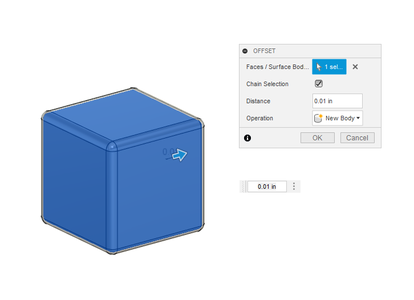

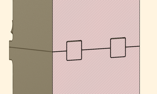

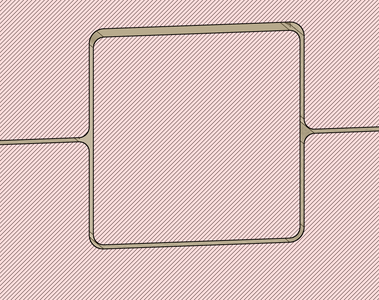

FDM or FFF 3D printers (filament printers) build parts from the ground up. It's essentially a fancy hot glue gun controlled by stepper motors. This means anything that is above the print bed (this is referred to as overhangs) that is "floating" or doesn't have anything underneath it will require support material to print successfully. Your slicer (a program that takes your 3D model and "slices" it into a tool path and layers that the 3D printer can read) can automatically create breakaway supports based on parameters you select. Typically, supports leave a less than desirable finish that takes a little extra cleanup than normal, so it's best to avoid them if possible. The highest resolution finish is typically the top layers, so if you have a double sided object with a lot of detail, the best way to get those details to pop is to split the object in half so you can print it with those sides face up.
FDM printers work by taking a filament (such as PLA or PETG) and pushing it through an extruder at a high temperature. There is some shrinkage involved in the process. If you have two parts that interlock, you need to model in a tolerance to allow for that shrinkage, otherwise you'll end up having to sand to get to joints to fit together. Depending on your material and printer this can vary. Fortunately I've found that 0.2mm or 0.008" generally works well with PLA and PETG. You may have read and re-read those numbers a couple times and thought to yourself, "Brian (that's my name by the way), HOW could that small of a dimension possibly make a difference? That's a rounding error! That's the fraction they tried to use in Office Space to skim money from their company!!" I know, I know, it sounds crazy but believe me, it makes a big difference. If you're modeling in inches, 0.01" is an easier number to type and gives you a little extra wiggle room anyway. The first numbers I mentioned are usually what I refer to as "snap fit" tolerances, meaning it's still snug but snaps snugly together. 0.01" is what I typically use since I glue everything together anyway. There are two images showing an example of this, the first one is using the "offset" tool in the surface modeling workspace. The second is the "stitch" tool to convert the mesh into a solid. You then have a tool to cut the offsets out of the adjacent parts.
If you read the last couple tips and wondered to yourself, "How do I make sure all of my parts fit together without having to hold my breath while gluing things together?" Keys are the key! Registry keys, to be more specific! Depending on the part and how many pieces there are, I usually make a couple different sizes or shapes of keys per project that are the same size. That way when I 3D print the keys I have a number I need to print instead of having to manage individual keys for each part. See the photos above. Another word that could be used is a "pin." Typically I do cylinders or cubes to help align and strengthen the connection between parts. See images above for a reference to what I mean. Each connection point (or face) has a recess that the key slots into on part A and part B. This also allows you to print flat on the bed, instead of having the keys built in, which would raise the print off the print bed, making you use supports.
