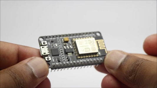

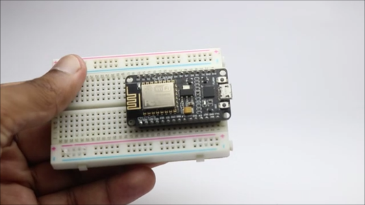

Nodemcu

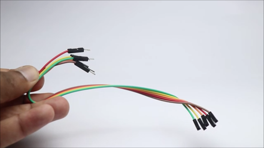

Jumper wires

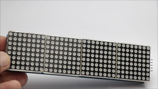

LCD display matrix module
Small breadboard

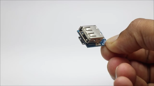

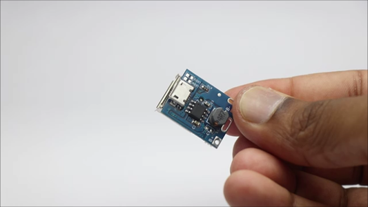

USB charging module

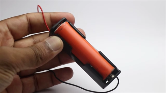

Lithium-ion battery and holder

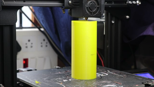

Step 2: 3D Printing

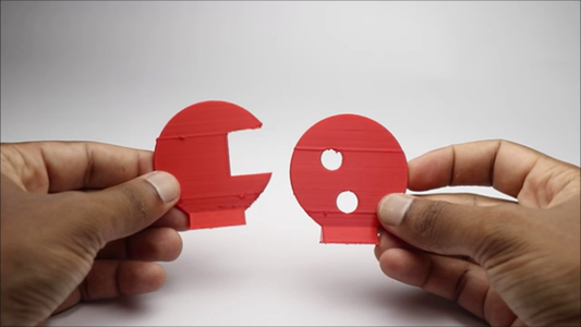

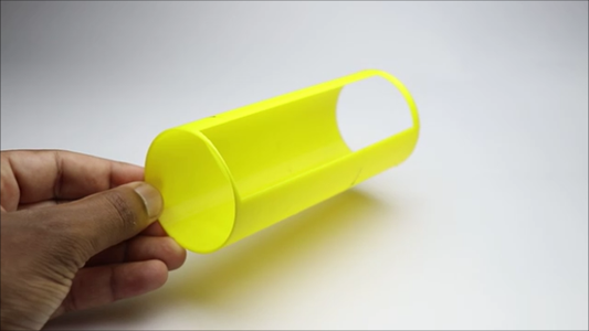

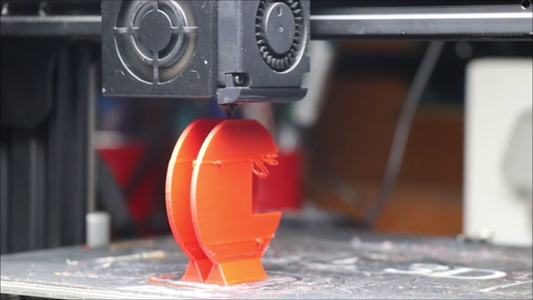

There are 3 parts in total and i printed body as a whole while the side slots were printed together.
I will be using PLA filament to print the parts and the color of the filament is left to you, in my case color combinations like yellow and red or white and black would do the job.
After the print process is over if you have any minor surface issues clean it with emery paper, in my case everything was fine.

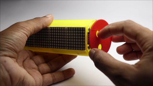

This completes the casing or covering part for the clock now let us head over to the electronics and program part for this clock.

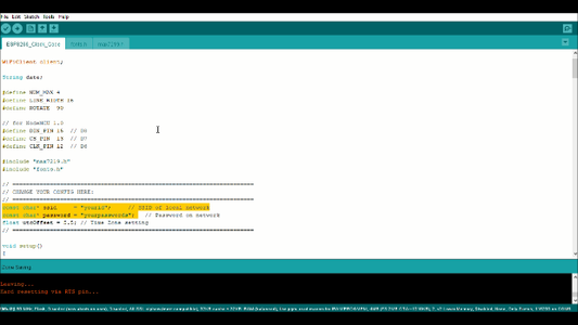

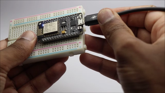

Before building the circuit upload the program to the nodemcu board, all you have to do is copy and paste the below program on IDE
Replace the wifi id and logins with yours, select the proper type of board and hit on that upload button, After the code is done uploading we can disconnect the USB and carry on with the next steps..
There are 2 files with .h names create a folder inside your ide and paste the code and save and upload.

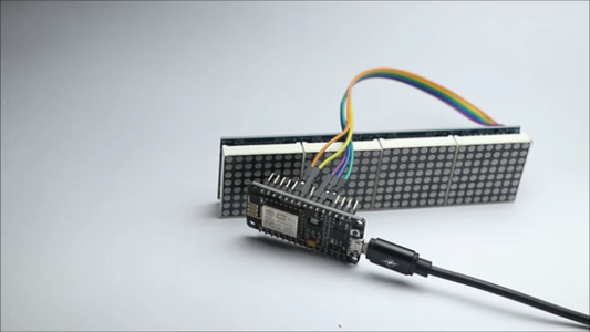

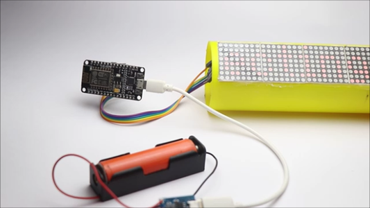

The circuit diagram is very straightforward here, We have only one component that needs to be connected to the nodemcu board.

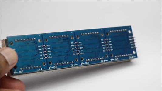

The LCD matrix display has 4 pins, Clk, Cs, Din, Gnd and Vcc
Gnd and Vcc are connected to the ground and 3v pins of the nodemcu board.
Clk to D6
Cs to D7
Din to D8

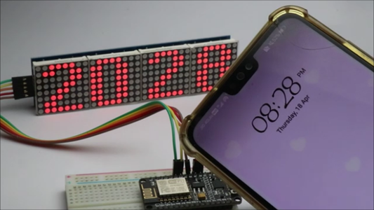

After these connections are complete using the jumper wires we can test the project, all you have to do is connect the nodemcu board to the USB power supply, In my case i connected this to the computer.
Step 4: Testing

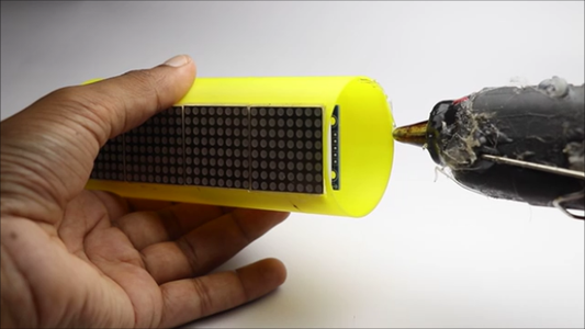

Before casing all the electronics inside the case make sure to connect all the component and check if everything is fine.
This is because in case if anything does not work after we have done all the placing inside the 3d printed case it adds another level of complexity to dismantle again.
Simply sort this issue by connecting the electronics together, after everything looks fine couple all the 3d printed parts.
Use hot glue wherever necessary and ensure there are no hanging parts, Since this is now complete we can head over to test this project.

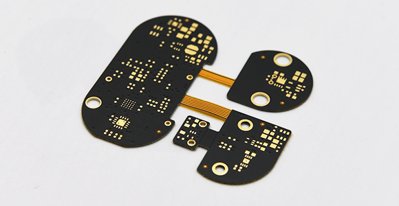

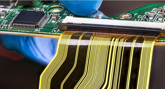

Check Here for Rigid-flex Pcbs with this your circuit becomes flexible! I have added the images to this step kindly check.
A revolutionary solution that combines the best of both rigid and flexible circuitry to elevate your electronic projects to new heights.
With their expertise in advanced manufacturing techniques, they offer a seamless integration of rigid and flexible components, ensuring enhanced reliability, durability, and space-saving benefits

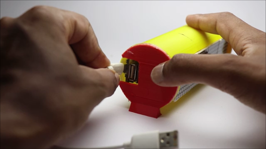

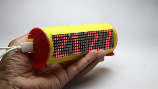

There is nothing much in this step, If your battery is low on charge keep the battery for charging usually it takes 2 hours for a full charge, and disconnect the cable from the charging port.

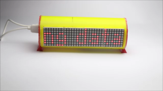

Now connect the cable to the nodemcu board, You will now see a connecting message on the matrix display.

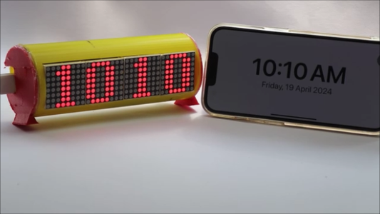

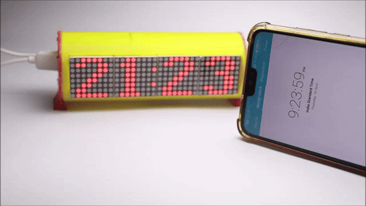

Wait for 10 seconds and the board will automatically be connected to Wi-Fi and it will start to show the time followed by a sliding animation of the day and month.
The things are fully customizable and you can alter them as per your taste.
