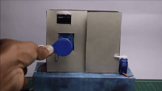

Step 3: Body Structure
To build the body and to make it look a lot like a bookshelf I will use a rectangular box that I recycled from a sunglass cover as a base and to the top I had a square shaped box and that will be the perfect option to make it look like a door with shelves.
There will be a single door open and close mechanism here and another door will be equipped with electronics like RFID board and OLED board.
After the work of this single side is complete just glue it to the frame of the box and make sure to take servo along with this.
Use a decent amount of hot glue wherever necessary and fix this door, after this is done we can head over to adding the moving door.
Here the trick is we are using half servo horn and pasting the door directly to it and pasting the servo to one corner.
You can keep the circuit in on when you are doing this step because you need to know the exact position of the servo horn, allow the glue to dry completely and now you can decorate the inside part with some slabs of cardboard.
After this is complete we can head over to testing this project.
Step 4: Finishing
The testing of this project is very interesting that is because we finally get to implement the project in real life cases.
To use this all you have to do is keep the book on the shelf first! Power on the project and wait for the display module to show the message to tap the card on the reader.
Now tap the card with no access first and you should be able to see the invalid card message with the id of the tag below.
When you tap on the RFID tag with access the servo opens and in return the door opens too, Now you can have access to the books inside.
