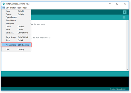

#️⃣ To add the Sony Spresense board package to the Arduino IDE, navigate to File ➡ Preferences and paste the URL below under Additional Boards Manager URLs.
#️⃣ This package also includes the required libraries for the extension board modules (such as the SD card module) and the camera board.
https://github.com/sonydevworld/spresense-arduino-compatible/releases/download/generic/package_spresense_index.json

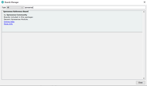

#️⃣ Then, to install the required core, navigate to Tools ➡ Board ➡ Boards Manager and search for Spresense.
#️⃣ After installing the core, navigate to Tools → Board → Spresense Boards and select Spresense.

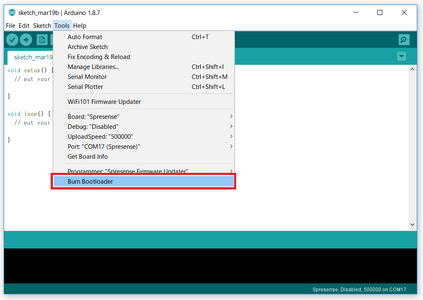

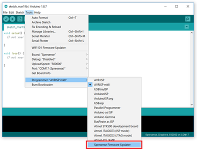

#️⃣ To update the Spresense firmware so as to use the latest version of the Spresense Arduino libraries, go to Tools → Programmer → Spresense Firmware Updater. Then, select Burn Bootloader.

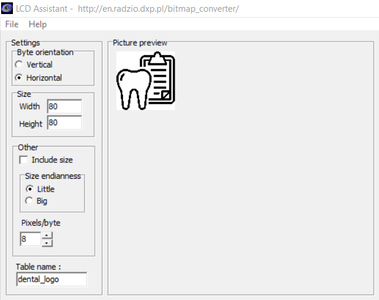

#️⃣ Then, install and run the LCD Assistant.
#️⃣ Upload the monochromatic bitmap and select Horizontal in the Byte orientation section under Settings.
#️⃣ If necessary, change the image width because the LCD Assistant and the thermal printer handle images in horizontal groups of eight pixels. Therefore, if the image width is not a multiple of eight, it is truncated (cropped) to the nearest smaller 8-pixel boundary.
#️⃣ Convert the image (bitmap) and save the output (data array).
#️⃣ Finally, add the data array to the code and print it via the thermal printer.

⭐ Include graphics (color bitmaps) for the ILI9341 TFT LCD touch screen.
⭐ Include icons for the tiny (embedded) thermal printer.

      tft.drawRGBBitmap(10, c_y+r_y+10, (uint16_t*)(dental.pixel_data), (int16_t)dental.width, (int16_t)dental.height);
