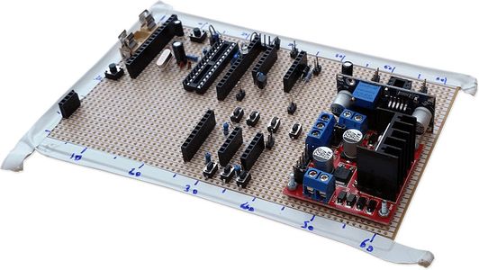

Modular design on vero board add/remove features as required
Includes various pulse outputs for driving/synchronising other clocks/circuit
Detail
This clock circuit uses an Atmega 328 microprocessor to drive Pragotron type clock movements from a 5 volt supply. The Arduino Code is based on my Master Clock code and has been completely re-written for Udo Klein's V3 library by Peter Hillyer. Peter has added code for a 2.2" TFT SPI display and sound via a JQ6500 sound module controlled over the serial port.
It should also be able to drive other clock movements that require a 1 minute alternating pulse to drive them. Pragotron movements have different drive voltages so a step up voltage module is used to set the correct voltage for the movement in use.
A DCF77 receiver module is used to synchronize time to the "Atomic" Clock in Germany and clock functions and controls are monitored on a 2.2" TFT display.
The circuit is built onto Vero Board and can be located remote from the clock movement that is being driven. An off the shelf Arduino Uno can be used but will required a 16MHz quartz crystal added in place of it's built in 16MHz resonator. Other Arduino boards can also be used but must use a quartz crystal for the microprocessor timings as this clock design uses Udo Klein's DCF77 library. See details here UNO Mod
Switches are mounted on the Vero Board to start Auto summer advance and also winter retard. Full Westminster Chimes including volume are controlled by the Arduino and played through a JQ6500 sound module and chimes can be set to On, Off and timed. Battery backup is provided by 3 x 1.5v Alkaline batteries and will keep the clock running without chimes during power cuts. This circuit also includes a DCF77 "repeater" and "multiplier" circuit and can provide DCF77 pulses at 5volts to other clocks. This and the Westminster chimes cam be omitted if not required. Full details can be found in the sections below.

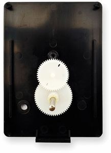

Step 2: Re-fitting Original Pragotron Movement
Pragotron PS100 Movement Case Details
The PS100 movement case measures 60mm x 80mm x 20mm the terminals at the bottom of the movement are 10mm long and the minute shaft protrudes around 15mm from the face of the case. The hand adjuster a further 5mm from the back of the movement.

Fitting Pragotron movement
Pragotron movements are fixed to the dial by 3 bolts in a downward pointing triangle like the Pragotron logo around the minute/hour shaft (picture 3). My original bolts had been destroyed by the shop when converting it to quartz drive.
I found that M3 bolts fitted the tapped plastic case threads. I cut them to size just enough to go through the dial and movement case without interfering with the movement inside.

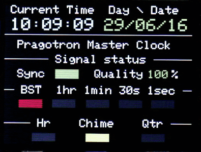

Step 6: TFT Display
TFT Module
Picture 1 shows the full range of information on the display over a minute.
Picture 2 shows the front of the display module
Picture 3 shows the rear of the module.
The 2.2" LCD in the TFT01 is a IL19341 and has a 240 * 320 resolution.
Pins
SDO: Serial clock output
LED: 3.4V Power Supply pin
SCL: Serial clock input
SDA / SDI: Serial data input
DC: Data / Command selection
RST: Reset, Low level active
CS: Chip Selection, Low level active
GND: Ground
VDD33: 3.3V Power Supply pin
A level converter is used between the Arduino and some of the TFT display pins as they require 3.3v. See schematic for details.
The display is split into 5 sections.
The first shows the current decoded time and date from the DCF77 transmitter
The 2nd row shows the following information: Makers name and S/W version Time first synchronised. This will show you the length of time the clock has been running.
Quartz accuracy and Quartz frequency. The quartz crystal is only used when the DCF77 signal is lost and while the clock is in sync the quartz crystal in continuously "tuned" to the highly accurate DF77 signal. This row will show the actual "tuned" frequency of the quartz crystal along with the accuracy in Htz with 1Htz being the best.
Seconds lost or gained. This will show the number of times the clock has been out of sync with the DCF77 clock and auto corrected for more and less than 1 second. This is useful if the clock is driving 1 second slave clocks as they could be out of sync if the auto correction fails. The auto correction adds or removes a 1 second pulse to maintain sync of the 1 second slaves. You would expect a 1 second loss to be registered for example when a leap second is injected.
The 3rd row shows the DCF77 signal status and quality
The 4th row has the BST (british summer time) indicator and slave pulse output monitor The 5th row is the chime status monitor. Chime is green when chimes are always on, yellow when on timer and off when chimes are off.

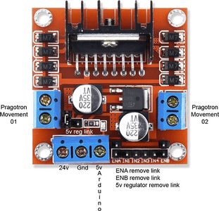

Step 7: H Bridge Module
Dual H Bridge Module
I have connected my clock movement to connection 02.
Important remove link from the onboard regulator as shown as this is not used.
5v is derived from the Arduino power supply to the screw terminal marked "5v Arduino"
Ground is common ground and 24v is the stepped up supply from the step up module
Remove the link from ENA and ENB as the H bridge is enabled from the Arduino.
I have connected ENB to my Arduino as I am using output 2.
Whenever ENB is set to 5v from the Arduino whatever 5v voltage polarity set on IN3 & IN4 pins from the Arduino is sent out at 24v from the H bridge module to step the clock on 1 minute.

Built-in 78M05, get power from drive power, however, when drive power over 12V, please use the external 5v power as power supply.
Large capacity filter capacitance, afterflow protection diode, more stable and reliable.
Specification:
Double H bridge drive Chip: L298N (ST NEW)
Logical voltage: 5V
Drive voltage: 5V-35V
Logical current: 0mA-36mA
Drive current: 2A(MAX single bridge)
Max power: 25W
Size:43 x 43 x 26mm(LxWxH)
Note:
This module has a built-in 5v power supply, when the driving voltage is 7v-35v, this supply is suitable for power supply DO NOT input voltage to +5v supply interface, however leading out 5v for external use is available. When ENA enable IN1 IN2 control OUT1 OUT2 When ENB enable IN3 IN4 control OUT3 OUT4

Picture 1 shows the TFT display counting the advance pulses when the advance button is pressed @ 10:09:23
Note the @ 10:10:00 the advance count stays at 23 and does not count down to 22 as expected. The is because there is a normal minute pulse expected at this time so this pulse is ignored. If this did not happen the clock would be 1 minute slow when the advance completes.
Picture 1 is a video showing the advance in operation on my clock

Picture 1 shows the main board with working TFT display.
Picture 2 shows the actual layout of the board with all modules connected.
Picture 3 shows the board layout without the modules so component location,links and track cuts can be seen.
Picture 4 shows the rear of the board in picture 3 hinged at the bottom and flipped down so the track cuts are more visible.
Construction
Picture 5 shows all components mounted ready for final wiring.
The white temporary labelling strips helps position wires and components and is removed once they are all in place. The modules plug into the installed headers on the board once wiring is complete.
I start by placing the larger components like IC sockets and header strips on the board first. I tack these in place with a bit of solder on the top and bottom connectors. Once I am happy these are correct I cut any tracks between IC sockets then solder them in place along with the headers.
I then work my way around he board adding components and cutting tracks as I go. When soldering a component to the board I hold it in place with plastic tape flip the board over and solder it. This stage is shown in picture 5.
Once all the components have been connected I do the 5v, 3.3v and 0v runs with straps/insulated wires. These should be shown on the board layouts pictures 3 & 4.
To complete the board the wires interconnecting all the modules/components are added using the schematic diagram. I print out the schematic and as each wire is connected I tick it off the schematic to ensure no wires are missed out.
Once the wiring is completed I then "tap" the board out track by track with a multimeter on continuaty setting to check for any short circuits.
Finally the modules can be added to the completed board picture 6.
Picture 7 shows the module names. On my board the 3.3v module is omitted as it gets it's 3.3 volts from another clock in the same housing.
