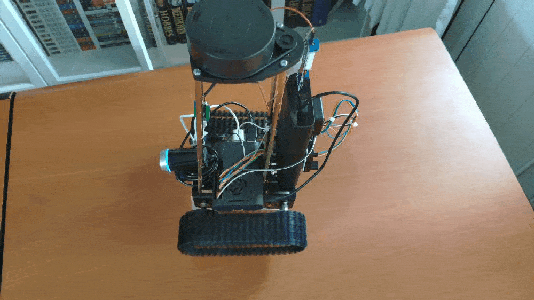

After training the model and running it on Raspberry Pi, I designed and assembled my autonomous litter detection robot with an RPLIDAR A1M8 360 Degree Laser Scanner (Lidar), a robot chassis, and a USB webcam. Then, I built a fall detection system with an Arduino Nano and a 6-axis accelerometer for the robot to forfend it against crashes.

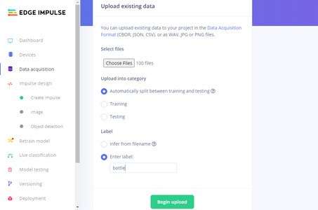

⭐ First of all, sign up to Edge Impulse and create a new project (Litter Detection Robot).
⭐ To be able to utilize the object detection model, go to Dashboard ➡ Project info ➡ Labeling method and select Bounding boxes (object detection).
⭐ Then, go to Data acquisition and select Upload data (Upload existing data).
⭐ Finally, upload images for each litter category to Edge Impulse to create the dataset. It can automatically split them between training and testing sets.

After deploying my model on the Raspberry Pi 4, I connected it and the USB webcam to the robot chassis. Then, I ran the model, and it started to classify between the three litter categories immediately.

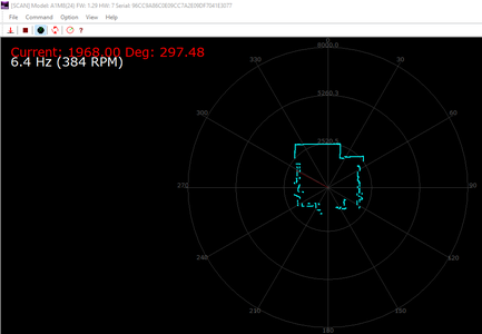

To obtain the 360-degree scan data generated by the RPLIDAR A1M8 with Raspberry Pi, I used the Adafruit CircuitPython RPLIDAR library.
Before collecting data with the library, I connected the RPLIDAR A1M8 to my computer (Windows) and ran the Frame Grabber application to inspect angle directions and distance measurements while it scans the surrounding environment.

        # Control the robot chassis according to the debugged distance values:
        if((r_start < t) and (r_end < t)):
            print("\nStop!")
            self.robot_chassis_controls("stop")
            sleep(0.5)
            print("Right!")
            self.robot_chassis_controls("left", speed="moderate")
            sleep(1)
            print("Go!")
            self.robot_chassis_controls("forward", speed="low")
        if((l_start < t) and (l_end < t)):
            print("\nStop!")
            sleep(0.5)
            print("Left!")
            self.robot_chassis_controls("right", speed="moderate")
            sleep(1)
            print("Go!")
        if((f_start < t) and (f_end < t)):
            print("\nStop!")
            sleep(0.5)
            print("Front!")
            self.robot_chassis_controls("turn", speed="moderate")
            sleep(1)
            print("Go!")

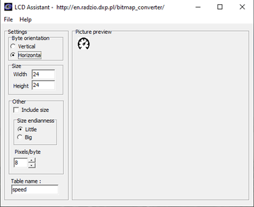

⭐ To display an image with the SSD1306 OLED screen, download the LCD Assistant, upload a monochromatic bitmap, and select Vertical or Horizontal depending on the screen type. Then, convert the monochromatic bitmap to a data array.
⭐ Finally, add the data array to the code and draw it on the screen:
static const unsigned char PROGMEM _speed [] = {
0x00, 0x7E, 0x00, 0x01, 0xFF, 0x80, 0x07, 0xFF, 0xE0, 0x0F, 0x99, 0xF0, 0x1E, 0x18, 0x78, 0x3C,
0x18, 0x3C, 0x3E, 0x00, 0x7C, 0x76, 0x00, 0xEE, 0x72, 0x00, 0x0E, 0x60, 0x01, 0x06, 0xE0, 0x07,
0x07, 0xE0, 0x1E, 0x07, 0xE0, 0x3E, 0x07, 0xF8, 0x26, 0x1F, 0xF8, 0x3C, 0x1F, 0xC0, 0x18, 0x03,
0xE0, 0x00, 0x07, 0x60, 0x00, 0x06, 0x60, 0x00, 0x06, 0x73, 0x00, 0xCE, 0x3E, 0x00, 0x7C, 0x3C,
0x00, 0x7C, 0x1C, 0x00, 0x38, 0x08, 0x00, 0x10,

First of all, I assembled the DFRobot Black Gladiator (Tracked Robot Chassis) and connected an L298N motor driver module to the robot chassis to control its DC motors easily with Raspberry Pi GPIO pins. In my previous project, you can inspect step-by-step instructions to assemble the Black Gladiator.
Then, I connected the RPLIDAR A1M8 360 Degree Laser Scanner (Lidar) and the USB webcam to the Raspberry Pi 4.
By utilizing male-female brass hex PCB spacers (standoffs), I attached the RPLIDAR A1M8 to the robot chassis. Then, I connected the L298N motor driver module to the Raspberry Pi 4 via its GPIO pins.
To supply the Raspberry Pi 4 and the L298N motor driver module, I used a Xiaomi 20000 mAh 3 Pro Type-C Power Bank. I connected a USB buck-boost converter board to the Xiaomi power bank to elicit stable 12V for DC motors of the robot chassis.
To build the fall detection system for the robot, I connected the DFRobot serial 6-axis accelerometer, the SSD1306 OLED screen (128x32), and the buzzer to the Arduino Nano. To supply the Arduino Nano, I connected it to the Raspberry Pi 4:
  • Arduino Nano ➡ Raspberry Pi 4
  • VIN ➡ 5V
  • GND ➡ GND
Finally, I connected the USB webcam to the Raspberry Pi 4 and fastened all components to the robot chassis with a hot glue gun.
