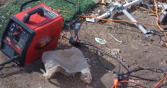

-welder (battery-based will do finely; I used a flux-core, 175-amp setup) and associated safety gears

Join your verticals together at the top of the 'A' as well as with each of your horizontal supports. exact length isn't important on these: just make them big enough to stick out past the verticals on each side of the A enough so you'll have room to store lots of stuff. experiment on some other scrap with power settings on the welder; for me, power of b and feed rate of 4 seemed to work well.
