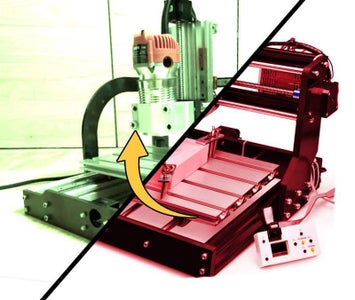

Introduction: CNC3018 Pro - Full Metal Upgrade
As a student of ČVUT University in Prague navigating the world of making, I often found myself limited by the capabilities of my CNC3018 Pro. The promise of milling aluminum seemed elusive with the stock setup, prompting me to seek ways to enhance its functionality. The prize money earned from my successful Nerdy Gurdy project on Instructables became the catalyst for this upgrade.
In this instructable, I'll take you along my journey as I share the process of upgrading the CNC3018 Pro. The objective is to transform it into a sturdy tool capable of precise and efficient aluminum milling. The experiences gained from my previous projects, coupled with the invaluable knowledge shared by the maker community, have empowered me to push the boundaries of what my CNC3018 can achieve. Join me in this exploration of enhancements and modifications that will bring new capabilities to your CNC3018, unlocking the potential for a broader range of machining endeavors.

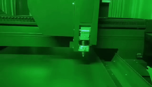

A front plate upgrade involved a complete overhaul of the plastic front and back plate. Recognizing the limitations of the stock linear bearing with rods, I opted for a substantial upgrade to MGN12H linear rails.
The redesigned front plate was made in Fusion 360. I incorporated crew mounting holes for 20x40 aluminum extrusions instead of the ones for linear rods. These extrusions provided a sturdier foundation and it allowed the MGN12H linear rails to be securely fastened, onto extrusions. Furthermore, the front plate serves the additional function of a stop for the linear rails, preventing unintended dislocation. The mentioned 20x40 extrusions were a little longer than in the original CNC 3018, so the machine has a longer reach, 360mm to be exact.
To bring my design into tangible reality, an order from a local CNC laser-cutting company was needed so the original plastic part could be replaced with a steel (S355) one I designed.

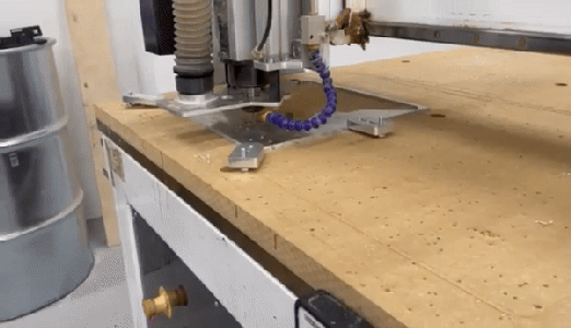

For the spindle component of the CNC3018 upgrade, I explored various spindle options available online. After evaluating the reviews, it became apparent that many commercially available spindle upgrades, made specifically for CNC 3018 pro, were both expensive and lacked satisfactory performance. As an alternative, I opted for a cheap "Woodworking Electric Trimmer 1/4" (bought for $20 inc. shipping) along with an aluminum clamp mount intended for use with the router. However, upon testing, the router proved to be too small for the clamp, even when tightened to the maximum extent. To address this issue, I implemented a quick and pragmatic solution by adding a metal strip as a shim to the clamp. Fun fact, the shim was a can of beans, which has almost the right size and shape (and yes, I cut myself). While this served as a temporary fix, it remains a candidate for future improvements in the ongoing refinement of the CNC3018.
This choice of the "Woodworking Electric Trimmer 1/4" and an aluminum clamp mount was deemed the most cost-effective option with acceptable performance at the time of the upgrade. Looking ahead, future considerations may include exploring alternatives such as a Chinese air-cooled spindle with a 2.2kW rating, like this one, for potentially enhanced performance and reliability. I might even try to mill some softer steels with this future spindle upgrade.
