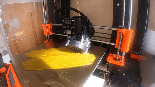

Step 2: 3D Printing Mold
I printed the mold from transparent PETG, I hoped I could see through the mold, where more stuffing of the mache is needed (I could not see anything). The print itself took around 3,5 hours (first try, yay!).

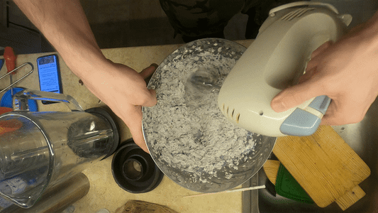

Step 3: Paper Mache
For the paper mache I was inspired by paper mache clay I found on a lovely page named Ultimate paper mache. I tweaked it a little bit, for our needs.
Recipe:
- 1 1/4 cups soaked paper/newspaper (all we could find in our paper bin)
- 1 cup premixed drywall joint compound in a plastic tub (but not DAP brand joint compound)
- 3/4 cup Elmer’s Glue-All or any PVA glue
The soaked papers were mixed smooth in our blender, the rest of the stuff was added later in a bowl. Mixed with a hand mixer

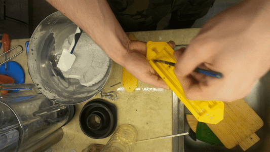

Step 4: Grease the Mold
I used the vegetable oil, to grase the mold, to prevent sticking.
Step 5: Let's Close It!
Close the lid and screw the screws. I recommend doing it in a sink, or somewhere waterproof. Also, I wouldn't use a cordless drill for screws, It might cause plastics to tear.
