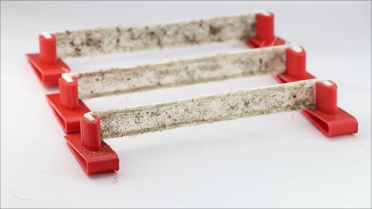

From the last image of this step, you can see the dust collected using this device after it was installed on a fan blade and later checked after a week, Imagine our lungs!

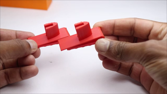

Use the below designs on your slicer, only the frame need supports the other part can be printed directly.

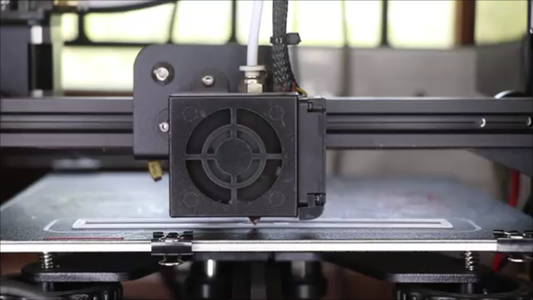

Step 2: 3D Printing

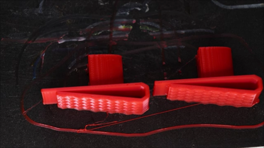

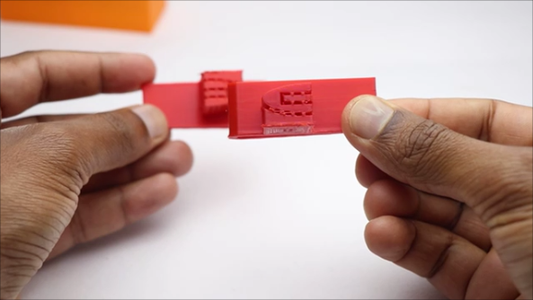

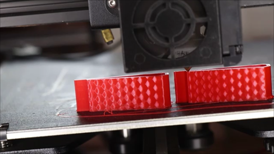

You can use the position of printing that I followed to print the parts which I found most effective.
The Frame/Clipper needs support and you need 6 of those, I printed in a batch of 2, you can print 6 at once too
The cloth holder clip takes less than 30mins to print whereas the batch of 2 clippers took me an hour, I printed all of these on Red and white PLA filaments
I used an ender 3 printer, printing time may vary as per the printer you are using
End of this Step I had 6 clippers and 3 cloth holder clip

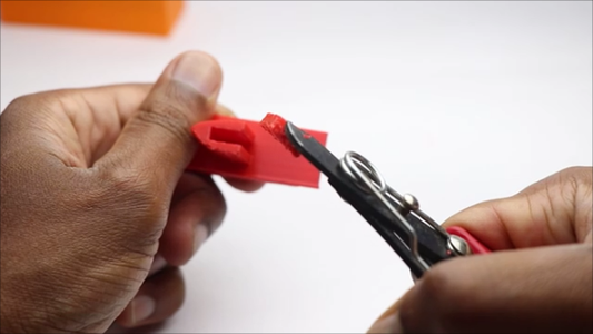

Step 3: Cleaning

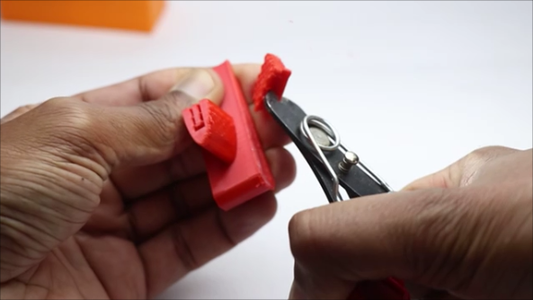

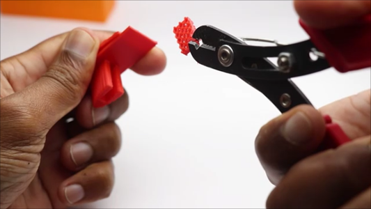

When we use supports we have the task of removing them.
This is a very easy task, all you need to do is pluck the additional supports using a filament cutter.
If you don't have a filament cutter you can use the tip portion of the wire stripper as i did.
Repeat the same procedure for all 6 clippers

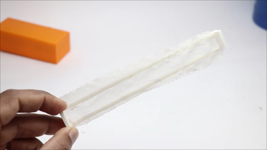

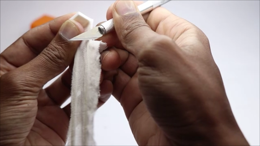

Step 4: Making Cloth Holder Clip

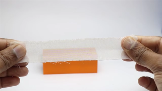

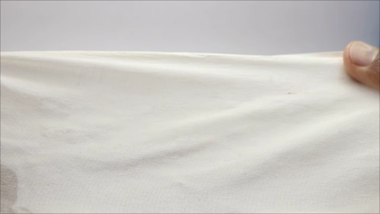

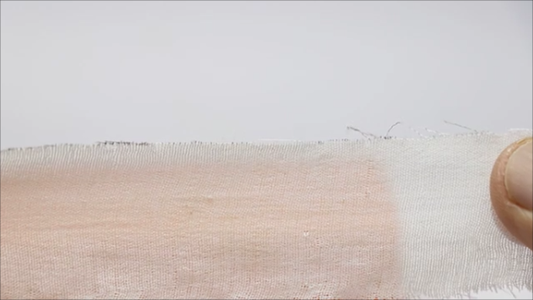

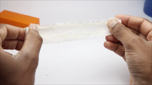

To be more specific about the cloth that I will be using, I have cut a strip of it.
In the second image, I have taken a closeup image so that you can see the spacing on the fabric.
We need this space to trap the dust particles.
The third image shows the orange background with cloth in between again to show the semi-transparent cloth material

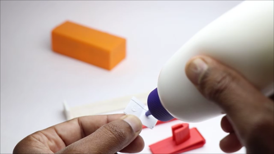

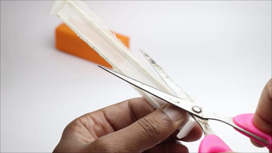

After the cloth is cut into strips apply glue to the frame and just place the cloth over it
Allow some time for drying and finally trim off the excess cloth material using a cutter/scissors

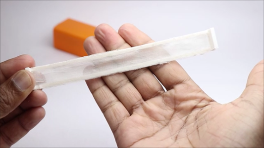

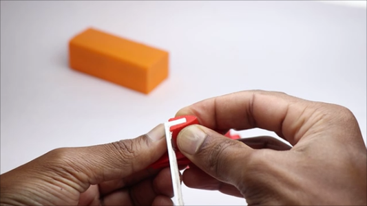

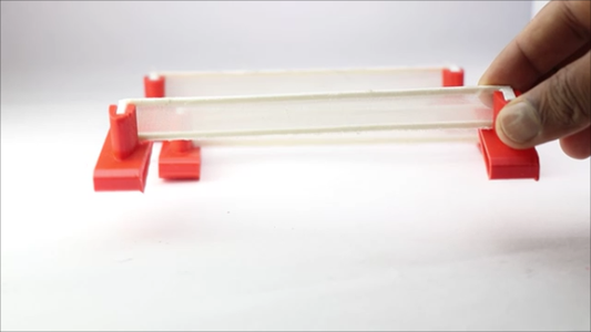

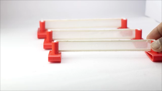

Once we have the finished cloth holder, it is ready to be installed on the blade clippers part.
To make this reusable after the dust collection I have created a minor excess gap between a space that holds both parts.

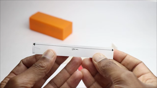

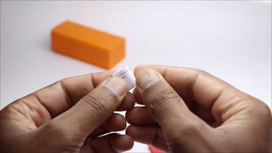

To this part we need to add a paper lock, paper works well and comes with very less complications at the time of disassembly.
I found that a strip of paper with dimensions 1.5cm*10cms works well.
Fold the strip 3 times and add it to the L-shaped space, and insert it into the clipper slot, here you might need to add a drop of paper glue for additional strength.
You might need to add a little extra push, now we have the device ready for use

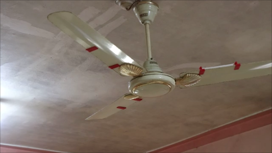

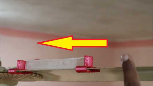

Step 6: Installing

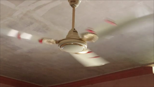

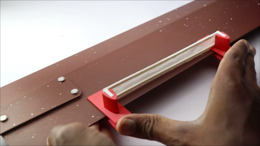

Installing this is very easy, I will be showing you how to add it to the fan blade.
Note that I found it difficult to show you adding these clippers on the ceiling fan that was fit to the roof (no sufficient gears/helpers to shoot video in the ceiling!) so showing a demo using a spare fan blade

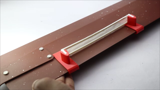

Make sure to check the direction of rotation of the fan blade, in my case counter-clockwise direction.
As per that factor, I am installing this as shown in the first image of this step, Just open the clipper and make it sit on the blade, do it for the other one
After you have both the clips on the blade, gently push the clippers in as I said earlier my blade design fitted perfectly with the clipper and there was no need for me to use any additional adhesives
After you add this to all the 3 blades, you can use the ceiling fan as usual.

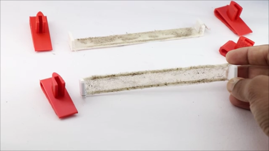

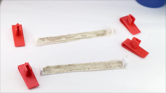

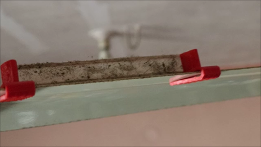

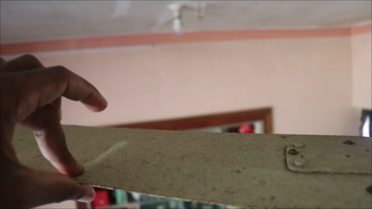

After a week I checked the fan blades, not much dust was accumulated in the blades but to my surprise, the dust holders/ cloth holder collected a surprising amount of dust.
I unclipped them from the blades slowly.
As you can see from the images on this step the dust particles.
Suggestion: If your place is dusty you might need to check this every 2 days because if the cloth is completely blocked with dust the air won't flow through the cloth.
The reason for using paper on the cloth holder was to easily unclip when we want to add a new cloth.
You can reuse these clippers and cloth holders after you add a new cloth as I think washing would enlarge the pores of existing cloth attached to the holder
