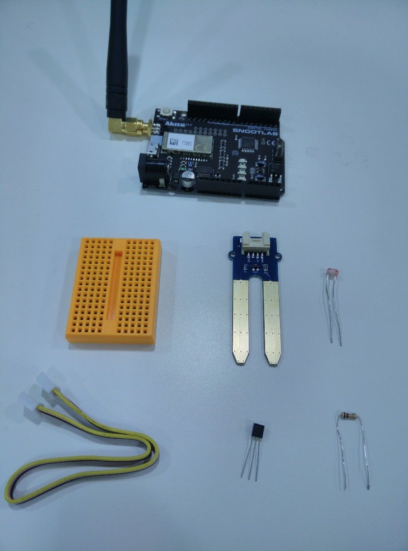

Step 1: Hardware Requirements (+ Thethings.iO)
For accomplishing this project, we're gonna need:
  • An Akeru board (It has the same pinout as an Arduino Uno + Sigfox modem).
  • A Micro-usb cable (To connect the akeru with the computer).
  • A Light Diode Resistor.
  • An Lm35dz Temperature Sensor.
  • A 10 kOhm Resistor.
  • A Moisture Sensor (In our case from Seedstudio).
  • A bunch of 0.1" male-to-male cables (For connecting our Akeru with the sensors).

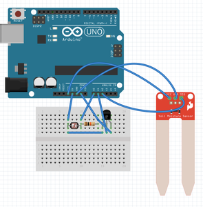

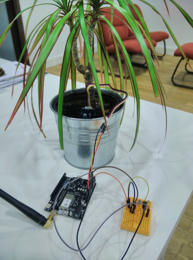

Step 2: Sensor Connections
This is the resulting connections diagram: (An Arduino uno is displayed instead of an Akeru, because the Akeru board wasn't available on Fritzing).
  • The Light Diode Resitor is connected to 5v, GND (via a 10 KOhm resistor in series) and the A0 pin.
  • The Temperature Sensor is connected to 5v, GND and the A1 pin.
  • The Moisture Sensor is connected to 3.3v, GND and the A2 pin.

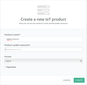

In order to receive the data from Sigfox, you’ll need to redirect all the messages using a callback from our Sigfox profile. You’ll need to configure our thethings.io profile for this:
  1. Navigate to Things Manager
  2. Create a new IoT product: Insert your product name. Then choose a name for each resource you’re going to use. Finally choose Sigfox inside Format.
  3. Click on Details on the product you’ve just created. then copy the clipboard the Subscription URL.
    1. In order to have resources, we need to have a thing token.
    2. Click on get activation codes and select one code. Now you’ll be able to create widgets.

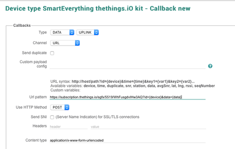

  4. Navigate to the previous Sigfox URL and go to Device. Inside, click on your device type and navigate to Callbacks.
  5. Click New default callback.
  6. Choose the following configuration:
    1. Type: DATA UP-LINK.
    2. Channel: URL.
    3. Url pattern: Paste your previous subscription URL from thethings.iO.
    4. Use HTTP method: POST and click Ok.

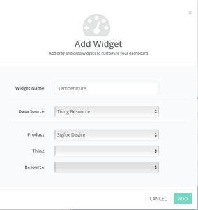

Step 6: Creating the Dashboard Widgets
It’s time to create a dashboard with thethings.iO to show all the values of your sensors!
  1. Click on Add widget.
  2. Introduce a name for the widget.
  3. Select Thing Resource.
  4. Select Sigfox.
  5. Select your thing Token.
  6. Select the resource that you want to show.
  7. Select how you want to show your resource (Lines, bars, log…).
Repeat this process until you finish your awesome IoT Dashboard!
