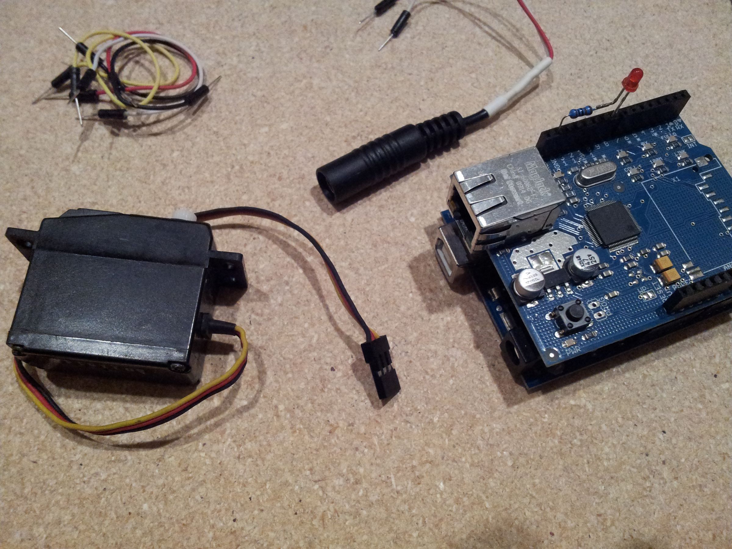

Step 1: Prepare an LED
Parts needed:
- An LED (we decided to use a 10mm white LED because they look neat)
- A 1K Resistor (or similar)
- Some hookup wire (we chose to use some single strand ethernet cable because it's cheap, and connects well to the Arduino pin sockets)
- Some heatshrink (optional, but makes it look nice and tidy)
Steps:
- Take the LED and shorten the lead on the flat-edge side (the shortest lead).
- Shorten one of the leads on the resistor.
- Solder the short lead of the resistor to the short lead of the LED.
- Shorten the other lead on the resistor so that it's the same length as the remainder lead on the LED.
- Solder the hookup wire to the two leads, and apply heatshrink. Take note of which lead is soldered to the resistor (we chose the white wire for this).
- Strip the other end of the hookup wires and connect to the Arduino. The white wire (the wire connected to the resistor) connects to a GND pin, and the other (our green wire) connects to a digital pin (we chose pin 3 because it also supports PWM).
