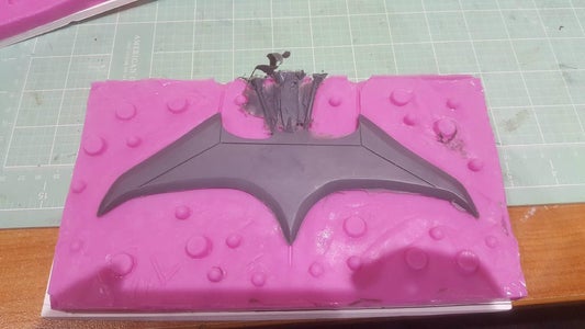

Surround the model with some clay like the picture above, and using a blade carefully make the edges where the model meets the clay horizontal , as this will stop the resin from seaping out at the seams or making a bad seam line you will have to clean up later. Once thats done, you need to create some registration keys in the clay, this is so the 2 halves of the silicone mold can lock in together and the final cast is all lined up properly. Just take the end of a pencil/pen/exacto handle and press in a dozen or so holes across the clay, make sure they are not too deep (mine were probably 1cm on average). We also need to make some surrounding walls so the silicone stays put, just cut out 4 lengths of the foam core, stick them into the clay into a rectangle and seal up the corners with tape. Finally we need some vents for excess resin and an entry spout to pour in, I used some scrap craft wood as the pour in spout between the 'ears', and added some vents at the wing and ear tips so air bubbles wouldn't get trapped.
Now to actually make a mold. Silicone is usually packaged into 2 parts, A and B. PinkySil is a bright pink for A and a white for B, and when mixed in equal volume it turns to a pale pink colour which has about a 5 minute working time. Mix up a small batch of whatever silicone you have and make a detail coat of the whole surface, which should stop any bubbles on the surface of the model (which can ruin/cause more work on every cast), and once that cures make a larger batch and pour that in. Let that sit until it sets, and flip the whole think over while removing the walls. Carefully remove the clay and clean off any that is stuck to the model, and apply a release agent to all of the silicone to stop it from sticking to itself. I smeared petroleum jelly across the silicone, but a spray agent would have been easier.
Once that's done, do the same again, a small detail coat followed by a larger layer and let it cure. Once that sets you can carefully peel it apart and take out the original model and there you go, a ready to use 2-part mold. Take something solid like foam core, cut that out to the rectangular shape of the mold and use some rubber bands or clamps to keep the mold shut and it's done.
