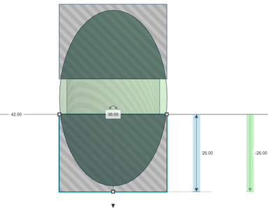

In this step you create the section of the Egg topper that will be hollowed by the cylinder from the last step. Create a sphere (W-36mm x L-36mm x H-60mm) and inside of the solid tab set it to transparent.
This will allow you to see through it yet it wont be a hole making it easy to see where the cylinder is inside of it.
Select both the cylinder and the sphere and press L. Now there should be dots along corners and middles. This is alignment tool. Alignment is used when a objects need to be centred or aligned along the edge with other objects. In this case we want the hole to be centred with the cylinder so press the two middle notches.
Then create two boxes set as holes. larger than the circle as shown above. Set ones level to the plane as 12mm as that is the height of the cylinder and the others level as its negative height.(level flat below the plane) as shown above.
Next select all and group it together.

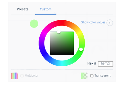

If you make your object non transparent than you will be able to see the next tip more easily. If you click on solid in an objects tab than you will be displayed with the second image you can see above. This allows you to tailor the colour of your object. using HEX you can easily copy colours from anywhere by using online colour pickers. I found that the instructables robot has a HEX code of - #f8c12f and the worlds ugliest colour has a HEX of - #4a412a.
