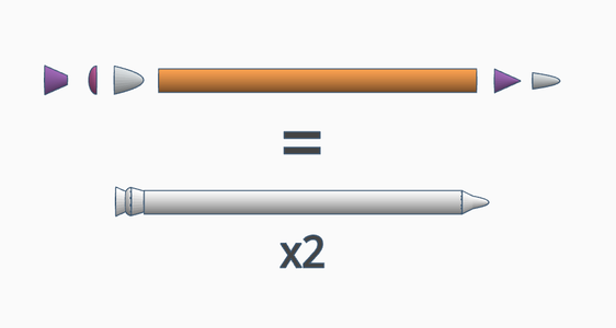

Step 2: The Boosters
Create a cylinder as the main body of the booster.
At the front use a cone and a paraboloid to create a smooth point.
A paraboloid, half sphere, and a cone will form the booster at the back.
Next group It all together.
Duplicate the boosters and put aside for now.
Tip: ctrl C - ctrl V to copy and paste

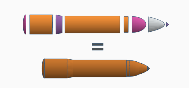

To create the main body, you will once again you need a cylinder.
To the right of this is a slightly smaller cylinder.
Create the nose with a half sphere and a paraboloid.
A tip can be made with a small cone.
The tail end is made up of a cone, cylinder and a half sphere.

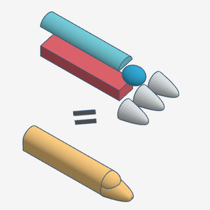

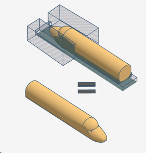

Step 4: Shuttle Pt1 (Body)
Now for the trickier part; creating the shuttle.
To establish the main shape use a box, sphere, round roof and several paraboloids.
For a seamless fit use meta fillets, and boxes.
Tip: ctrl g = group

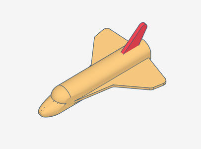

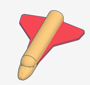

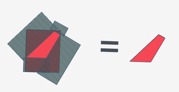

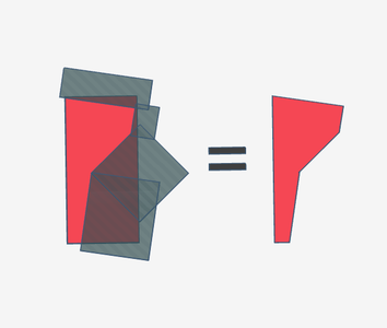

Step 5: Shuttle Pt2 (Wings)

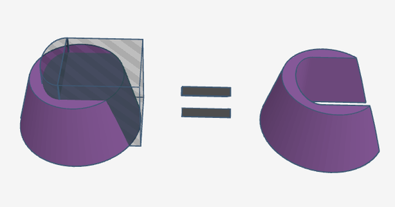

To form the basic shape, cut around a solid box with hole boxes.
To have a nicer finish use a 'partial angle tube' to round off the edges.
Now duplicate the wing and place on either side of the shuttle.
Tip: You can use an online protractor for accurate measurements of the wing.

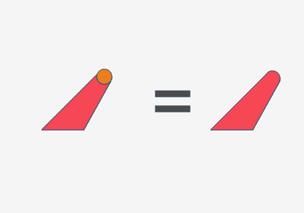

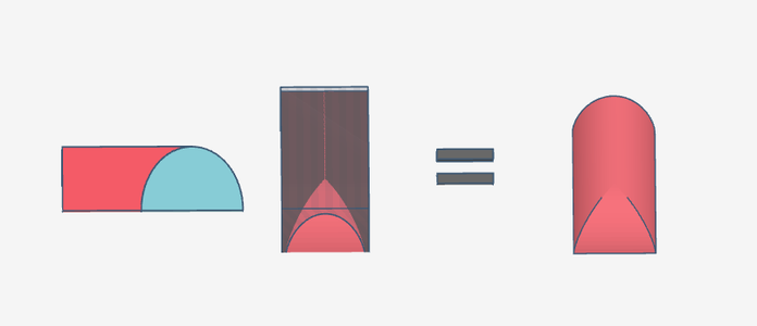

Step 6: Shuttle Pt3 (Fin)
Repeat the previous step again using holes to create the shape on a box.
For a rounded top I used a cylinder.
Place the fin on the shuttle turning it through 90°.

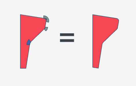

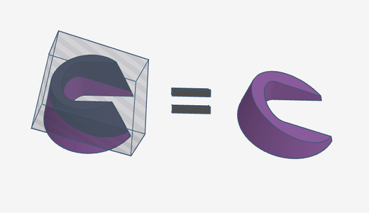

Step 7: Shuttle Pt4 (maneuvering Engines)
Use a box and curved roof to form the first shape.
Then, to make it 3D, use two meta fillets to curve the two sides.
Now we have a nice rounded shape put it on the Shuttle at a slight angle so there is no gap beneath it.

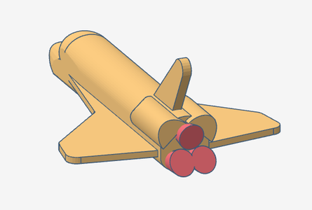

Step 8: Shuttle Pt5 (boosters )
Use a 3 cones to create the boosters.
Tinker around until you think you have the right angle.
Remember to have two lower than the other.
To make a cone like I have change the top radius in the shape setting (top right)

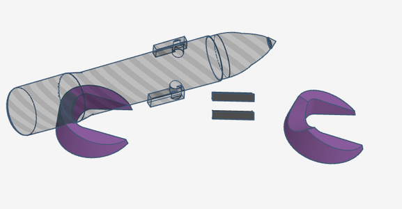

Step 9: Attaching Boosters to Fuel Tank
As we are not printing it in one piece, we have to create ways of assembling the parts together.
The fuel tank will connect everything together.

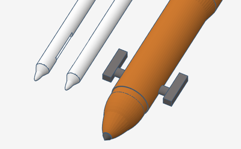

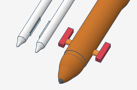

Use a cylinder and two boxes to build what will connect to the boosters.
Next create a hole in each booster with a box.
Make sure these holes are slightly larger than the previous boxes.

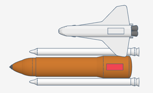

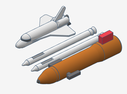

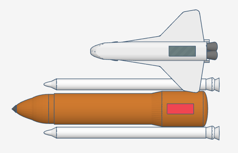

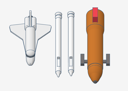

Step 11: Positioning for Print.
Line up the three parts side by side making sure they are level on the work plane.
Be sure to export the parts separately!

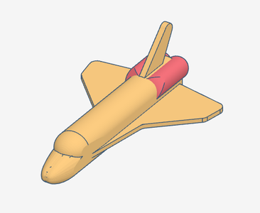

If you don't want to export separately you can skip the the previous 2 steps and connect the boosters to the fuel tank with a cylinder. (see image 3 ↑↑ )

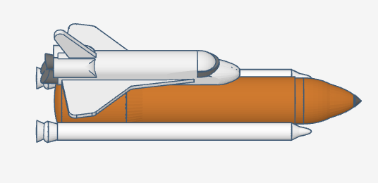

This was a great to build and print and super fun.
Above are some images of the Shuttle↑↑
