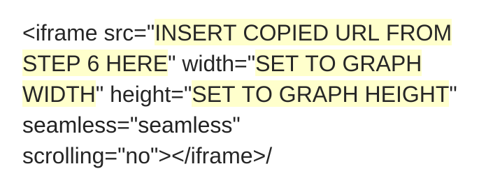

Step 7: Embed Graph in Webpage With Iframe
Insert the code above into your the HTML of your webpage where you would have otherwise included your image file. You will need to insert the URL of the shared graph, the height and width of your graph into the appropriate highlighted area in the code.
Save the HTML file.
You now have an embedded interactive graph on you webpage that can be forked, opened and manipulated by your readers. This code will also allow you to create a user gallery of all of the user generated graphs that are made with the source data for your graph that you can also show in your blog.
