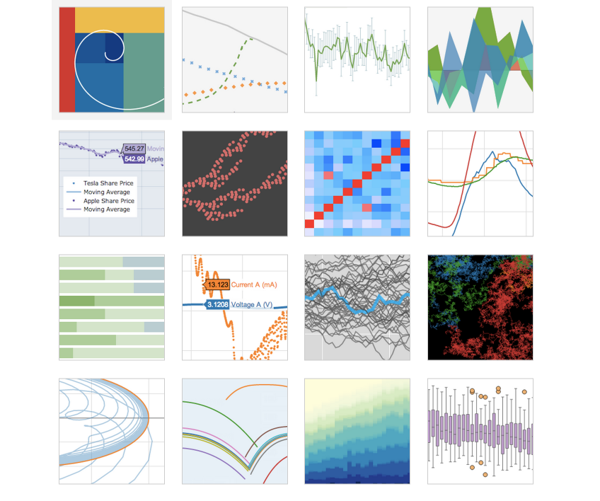

The purpose of this Instructable is to take some temperature data read from a TMP36 sensor, and visualize it using real-time streaming using the Plotly Python API!
Here is an example of our final product: https://plot.ly/~demos/1415/

Here is an example graph made with streamed data from a Raspberry Pi:
