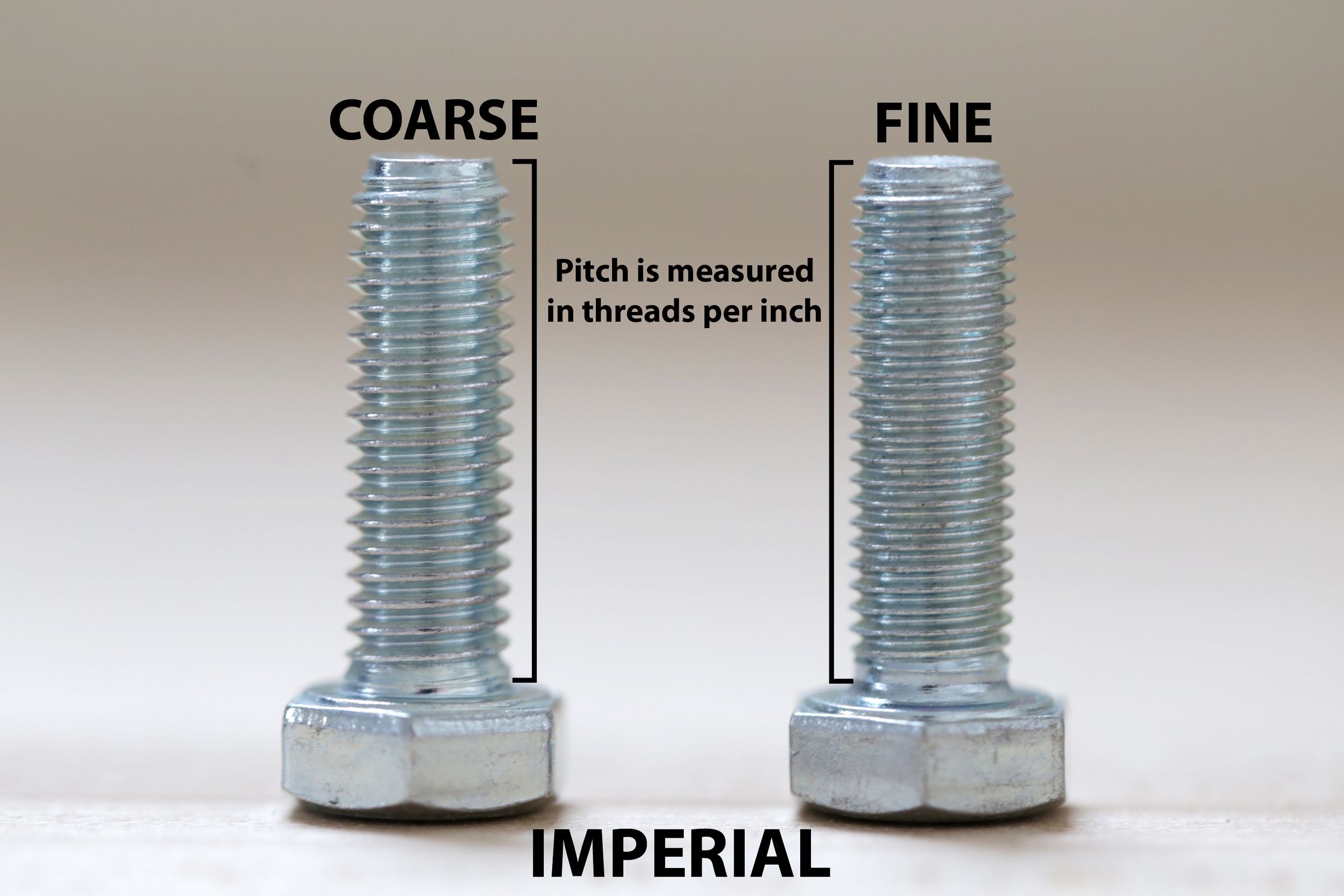

When approaching bolt threading, there are two aspects that you need to pay attention to, and those are the pitch and diameter. The pitch is the distance between the peaks of threads. The diameter is the width of the bolt's shaft.
In the United States, the diameter can either be measured in imperial or metric. In most the rest of the world, you will likely be dealing exclusively in metric.
To further confuse matters, the pitch is then measured differently depending on the type of bolt you are using.
Imperial bolts measure pitch in threads per inch. For instance, say you have a 1/4-20 bolt. This means that it is 1/4" wide and has 20 threads per inch. If you want a finer threading, you may consider getting a 1/4-32 bolt, it is still 1/4" wide, but now has 32 threads per inch.
The more threads it has per inch, the finer the threading is considered. Conversely, bolts with less threads are considered "coarse." Regardless of threading, you will always need a nut with an identical pitch to match it.

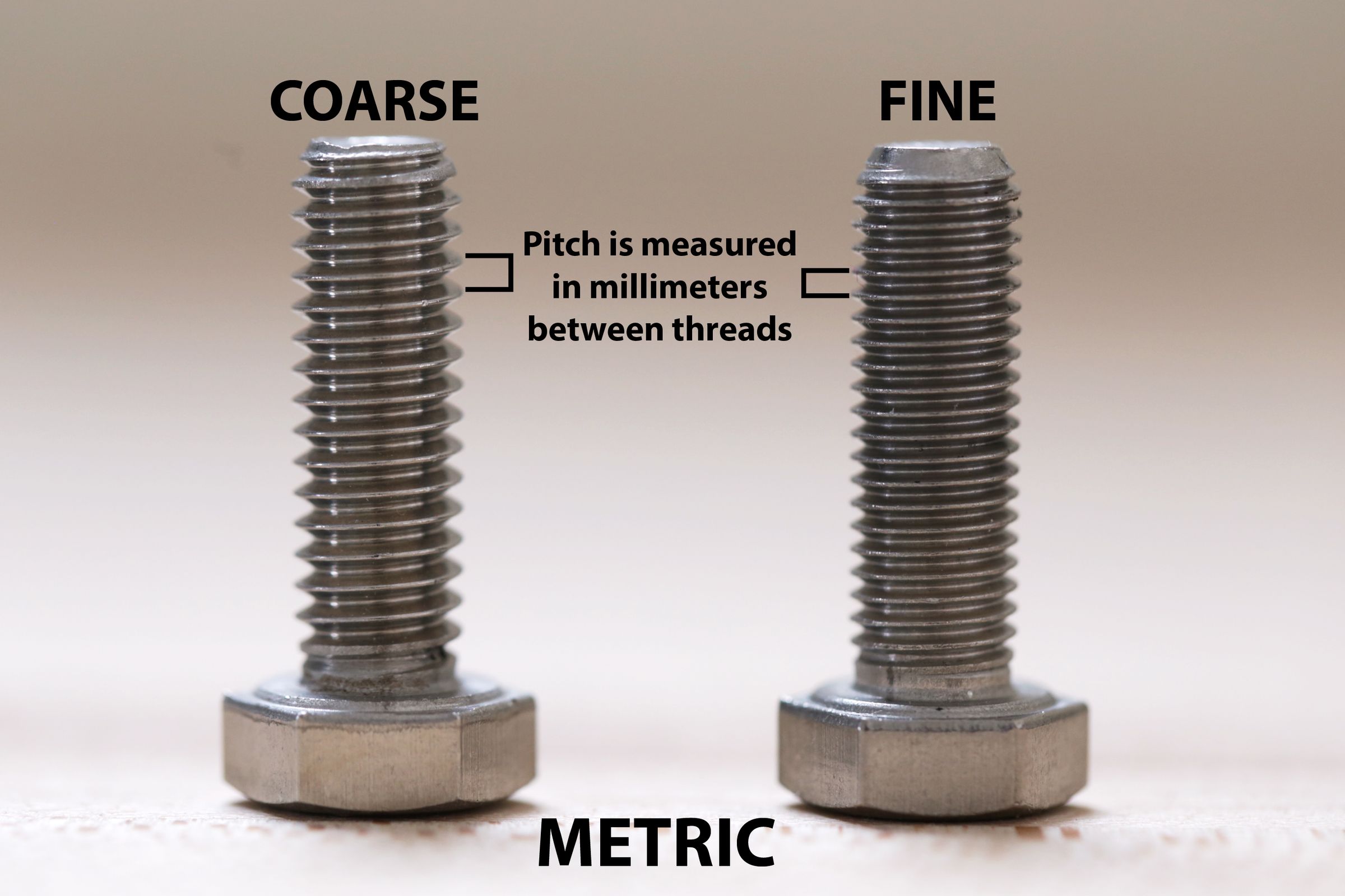

Since the metric system does not use inches, metric bolt threading is obviously not measured in threads per inch. Instead, it is measured purely in millimeters. So, if you have an M6 x 1, it means that the bolt is 6mm wide and the threads have a pitch that is 1mm apart (i.e. 1mm peak to peak). This is opposite imperial in that as the pitch gets higher, the thread coarseness increases. The smaller the number, the greater the pitch. For instance, an M6 x 1 would be a much finer pitch than an M6 x 1.5.

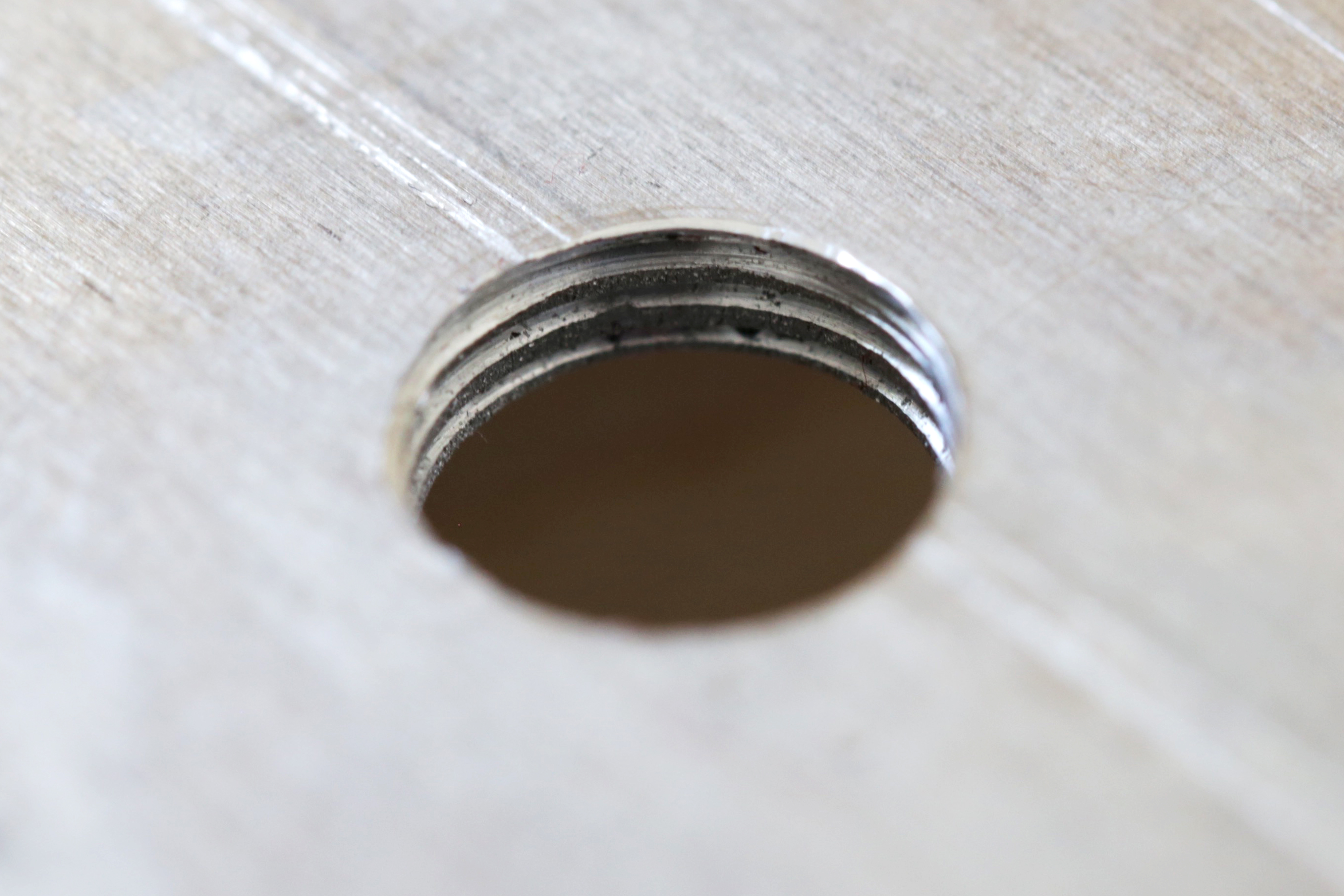

Step 3: Tapping
To tap a hole is to use a tap to cut a helical groove or "thread" into it. The purpose of tapping a hole is to make it so that a bolt can be threaded into it. Thus, a tapped hole needs to exactly match the threading of the bolt. Like most concepts in metalworking, tapping a hole can take a few minutes to "get," and a lifetime to master.

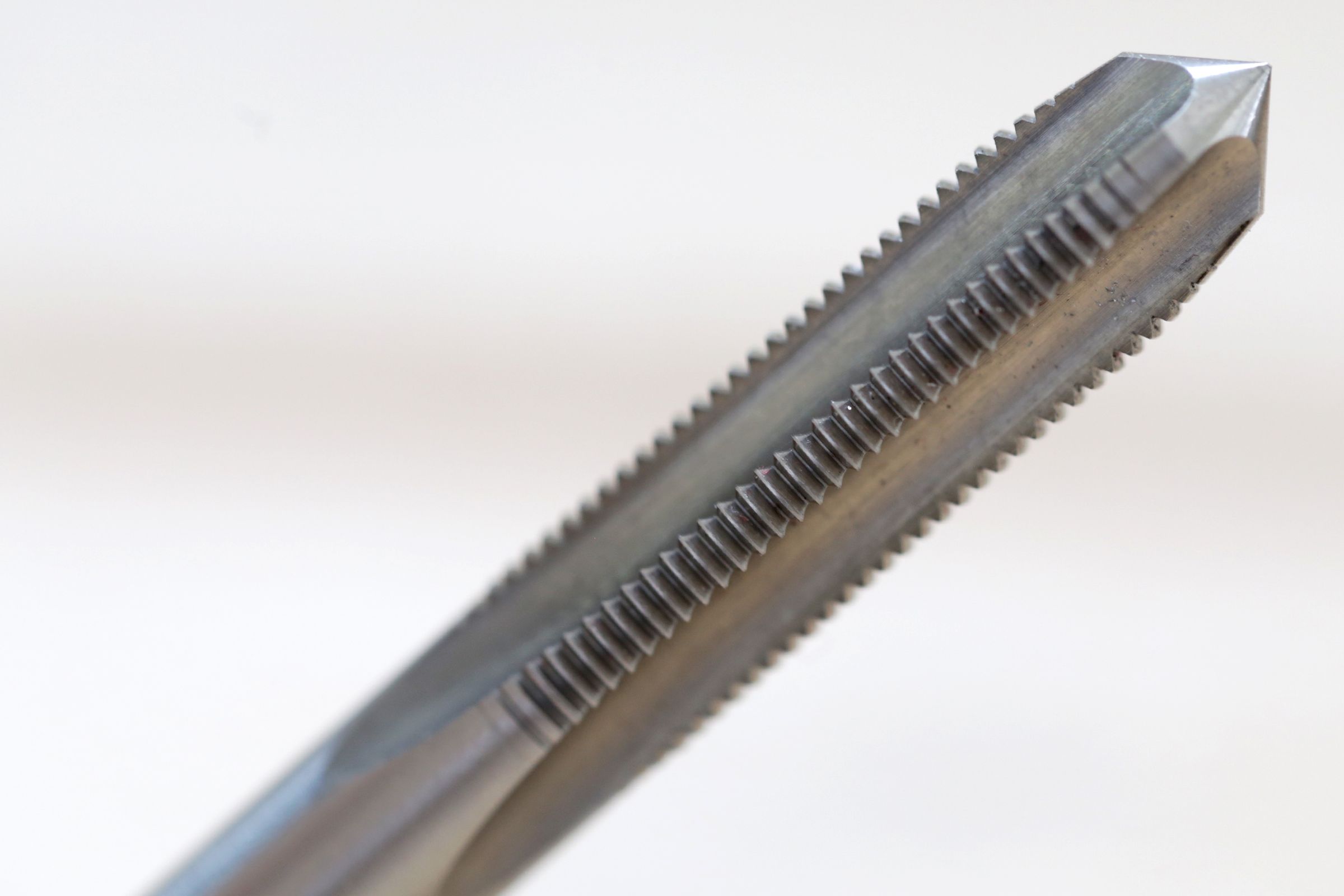

Taps have cutting blades which cut the threads as they are twisted into the hole. The cut material ends up in the flutes cut into the side. Unlike with drill bits which have helical (spiral) flutes, taps have straight flutes.

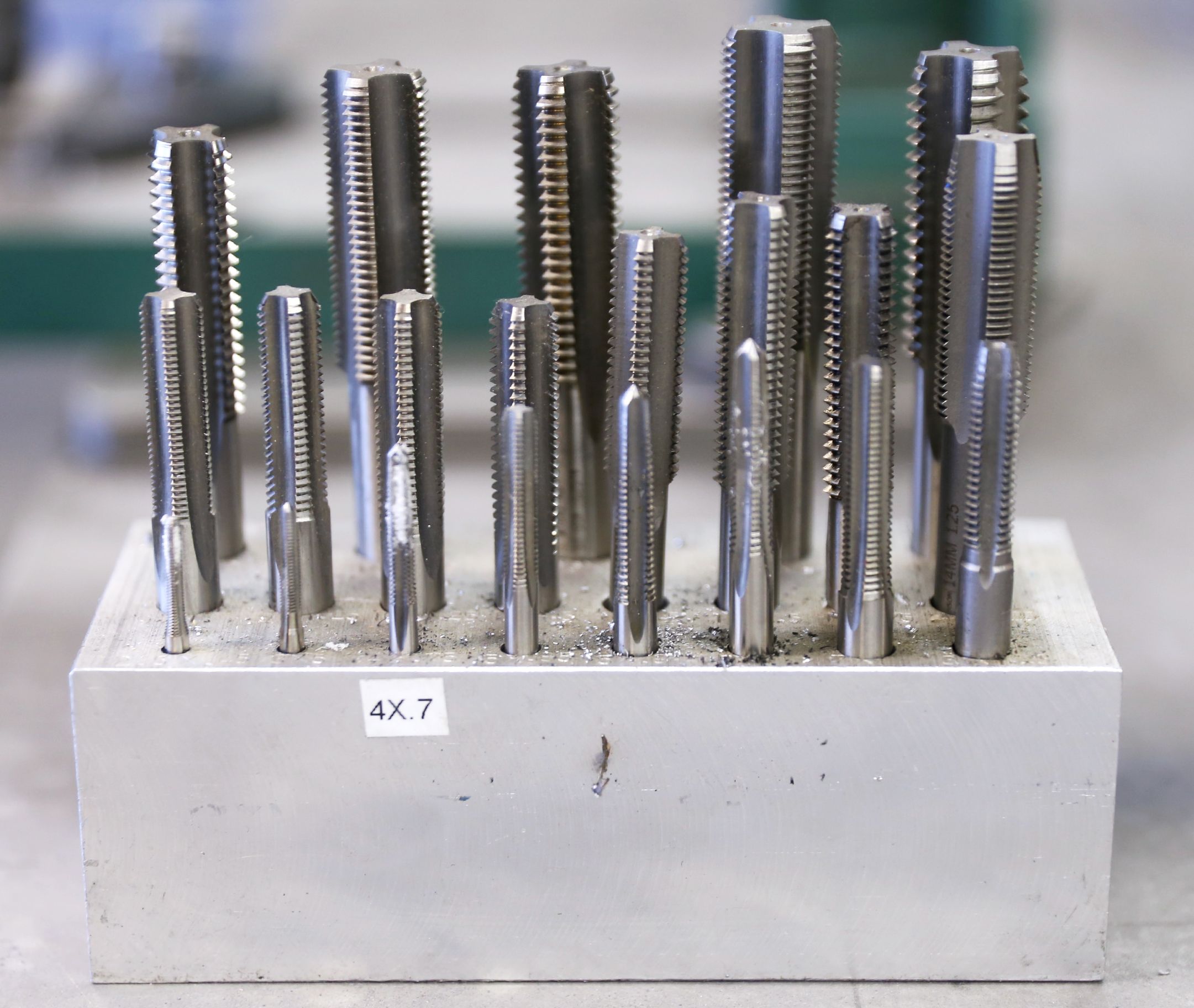

They make taps that match every imaginable bolt size and threading for both imperial and metric bolts. You can always find a tap to meet your needs.
Any hole made in metal can be threaded if drilled to the proper size for a tap. This hole is always slightly smaller than the diameter of the bolt that gets threaded into it. To figure out what size hole needs to be drilled, you should reference a tap chart. You can easily find one online, but if you really get into this, you should print out or buy one to hang on your wall.
