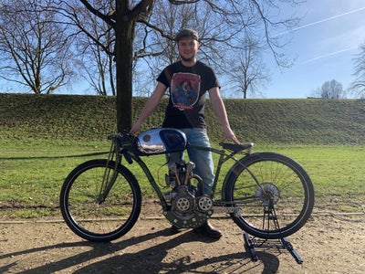

The aesthetics of the bike was one of the biggest reasons i wanted to start this project. The springer fork, long frame and narrow tires just apealed to me. I chose to keep the paintjob close to th one on the Harley Davidson in the intro. I painted the rims black and used a leather bicycle seat. I mixed this with raw metal parts en polished brass. The old moped tank is kept in original state to give the impression that the bike really is that old. Gold pinstriping is added to give a little sparkling and refinement in the rather rough aesthetic of the early motorcycles. The motorcycle even has its own toolkit which is filled with vintage tools.

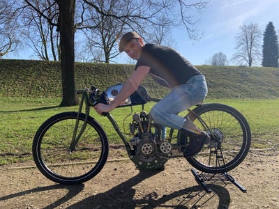

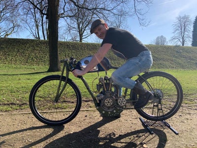

Well this is it. The bike looks the way I want it to look, It runs and is frightening while standing on his stand. The bike is a handfull but that's the way it's supposed to be. No brakes, no clutch, just "gas and go"! I haven't been able to ride it yet because i need to find an open flat road where there will be nothing in my way. The project will never be finished and I will keep fine tuning things. I dare you to build your own so we can have a race!
