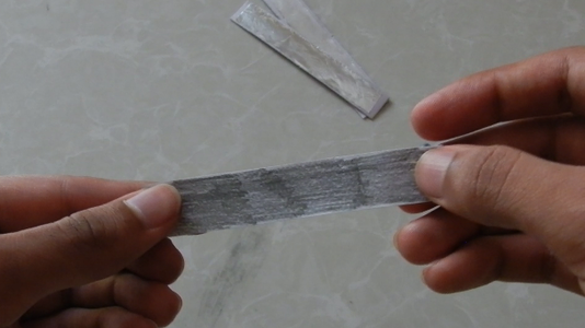

Step 4: Shading the Paper Strip
This step too is going to be quite easy. The reason I am repeating this statement is that this project indeed is so easy to make that anyone can make it without any technical experience too. Now coming to this step, we just need to shade the paper strip that we had taken earlier on both sides. You can use any kind of pencil for it.
Just make sure that you shade the paper strip very dark. I am sure there is going to be a mess after you are done with black carbon prints everywhere but I guess that is OK :)
