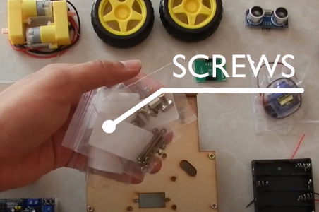

Step 1: Gather the Components
First, to begin with, we obviously need to gather the components and tools required to build the robot. Find the components and the tools required below:
Get components at one place for ease: The Arduino Robotic Kit
Individual Components:
Tools (Optional):
Gather the components and move on to the next step!

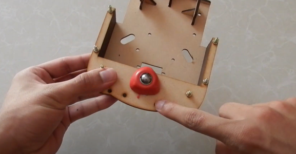

Step 2: Attach Motors and Wheels
The very first thing I did with the chassis was to add a castor wheel at the front which will act as a supportive third wheel at the front and it can rotate freely as it has 360-degree freedom. This way we can avoid the use of 4 wheels and get away with a 2-Wheeled robot.
Next what we need to do is a classic step in any vehicle-related project. Attach the motors and wheels to the chassis. There is no particular way to do this because everyone might be using a different chassis but I would like to mention one thing here: Ensure that the motors are fixed sturdily and are both levelled the same and also the wheels are pointing exactly forward. Otherwise, you might have some movement-related issue later-on.
Solder wires to the motors and move on to the next step!

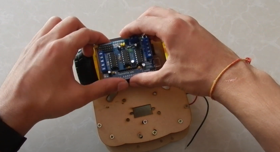

Step 3: Attach Arduino and Motor Shield
Attach the Arduino board on the top of the chassis. You can attach it in any preferable way. This could be either using a few spacers and screws or directly sticking the Arduino board on the chassis using a piece of double-sided tape. Personally, I always would go with the first method because it gives it a more professional look.
Then just insert the motor shield on top of the Arduino board and you are good to go!

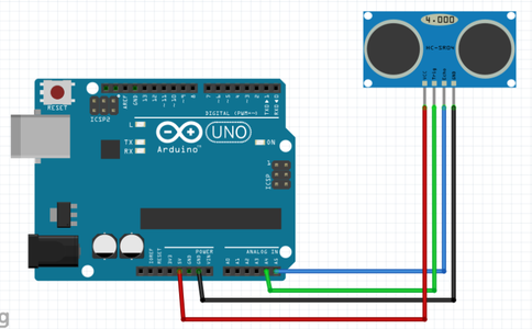

Step 5: Wiring
We again have three things here. So, there are three things that we need to take care of while wiring the robot:
  • Motors
The motor shield has ports for connecting up to four motors, in the form of screw terminals. Just connect the motors into any two terminals as we are using only two motors.
  • Servo Motor
The servo motor has just one plug wire that has three wires in it. Just plug it into the servo terminal on the motor shield namely S1.
  • Ultrasonic Sensor
Refer to the image present above for the connections of the ultrasonic sensor to the Arduino board. (or) Connections:
  1. Sensor GND : Arduino GND
  2. Sensor VCC : Arduino +5V
  3. Sensor TRIP : Arduino A4
  4. Sensor ECHO : Arduino A5
Also, connect the battery holder to the motor shield's battery screw terminals and move ahead, yet again!
