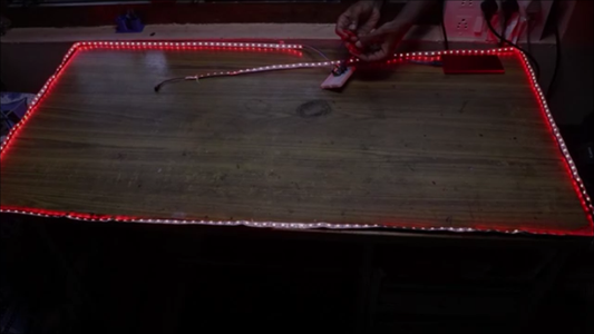

I have made green and red colors, suppose player 1 is green color and player 2 is red, each player has to be very fast to reach the end of the LED, whoever wins the entire strip glows with that color.
Suppose player 1 wins green colors light up and in the case of player 2 red colors.

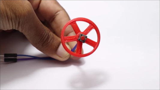

Toggle Buttons
These buttons will be used as inputs to control the game.

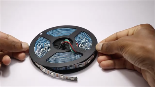

What are ARGB Leds?
The ARGB LEDs are addressable, meaning you can control each LED individually. It can display almost any color as it is RGB,
You can program the Arduino Nano to display various patterns, colors, and animations on the LED strip based on your LED game logic.
These come with 3 pins, 2 for + and - supply and one for digital signal, make sure you check for the direction of data/signal flow before connecting to arduino.

Toggle Buttons
The toggle buttons are connected to pins D6 and D7 on the Arduino Nano. These pins are set as input pins and will read the state of the buttons (pressed or released) the other terminal of these buttons are connected to gnd.

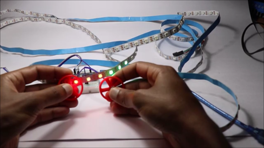

Start by attaching the Arduino Nano to the breadboard, now with the help of jumper wires start to make connections.
Connect the ARGB LED strip wires to the breadboard.
I started to connect the toggle buttons first, make sure that you use enough length wires for toggle buttons as these are the parts that control the game means more actions will occur.
After the 2 toggle buttons are connected connect that indicator LED to the breadboard

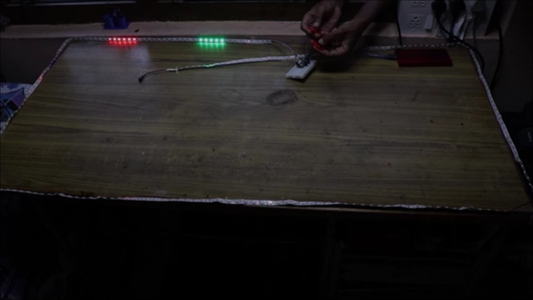

Step 4: Setting the Game
I found that the game would be much more exciting if the LED strip are put in a wider area.
Doors, old TV stands, and big tables are a good spot to install these, with the help of some popsicle sticks i was able to install these games on my old desktop table.
Make sure you use hot glue to stick popsicle sticks to the table so that you can remove them easily later if you want to.

Call your friend whom you want to play with, hand over one toggle button to him you take the other.
You can identify yourself with colors, player 1 green is and player 2 is red.

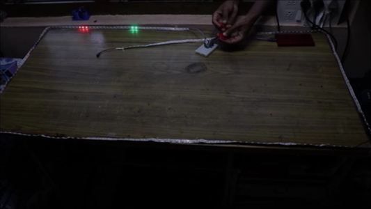

Switch on the project(USB power supply) and when the LED appears on the start point of the LED strip start to press the toggle button as fast as possible.
You can check where your competitor's lights are and take faster action.
Whoever reaches the end first the entire color of the LED strip will turn on to the winner's color.
The winner will be the winner anyhow! No cheating works here.
