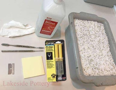

  • PC-Clear 5 minutes epoxy
  • 91% alcohol
  • Holding container with resin / PVC pellets or similar
  • Epoxy mixing stick or a pin-tool
  • Metal rod (brass or stainless steal)
  • Cotton rag
  • Masonry drill bits
  • Hand drill
  • PC-11 Epoxy filler
  • Air compressor

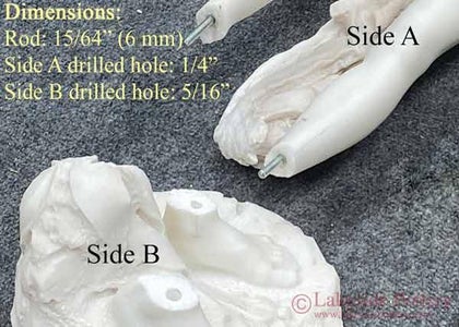

Step 1: Cutting Metal Rod
  1. Cut rod to size - 5" in this case
  2. Grid off sharp edges on the cut rod

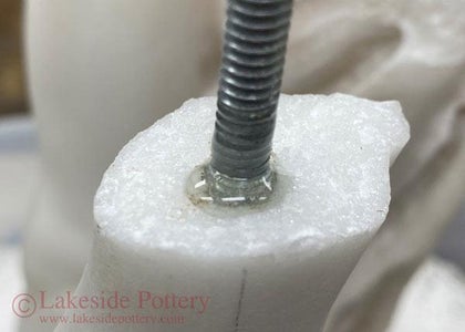

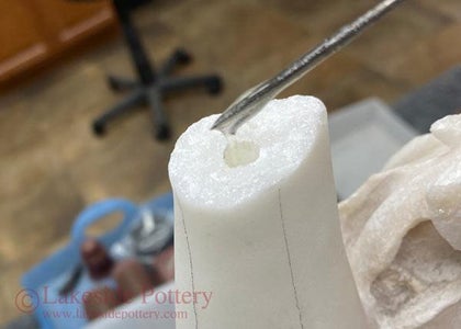

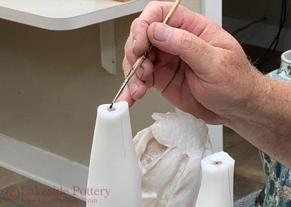

Step 2: Drilling Side A
  1. Use masonry drill bit to drill a hole in the center of one side (A) of each leg
  2. Verify fit before cementing rod to side A
  3. Clean the drilled holes with air gun
Step 3: Cementing Side A
  1. Use two-part epoxy (PC-Clear). In this example we use 4-5 minutes epoxy with about 2 minute workable time. Mix well
  2. Fill 2/3 of drilled cavity with the mixed epoxy
  3. Insert rod and turn a few times to ensure that epoxy touches all surfaces
  4. Quickly wipe off excess epoxy with a rag and 91% alcohol

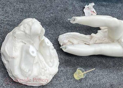

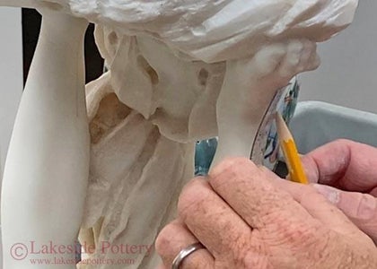

Step 4: Marking Side B Drilling Guide Pencil Line
  1. Mirror the rod orientation on the stone exterior wall to be used as a guide to drill side B correctly
  2. Use pencil to mark the rods location on Side A

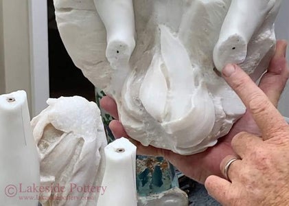

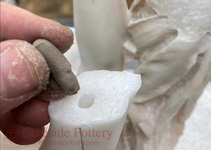

Step 5: Marking Side B Accurate Drilling Location
Drilling accurately on both sides of the broken pieces for proper alignment is tricky. There are more than one way to achieve accuracy the shown method is the option we chose for this project.
  1. Insert soft clay in side A drilled hole
  2. Flatten the clay as shown
  3. Use acrylic paint to generously mark the clays center
Step 6: Transferring Side a Hole Location to Side B
  1. Carefully place side B in place
  2. Verify that the acrylic paint transferred from side A to side B
  3. Before removing, continue the previously marked line to side B in the same projection

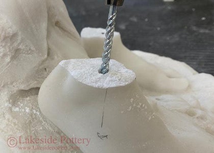

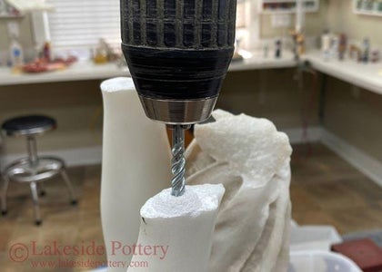

Step 7: Drilling Side B
  1. Drill a hole using the marked line as a guide
  2. Start with a narrower masonry drill bit (3/16") for better control and accuracy
  3. Drill with the next size (1/4")
  4. Finish with a size larger than side A drilled hole (5/16")

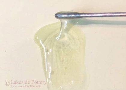

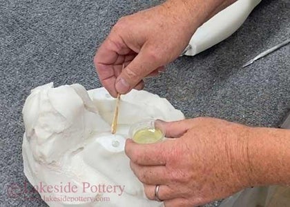

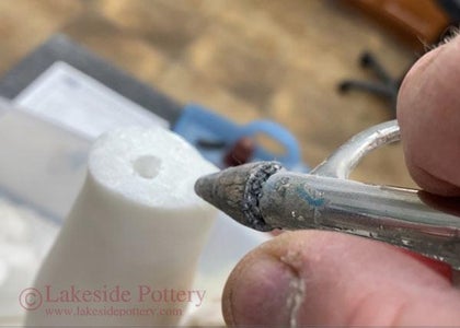

Step 9: Cementing Preparation
  • Clean the drilled holes with air gun
  • Use two-part epoxy (PC-Clear). In this example we use 4-5 minutes epoxy with about 2 minute workable time. Mix well
The shown epoxy has about two minutes workable time.
Use slow cure epoxy if uncomfortable with 2 minutes

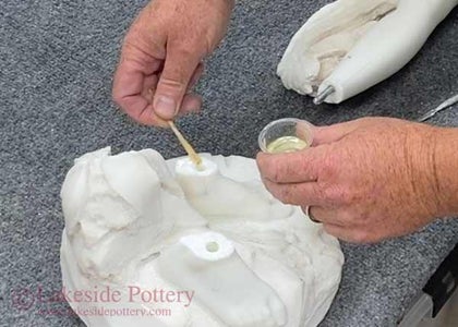

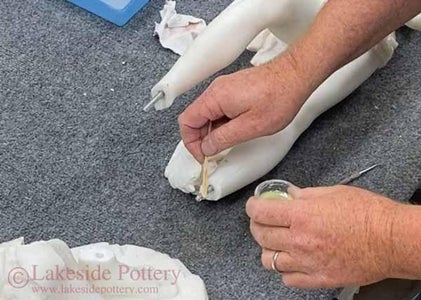

Step 10: Applying the Epoxy to Both Sides
  1. Apply epoxy to rods
  2. Fill 2/3 of drilled hole with the mix epoxy
  3. Apply epoxy to all surface carefully of side A and side B

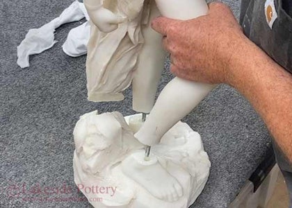

Step 11: Placement
  1. Place the statue two part together
  2. Do not wipe excess epoxy off to avoid smearing. Remove epoxy after the epoxy is set. It will be harder to remove if excess epoxy is removed when it is totally cured

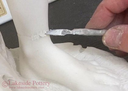

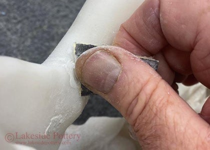

Step 12: Filling Mended Joints
  1. Mix filler epoxy (PC-11)
  2. Apply filler to joint cracks
  3. Sand off epoxy filler when it is cured (24 hours in a room temperature of 70 or warmer)
Step 13: Sanding
  1. Sand filler starting with 220 grit sandpaper, continue with 400 grit and finish with 2400 micromesh silicon backing abrasive
  2. Clean with 91% alcohol prior to painting / glazing
