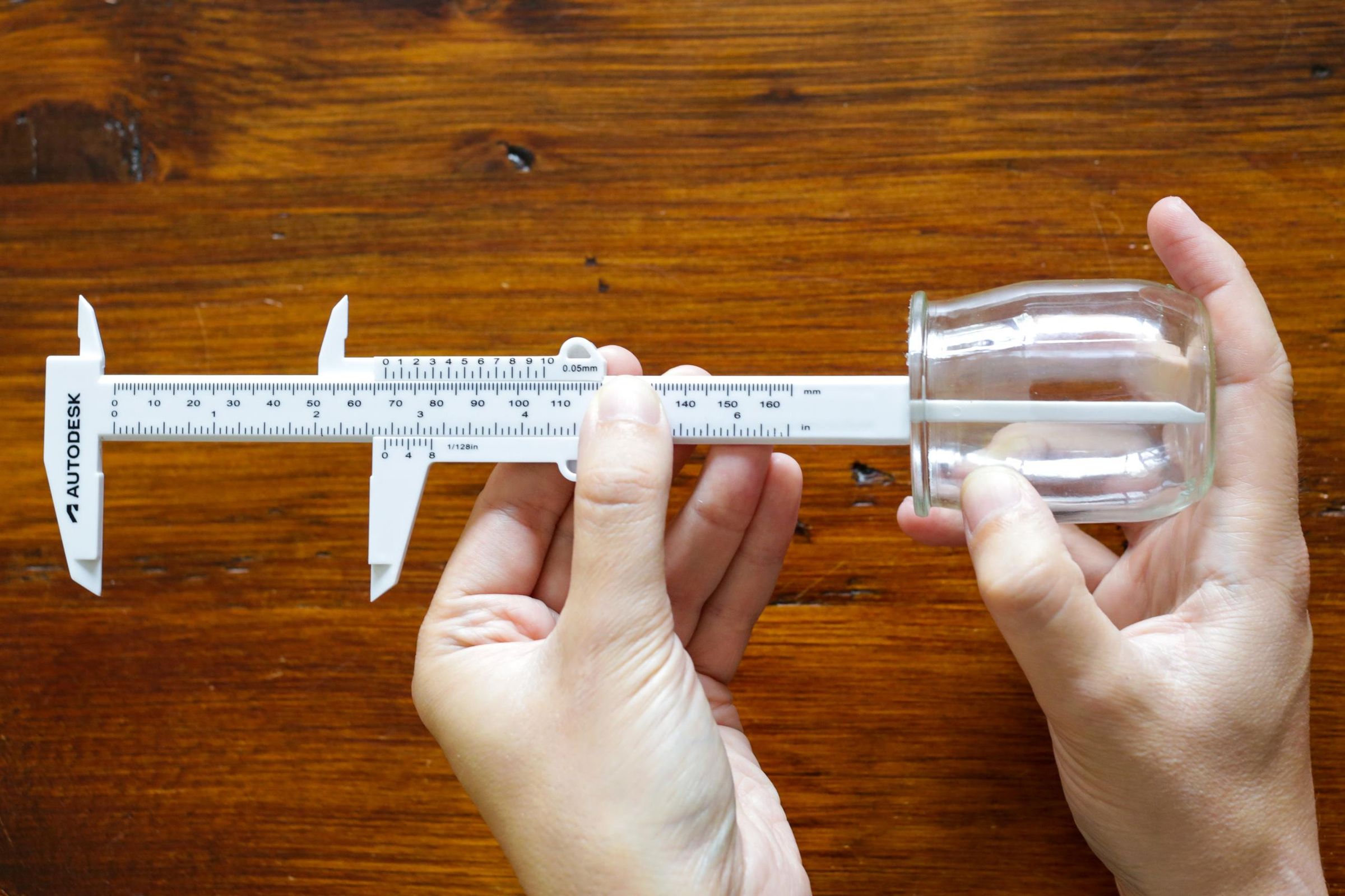

Step 6: Measuring Inner Dimensions
There are two ways to measure inner dimensions.
The first way to measure this is to use the inner jaws. This is best when you want to measure the length of a large opening. You can simply place the inner jaws at each edge of the opening to measure its distance.
The other way to measure the inner dimensions of an object is to use the depth probe. This is best to use when you want to measure the height of a hole. To take this measurement, you simply place the bottom of the caliper along the hole's edge and then lower the depth probe until you reach the bottom.

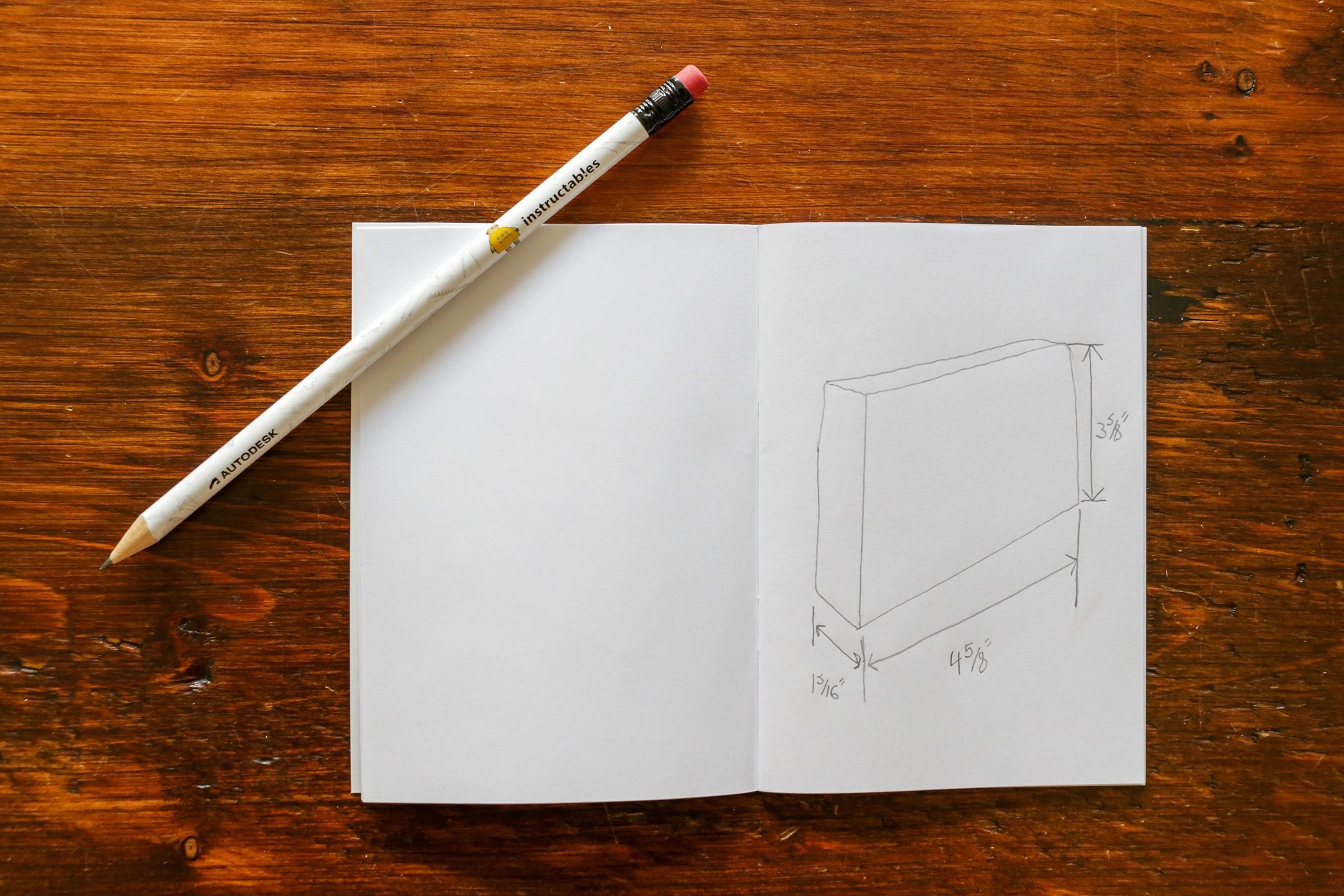

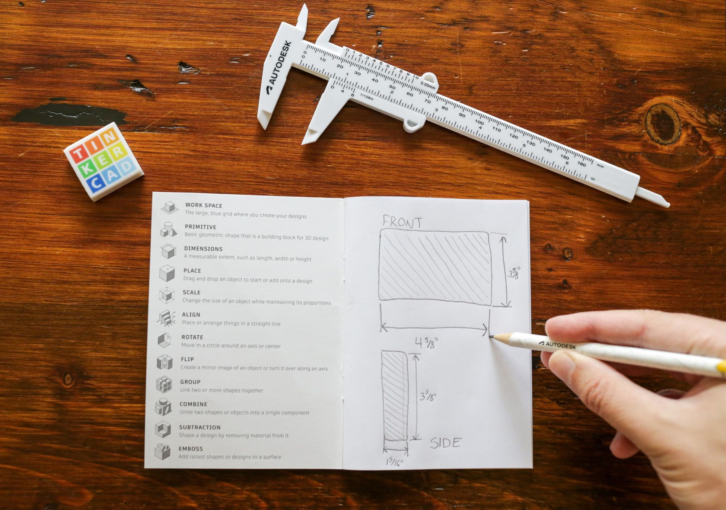

The easiest way to record your measurements is on paper. To keep it simple, we will be practicing with the small box we measured earlier. The idea here is to do a rough sketch of the object you are trying to measure. You don't need to be an expert artist. The most important part is that the measurements are correct and you will understand what you drew if you were to look at it later on.
In order to record the measurement we will start with 2D profile views. This is what you would see if you looked at one side of the object directly from any of its sides. There are six different profile views and these include the front, back, top, bottom, left and right. The nice thing about profile views is that even if you are not good at drawing, you can likely draw an object's two-dimensional shape.

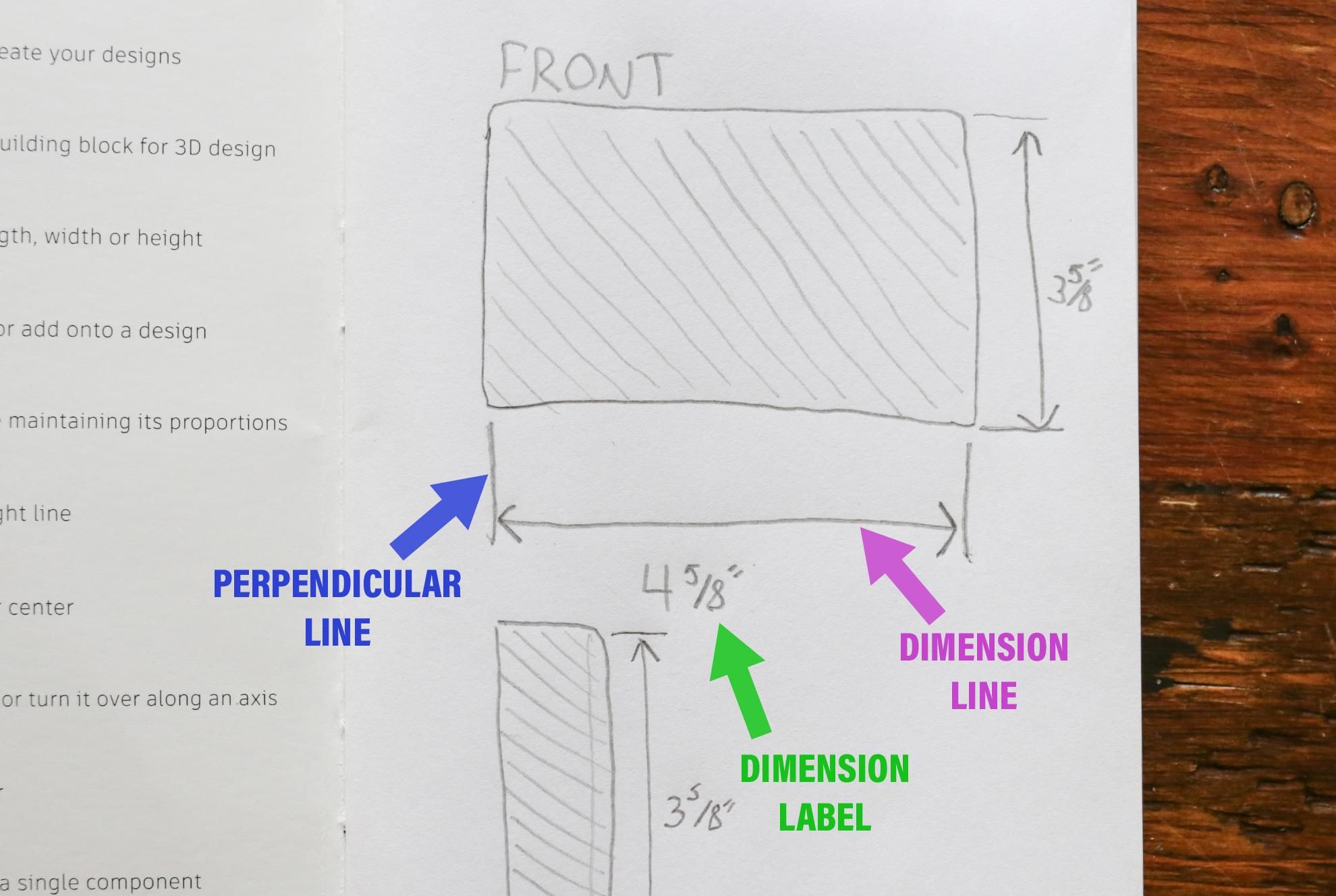

In our notebook we will use profile drawings and dimension lines to indicate the measurements of each of the yellow box's three sides. Another thing to note is that since each profile view is two dimensional, you always need at least two different profile views to record all three dimensions.
To draw a dimension line, simply draw a straight line that is equal size to what you are measuring and put arrows on each end. You can also draw perpendicular lines from the tip of the arrows to the edge of what you are measuring to help clarify what the dimension line is a measurement of.
Another fast way to record all of the dimensions of your object on paper is to draw it using 3D perspective. When you do this, you can record all of your dimensions at once.

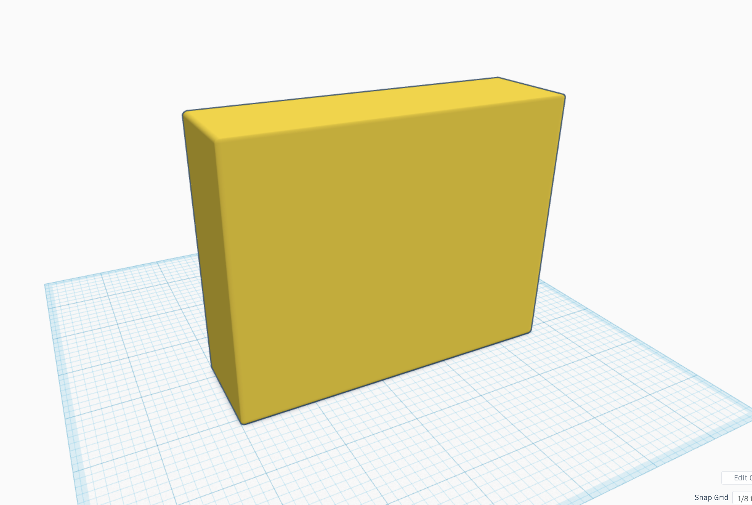

Step 8: Translating to 3D Software
To translate what you have just drawn on paper to the computer, open Tinkercad and create a new 3D design and give it any title you would like. I called mine "Measured Box".
If you are working in inches, click the "Edit Grid" button on the bottom and change the Units from millimeters to inches. If you are working in millimeters, you can skip this.
Select a Box from the shapes panel and place it on the workplane.
Click on the box and select one of the corner handles to bring up the length and width dimension boxes. Enter the length and width measurements that you have taken into the appropriate boxes.
You will need to convert the measurements to decimals from a fraction (if you have not done so already). For instance, 4-5/8 inches would become 4.625 inches. I translated 5/8 to a decimal by diving 5 by 8 using a calculator.
Finally, set the height by clicking on the box again and selecting the height handle (in the center top of the box). Enter the height measurement in the dimension box.
Your virtual box should now have the same dimensions as the one you measured in real life.
To finished it up you can also change the color of the box to match the one you measured. They now should look roughly the same!
