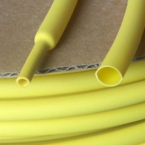

I started with the yellow leads. i looked in my local hardware store to find yellow electrical cable but couldn't find it so i just got some regular three core power cable. I then fed this cable into some yellow heat shrink tube. Then i heated the tube and it shrank to the size of the 3 core cable.
I couldn't just use the yellow heat shrink as it would kink as i bent it and not curve correctly.So with the 3 core cable inside the heat shrink it means the cable can be bent and not kink up, its a smooth bend.
