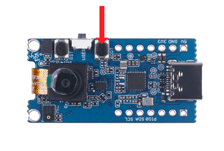

First of all, I connected the VOC & eCO2 gas sensor (SGP30), the CO2 & Temperature & Humidity sensor (SCD30), and the soil moisture sensor to Wio Terminal via Grove connection cables.
Then, I connected Wio Terminal and the Vision AI module to LattePanda 3 Delta via USB cables.
To observe running processes, I attached the 7'' HDMI display to LattePanda 3 Delta via a standard HDMI cable.
After printing all parts (models), I fastened all components except the Vision AI module to their corresponding slots on the main case via the hot glue gun.
Then, I attached the Vision AI module to the laterally moveable part allowing placing the module on the case's attachable trail or a separate location.
Finally, I placed the sliding back cover via the dents on the case.

Step 9: Capturing and Storing Images of Diseased Trees W/ the Grove Vision AI Module
After managing to transfer commands with Wio Terminal via serial communication, I programmed LattePanda 3 Delta to capture tree images with the Vision AI module if it receives the capture command ('A').
Before proceeding with the following steps, I needed to set the correct settings for Wio Terminal and the Vision AI module on LattePanda 3 Delta and upload (flash) the data collection firmware to the Vision AI module.
#️⃣ First of all, to capture tree images with the Vision AI module in Python, connect the module to the PC and double-click the boot button to enter the boot mode.
#️⃣ Then, copy the capture_images_Grove_AI_firmware.uf2 file to the module's drive folder.
#️⃣ As soon as the uf2 file is uploaded into the drive folder, the drive should disappear.
#️⃣ Since Ubuntu (Linux) cannot obtain information from an unrecognized USB device, create a new rules file (60-visionai.rules) including this line:
SUBSYSTEM=="usb", ATTRS{idVendor}=="2886", ATTRS{idProduct}=="8060", MODE="0666"
#️⃣ Save the new rules file to the /etc/udev/rules.d/ folder.
#️⃣ Then, restart the udev rules via the terminal.
sudo udevadm control --reload-rules
#️⃣ Since Ubuntu throws a permission error while attempting to get data from serial communication as non-root, find the Wio Terminal serial port on LattePanda 3 Delta with the Arduino IDE.
#️⃣ Then, change the permission of the Wio Terminal serial port folder via the terminal:
sudo chmod 666 /dev/ttyACM1
