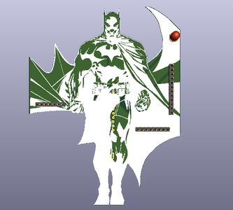

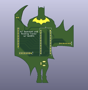

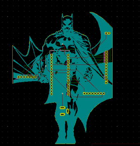

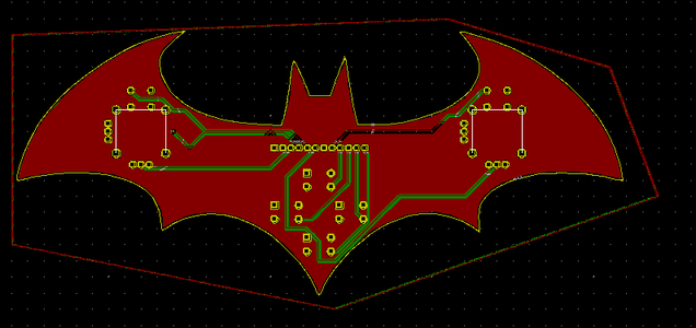

Step 2: Designing and Soldering Batman-themed Base and Controller PCBs

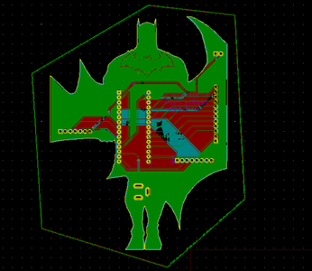

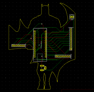

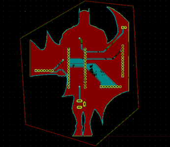

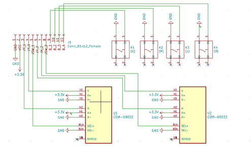

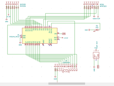

Before prototyping my Batman-themed base and controller PCB designs, I tested all connections and wiring with the Arduino Nano 33 IoT and the MFRC522 RFID reader.

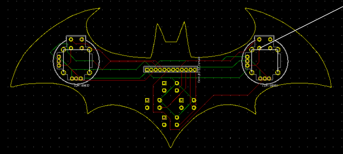

Then, I designed the Batman-themed base and controller PCBs by utilizing KiCad - inspired by the legends of the Dark Knight :) I attached the Gerber files for both PCBs below. Therefore, if you want, you can order my PCB designs from PCBWay to create your RFID-enabled IoT bookmark and reading tracker so as to transfer your book ratings effortlessly to a Qubitro application.
Click here to inspect and order the base and controller PCBs directly on PCBWay.
First of all, by utilizing a soldering iron, I attached headers (female), COM-09032 analog joysticks, pushbuttons (6x6), a 5mm green LED, and a power jack to the base and controller PCBs.
📌 Component list on the base PCB:
A1 (Headers for Arduino Nano 33 IoT)
RFID1 (Headers for MFRC522 RFID Reader)
SH1106 (Headers for SH1106 OLED Display)
J1 (Headers for Controller PCB)
D1 (5mm Green LED)
J2 (Power Jack)
📌 Component list on the controller PCB:
J1 (Headers for Base PCB)
U1, U2 (COM-09032 Analog Joystick)
K1, K2, K3, K4 (6x6 Pushbutton)
Step 3: Making Connections and Adjustments
// Connections
// Arduino Nano 33 IoT :
//                                MFRC522
// D3  --------------------------- RST
// D4  --------------------------- SDA
// D11 --------------------------- MOSI
// D12 --------------------------- MISO
// D13 --------------------------- SCK
//                                SH1106 OLED Display (128x64)
// D6  --------------------------- SDA
// D5  --------------------------- SCK
// D7  --------------------------- RES
// D8  --------------------------- DC
// D9  --------------------------- CS
//                                JoyStick (R)
// A0  --------------------------- VRY
// A1  --------------------------- VRX
// A2  --------------------------- SW
//                                JoyStick (L)
// A3  --------------------------- VRY
// A4  --------------------------- VRX
// A5  --------------------------- SW
//                                Button (Up)
// A6  --------------------------- S
//                                Button (Right)
// A7  --------------------------- S
//                                Button (Left)
// D2  --------------------------- S
//                                Button (Down)
// D10 --------------------------- S
//                                5mm Green LED
// D0  --------------------------- +

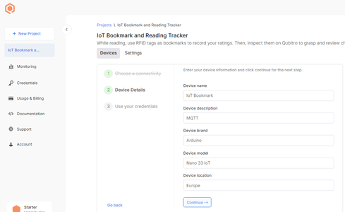

#️⃣ To create a new Qubitro device under the application, choose a connectivity method depending on your project's requirements. Select the MQTT option to transfer data via the Qubitro MQTT broker to the given Qubitro device.
#️⃣ Define the device information and details.

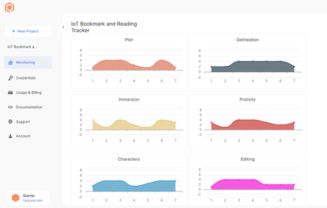

Step 7: Analyzing the Collected Data on Qubitro
After building my IoT application on Qubitro, I started to send data packets (book ratings) from the Nano 33 IoT to the Qubitro device under the application via the MQTT broker immediately.

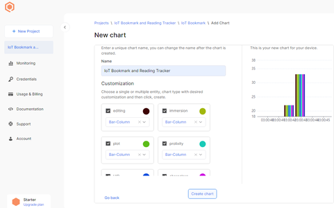

To analyze the collected data, I utilized the built-in chart feature in the device interface.
You can inspect the code for transferring book ratings via the Qubitro MQTT broker in Step 4.
#️⃣ After the Qubitro device receives data packets, open the device on the project dashboard and click Analytics.
#️⃣ Then, create a chart with unique colors for each data element to scrutinize the collected data in a given period.
Step 8: Creating Widgets to Visualize the Collected Data on Qubitro
#️⃣ First of all, on the project dashboard, go to Monitoring so as to create a new monitoring dashboard.
#️⃣ Then, click the Add widget button.
#️⃣ Define the required information for the widget: title, project (IoT application) name, device name, and widget type (e.g., area chart).
#️⃣ To customize the recently created widget, assign a data element (sensor value), select the widget color, and adjust the appearance settings.
After creating widgets for each data element, the Qubitro portal should show a monitoring dashboard as follows.

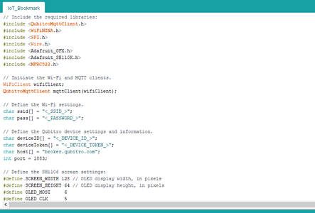

⭐ Include the required libraries.
#include <QubitroMqttClient.h>
#include <WiFiNINA.h>
#include <SPI.h>
#include <Wire.h>
#include <Adafruit_GFX.h>
#include <Adafruit_SH110X.h>
#include <MFRC522.h>
⭐ Initiate the Wi-Fi and Qubitro MQTT clients.
⭐ Define the Wi-Fi settings.
⭐ Define the Qubitro device settings and information (ID and token).
WiFiClient wifiClient;
QubitroMqttClient mqttClient(wifiClient);
// Define the Wi-Fi settings.
char ssid[] = "<_SSID_>";
char pass[] = "<_PASSWORD_>";
// Define the Qubitro device settings and information.
char deviceID[] = "<_DEVICE_ID_>";
char deviceToken[] = "<_DEVICE_TOKEN_>";
char host[] = "broker.qubitro.com";
int port = 1883;
⭐ Define the SH1106 OLED screen settings.
#define SCREEN_WIDTH 128 // OLED display width, in pixels
#define SCREEN_HEIGHT 64 // OLED display height, in pixels
#define OLED_MOSI     6
#define OLED_CLK      5
#define OLED_DC       8
#define OLED_CS       9
#define OLED_RST      7
// Create the SH1106 OLED screen.
Adafruit_SH1106G display = Adafruit_SH1106G(SCREEN_WIDTH, SCREEN_HEIGHT, OLED_MOSI, OLED_CLK, OLED_DC, OLED_RST, OLED_CS);

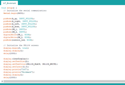

⭐ Initialize the SH1106 OLED screen.
  display.begin(0, true);
  display.display();
  delay(1000);
  display.clearDisplay();
  display.setTextSize(2);
  display.setTextColor(SH110X_BLACK, SH110X_WHITE);
  display.setCursor(0,0);
  display.println("IoT");
  display.println("Bookmark");
  display.display();
  delay(1000);

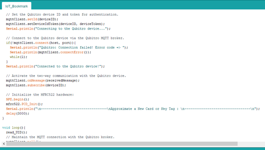

⭐ Set the Qubitro device ID and token for authentication.
⭐ Connect to the Qubitro device via the Qubitro MQTT broker.
  mqttClient.setId(deviceID);
  mqttClient.setDeviceIdToken(deviceID, deviceToken);
  Serial.println("Connecting to the Qubitro device...");
  // Connect to the Qubitro device via the Qubitro MQTT broker.
  if(!mqttClient.connect(host, port)){
    Serial.println("Qubitro: Connection failed! Error code => ");
    Serial.println(mqttClient.connectError());
    while(1);
  Serial.println("Connected to the Qubitro device!");
⭐ Activate the two-way communication with the Qubitro device to get informed of the server responses (received messages).
  mqttClient.onMessage(receivedMessage);
  mqttClient.subscribe(deviceID);
⭐ Initialize the MFRC522 RFID reader (hardware).
  SPI.begin();
  mfrc522.PCD_Init();
  Serial.println("\n----------------------------------\nApproximate a New Card or Key Tag : \n----------------------------------\n");

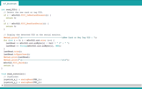

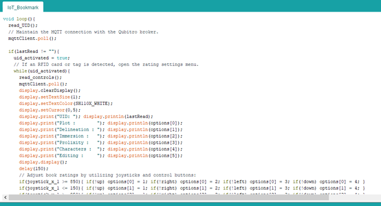

⭐ In the read_UID function, detect a new RFID card or tag UID.
⭐ Then, copy the detected UID to the lastRead string, process the lastRead string, and print it on the serial monitor.
int read_UID() {
  // Detect the new card or tag UID.
  if ( ! mfrc522.PICC_IsNewCardPresent()) {
    return 0;
  if ( ! mfrc522.PICC_ReadCardSerial()) {
    return 0;
  // Display the detected UID on the serial monitor.
  Serial.print("\n----------------------------------\nNew Card or Key Tag UID : ");
  for (int i = 0; i < mfrc522.uid.size; i++) {
    lastRead += mfrc522.uid.uidByte[i] < 0x10 ? " 0" : " ";
    lastRead += String(mfrc522.uid.uidByte[i], HEX);
  lastRead.trim();
  lastRead.toUpperCase();
  Serial.print(lastRead);
  Serial.print("\n----------------------------------\n\n");
  mfrc522.PICC_HaltA();
  return 1;
⭐ Maintain the MQTT connection with the Qubitro broker.
mqttClient.poll();
⭐ If an RFID card or tag UID is detected and stored, initiate the rating settings menu:
⭐ Display the detected UID and the current book ratings on the SH1106 OLED screen.
⭐ Then, adjust book ratings by utilizing joystick (first and second) movements and control buttons (up, right, left, and down).
⭐ If the second joystick's switch is pressed, create a string in the JSON format to transfer the detected UID and the adjusted book ratings to the Qubitro device:
  • UID
  • plot
  • delineation
  • immersion
  • prolixity
  • characters
  • editing
⭐ Then, send the given data packet to the Qubitro device via the Qubitro MQTT broker.
⭐ Finally, return to the home screen and clear the lastRead string (detected UID).
⭐ If the first joystick's switch is pressed, return to the home screen and clear the lastRead string (detected UID) without sending the data packet.
  if(lastRead != ""){
    uid_activated = true;
    // If an RFID card or tag is detected, open the rating settings menu.
    while(uid_activated){
      read_controls();
      mqttClient.poll();
      display.setTextSize(1);
      display.setTextColor(SH110X_WHITE);
      display.setCursor(0,5);
      display.print("UID: "); display.println(lastRead);
      display.print("Plot :        "); display.println(options[0]);
      display.print("Delineation : "); display.println(options[1]);
      display.print("Immersion :   "); display.println(options[2]);
      display.print("Prolixity :   "); display.println(options[3]);
      display.print("Characters :  "); display.println(options[4]);
      display.print("Editing :     "); display.println(options[5]);
      display.display();
      delay(150);
      // Adjust book ratings by utilizing joysticks and control buttons:
      if(joystick_x_1 >= 850){ if(!up) options[0] = 1; if(!right) options[0] = 2; if(!left) options[0] = 3; if(!down) options[0] = 4; }
      if(joystick_x_1 <= 150){ if(!up) options[1] = 1; if(!right) options[1] = 2; if(!left) options[1] = 3; if(!down) options[1] = 4; }
      if(joystick_y_1 >= 850){ if(!up) options[2] = 1; if(!right) options[2] = 2; if(!left) options[2] = 3; if(!down) options[2] = 4; }
      if(joystick_x_2 >= 850){ if(!up) options[3] = 1; if(!right) options[3] = 2; if(!left) options[3] = 3; if(!down) options[3] = 4; }
      if(joystick_x_2 <= 150){ if(!up) options[4] = 1; if(!right) options[4] = 2; if(!left) options[4] = 3; if(!down) options[4] = 4; }
      if(joystick_y_2 >= 850){ if(!up) options[5] = 1; if(!right) options[5] = 2; if(!left) options[5] = 3; if(!down) options[5] = 4; }
      // Send the given book ratings to the Qubitro device via the Qubitro MQTT broker.
      if(!joystick_sw_2){
       digitalWrite(control_led, HIGH);
       mqttClient.beginMessage(deviceID);
       // Create a string in the JSON format to transfer data to the Qubitro device successfully.
       mqttClient.print("{\"UID\":\"" + lastRead + "\",\"plot\":" + String(options[0]) + ",\"delineation\":" + String(options[1]) + ",\"immersion\":" + String(options[2]) + ",\"prolixity\":" + String(options[3]) + ",\"characters\":" + String(options[4]) + ",\"editing\":" + String(options[5]) + "}");
       mqttClient.endMessage();
       delay(3000);
       Serial.println("Message Sent!");
       // Exit and clear:
       lastRead = "";
       display.display();
       digitalWrite(control_led, LOW);
       uid_activated = false;
      // Exit and clear:
      if(!joystick_sw_1){
          lastRead = "";
          display.display();

🦇📗 After transferring data packets to the Qubitro device, the Qubitro portal lets the user visualize the book ratings on the monitoring dashboard, as explained in Step 3.2.
