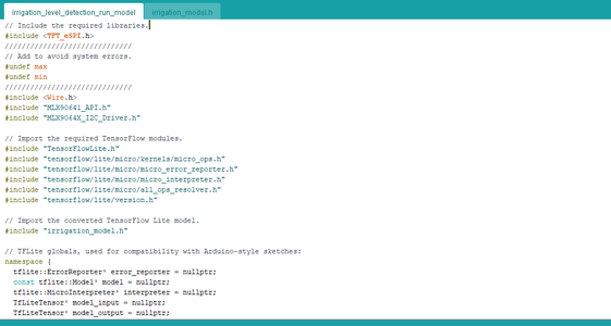

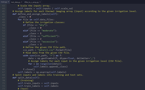

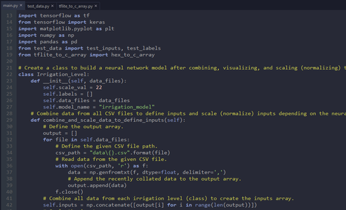

After completing my data set, I built my artificial neural network model (ANN) with TensorFlow to make predictions on the irrigation classes (labels) based on thermal imaging. Empirically, I assigned an irrigation class (label) for each thermal imaging array (input) generated by the MLX90641 thermal imaging camera:
  • Dry
  • Moderate
  • Sufficient
  • Excessive

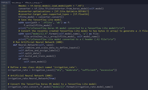

After training and testing my neural network model, I converted it from a TensorFlow Keras H5 model to a C array (.h file) to execute the model on the Wio Terminal. Since the thermal imaging camera is directly connected to the Wio Terminal, the device is capable of detecting irrigation levels (classes) in the field effortlessly.

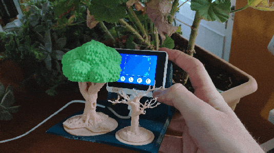

Lastly, to make the device as compact and robust as possible, I designed a forest-themed case (3D printable).
So, this is my project in a nutshell 😃

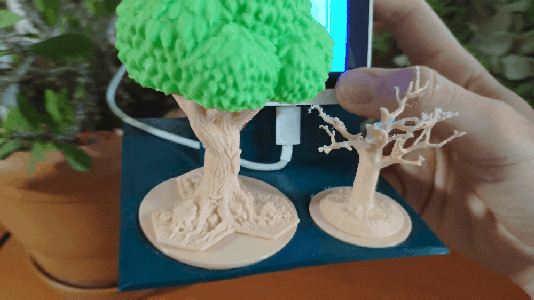

Step 2: Designing and Printing a Forest-themed Case
As a novice in 3D model designing and printing, I decided to design a forest-themed case for this project to create a more compact and robust device operating flawlessly in the field.
I designed the main case and tree bases in Autodesk Fusion 360. You can download their STL files below.
For trees mounted on the main case, I utilized these models from Thingiverse:
Since I wanted to apply a stylish forest theme to the device, I utilized three PLA filaments with different colors:
  • Green
  • Beige
  • Peak Green
I sliced 3D models (STL files) for each color above in Ultimaker Cura.
Finally, I printed all parts (models) with my Creality CR-6 SE 3D Printer. Although I am a beginner in 3D printing and it is my first 3D printer, I got incredible results effortlessly with the CR-6 SE :)
Step 3: Assembling the Case and Its Components
After printing all parts (models) successfully, I fastened them together and attached the Wio Terminal and the MLX90641 thermal imaging camera to the case. I used a Grove connection cable (4 Pin) to connect the Wio Terminal to the MLX90641 thermal imaging camera.

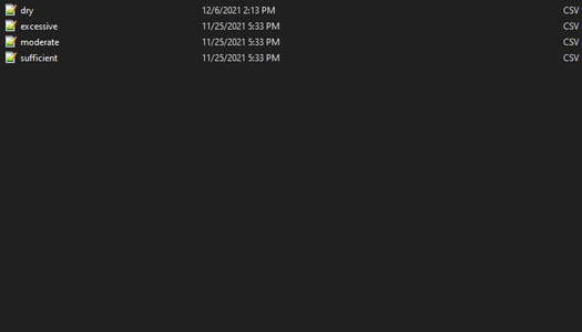

⭐ If the create_files parameter is received and equals ok, the web application creates the required CSV files (shown above) and prints recently created file names.
http://localhost/irrigation_level_data_logger/?create_files=ok
⭐ If the thermal_img (thermal imaging data) and level (CSV file name) parameters are received, the web application processes the given thermal imaging data as an array and inserts it into the given CSV file as a new row.
http://localhost/irrigation_level_data_logger/?thermal_img=<_data_>&level=<_file_name_>
⭐ Then, if the given thermal imaging data is inserted successfully, the application prints:
The given line is added to the <_file_name_>.csv file successfully!

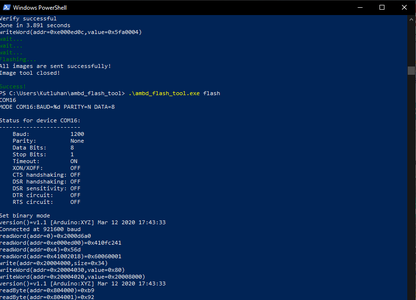

Since the Wio Terminal provides Wi-Fi connectivity via the built-in Wireless Core Realtek RTL8720, I employed the Wio Terminal to display and transfer the thermal imaging data generated by the MLX90641 thermal imaging camera. However, before proceeding with the following steps, I needed to update the Wireless Core Firmware to the latest version to enable wireless connectivity since Seeed moved the Wi-Fi software to the new eRPC structure. Fortunately, Seeed provides a tool named ambd_flash_tool to erase the existing firmware on the RTL8720 and also flash the latest firmware.
I updated the Wireless Core Firmware on Windows. You can get more information from here for Mac/ Linux.

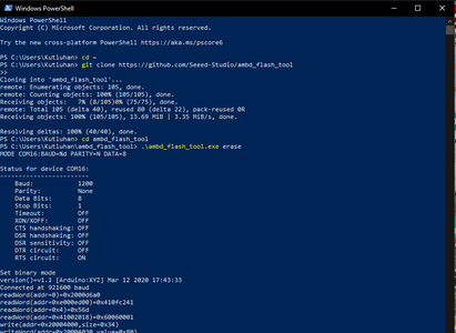

#️⃣ Open Windows PowerShell and execute the commands below to download the flashing tool.
cd ~
git clone https://github.com/Seeed-Studio/ambd_flash_tool
#️⃣ Navigate to the ambd_flash_tool directory:
cd ambd_flash_tool
#️⃣ Connect the Wio Terminal to the PC and turn it on.
#️⃣ Execute the following command to erase the initial firmware:
.\ambd_flash_tool.exe erase
#️⃣ After erasing the initial firmware, inside the ambd_flash_tool directory, execute the following command to flash the latest firmware to the RTL8720:
.\ambd_flash_tool.exe flash

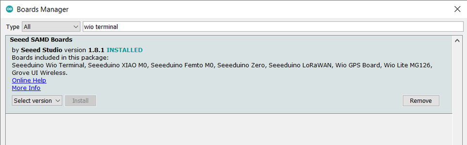

After updating the Wireless Core Firmware successfully, I installed the Seeed SAMD Arduino Core on the Arduino IDE and downloaded the required libraries for this project.
#️⃣ To set up the Seeed SAMD Arduino Core, open the Arduino IDE, click Tools ➡ Board ➡ Boards Manager, and search for Wio Terminal in the search box. Then, install Seeed SAMD Boards.

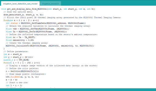

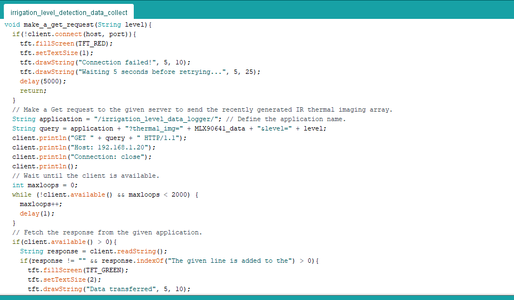

Step 8: Collecting and Transferring Irrigation Level Data by Thermal Imaging W/ Wio Terminal

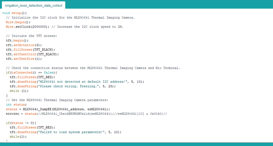

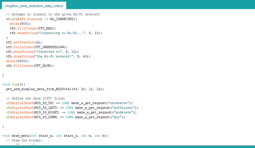

After setting up the Wio Terminal and enabling Wi-Fi connectivity, I programmed the Wio Terminal to send the thermal imaging data generated by the MLX90641 thermal imaging camera to the web application.
Since I needed to assign irrigation classes (labels) empirically for each thermal imaging array (input) to create a data set, I utilized the 5-way switch integrated into the Wio Terminal to choose among irrigation classes. After selecting an irrigation class, the Wio Terminal sends thermal imaging data (array) to the web application, and the web application saves the transferred data to the chosen class' CSV file:
  • Up ➡ Excessive
  • Left ➡ Sufficient
  • Right ➡ Moderate
  • Down ➡ Dry
You can download the irrigation_level_detection_data_collect.ino file to try and inspect the code for thermal imaging data collecting with Wio Terminal.
⭐ Include the required libraries.
#include <rpcWiFi.h>
#include <TFT_eSPI.h>
#include <Wire.h>
#include "MLX90641_API.h"
#include "MLX9064X_I2C_Driver.h"
⭐ Define the Wi-Fi network settings and use the WiFiClient class to create TCP connections.
const char* ssid = "<_SSID_>";
const char* password =  "<_PASSWORD_>";
// Define the server settings:
const uint16_t port = 80; // Default port
const char* host = "192.168.1.20";  // Target Server IP Address
// Use the WiFiClient class to create TCP connections:
WiFiClient client;
⭐ Define the MLX90641 thermal imaging camera settings.
⭐ Define the maximum and minimum temperature values.
const byte MLX90641_address = 0x33; // Default 7-bit unshifted address of the MLX90641.
#define TA_SHIFT 12 // Default shift value for MLX90641 in the open air.
uint16_t eeMLX90641[832];
float MLX90641To[192];
uint16_t MLX90641Frame[242];
paramsMLX90641 MLX90641;
int errorno = 0;
// Define the maximum and minimum temperature values:
uint16_t MinTemp = 21;
uint16_t MaxTemp = 45;
⭐ Initialize the I2C clock for the MLX90641 thermal imaging camera.
  Wire.begin();
  Wire.setClock(2000000); // Increase the I2C clock speed to 2M.
⭐ Initiate the TFT screen.
  tft.begin();
  tft.setRotation(3);
  tft.fillScreen(TFT_BLACK);
  tft.setTextColor(TFT_BLACK);
  tft.setTextSize(1);
⭐ Check the connection status between the MLX90641 thermal imaging camera and the Wio Terminal.
  if(isConnected() == false){
    tft.fillScreen(TFT_RED);
    tft.drawString("MLX90641 not detected at default I2C address!", 5, 10);
    tft.drawString("Please check wiring. Freezing.", 5, 25);
    while (1);
⭐ Get the MLX90641 thermal imaging camera parameters. Once params are extracted, release the eeMLX90641 array.
  MLX90641_SetRefreshRate(MLX90641_address, 0x05); // Set rate to 16Hz.

⭐ Set the Wi-Fi module to station mode and disconnect from an AP if it was previously connected.
⭐ Attempt to connect to the given Wi-Fi network.
  WiFi.mode(WIFI_STA);
  WiFi.disconnect();
  delay(2000);
  WiFi.begin(ssid, password);
  // Attempt to connect to the given Wi-Fi network:
  while(WiFi.status() != WL_CONNECTED){
    delay(500);
    tft.drawString("Connecting to Wi-Fi...", 5, 10);
  tft.setTextSize(2);
  tft.fillScreen(TFT_GREENYELLOW);
  tft.drawString("Connected to", 5, 10);
  tft.drawString("the Wi-Fi network!", 5, 40);
  delay(3000);
  tft.fillScreen(TFT_BLUE);

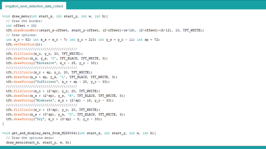

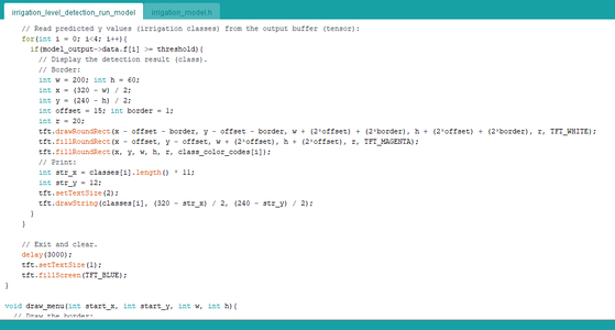

⭐ In the draw_menu function, draw the irrigation class options (Up, Left, Right, Down) and the border of the simple image generated from the thermal imaging array (16x12).
void draw_menu(int start_x, int start_y, int w, int h){
  // Draw the border:
  int offset = 10;
  tft.drawRoundRect(start_x-offset, start_y-offset, (2*offset)+(w*16), (2*offset)+(h*12), 10, TFT_WHITE);
  // Draw options:
  int x_c = 52; int x_s = x_c - 7; int y_c = 210; int y_s = y_c - 11; int sp = 72;
  tft.setTextSize(1);
  tft.fillCircle(x_c, y_c, 20, TFT_WHITE);
  tft.drawChar(x_s, y_s, 'U', TFT_BLACK, TFT_WHITE, 3);
  tft.drawString("Excessive", x_c - 25, y_c - 33);
  tft.fillCircle(x_c + sp, y_c, 20, TFT_WHITE);
  tft.drawChar(x_s + sp, y_s, 'L', TFT_BLACK, TFT_WHITE, 3);
  tft.drawString("Sufficient", x_c + sp - 28, y_c - 33);
  tft.fillCircle(x_c + (2*sp), y_c, 20, TFT_WHITE);
  tft.drawChar(x_s + (2*sp), y_s, 'R', TFT_BLACK, TFT_WHITE, 3);
  tft.drawString("Moderate", x_s + (2*sp) - 16, y_c - 33);
  tft.fillCircle(x_c + (3*sp), y_c, 20, TFT_WHITE);
  tft.drawChar(x_s + (3*sp), y_s, 'D', TFT_BLACK, TFT_WHITE, 3);
  tft.drawString("Dry", x_c + (3*sp) - 8, y_c - 33);
⭐ In the get_and_display_data_from_MLX90641 function, after executing the draw_menu function, elicit the 16x12 pixel IR thermal imaging array generated by the MLX90641 thermal imaging camera:
⭐ Obtain the required variables to calculate the thermal imaging array.
⭐ Define the reflected temperature based on the sensor's ambient temperature.
⭐ Create the thermal imaging array.
⭐ Then, convert the 16x12 pixel IR thermal imaging array to string (MLX90641_data) so as to transfer it to the web application.
⭐ To display a simple image version of the recently generated thermal imaging array (16x12) on the screen, assign colors for each element (pixel) in the array by using the GetColor function.
⭐ Finally, draw each pixel (rectangle) to create a simple image version of the given thermal imaging array.
void get_and_display_data_from_MLX90641(int start_x, int start_y, int w, int h){
  // Draw the options menu:
  draw_menu(start_x, start_y, w, h);
  // Elicit the 16x12 pixel IR thermal imaging array generated by the MLX90641 Thermal Imaging Camera:
  for(byte x = 0 ; x < 2 ; x++){
    int status = MLX90641_GetFrameData(MLX90641_address, MLX90641Frame);
    // Obtain the required variables to calculate the thermal imaging array:
    float vdd = MLX90641_GetVdd(MLX90641Frame, &MLX90641);
    float Ta = MLX90641_GetTa(MLX90641Frame, &MLX90641);
    // Define the reflected temperature based on the sensor's ambient temperature:
    float tr = Ta - TA_SHIFT;
    float emissivity = 0.95;
    // Create the thermal imaging array:
    MLX90641_CalculateTo(MLX90641Frame, &MLX90641, emissivity, tr, MLX90641To);
  // Define parameters:
  MLX90641_data = "";
  int x = start_x;
  int y = start_y + (h*11);
  uint32_t c = TFT_BLUE;
  for(int i = 0 ; i < 192 ; i++){
    // Convert the 16x12 pixel IR thermal imaging array to string (MLX90641_data) so as to transfer it to the web application:
    MLX90641_data += String(MLX90641To[i]);
    if(i != 191) MLX90641_data += ",";
    // Display a simple image version of the collected data (array) on the screen:
    // Define the color palette:
    c = GetColor(MLX90641To[i]);
    // Draw image pixels (rectangles):
    tft.fillRect(x, y, w, h, c);
    x = x + w;
    // Start a new row:
    int l = i + 1;
    if (l%16 == 0) { x = start_x; y = y - h; }

⭐ In the make_a_get_request function, make a Get request to the given server to send the recently generated IR thermal imaging array to the given web application (irrigation_level_data_logger).
⭐ Wait until the client is available, then fetch the response from the given application.
⭐ If the web application saves the transferred thermal imaging data (array) to the chosen irrigation class' CSV file, then print the message below, including the CSV file name:
Data transferred successfully to the web application!
<file_name>.csv
void make_a_get_request(String level){
  if(!client.connect(host, port)){
    tft.setTextSize(1);
    tft.drawString("Connection failed!", 5, 10);
    tft.drawString("Waiting 5 seconds before retrying...", 5, 25);
    delay(5000);
    return;
  // Make a Get request to the given server to send the recently generated IR thermal imaging array.
  String application = "/irrigation_level_data_logger/"; // Define the application name.
  String query = application + "?thermal_img=" + MLX90641_data + "&level=" + level;
  client.println("GET " + query + " HTTP/1.1");
  client.println("Host: 192.168.1.20");
  client.println("Connection: close");
  client.println();
  // Wait until the client is available.
  int maxloops = 0;
  while (!client.available() && maxloops < 2000) {
    maxloops++;
    delay(1);
  // Fetch the response from the given application.
  if(client.available() > 0){
    String response = client.readString();
    if(response != "" && response.indexOf("The given line is added to the") > 0){
      tft.fillScreen(TFT_GREEN);
      tft.setTextSize(2);
      tft.drawString("Data transferred", 5, 10);
      tft.drawString("successfully", 5, 40);
      tft.drawString("to the web application! ", 5, 70);
      tft.setTextSize(3);
      tft.drawString(level + ".csv", 5, 130);
  }else{
    tft.setTextSize(2);
    tft.drawString("Client Timeout!", 5, 10);
  // Stop the client:
  client.stop();
  delay(3000);
⭐ According to the movement of the 5-way switch (Up, Left, Right, Down), send the recently generated thermal imaging array with the chosen irrigation class name to the web application.
  get_and_display_data_from_MLX90641(64, 20, 12, 12);
  // Define the data (CSV) files:
  if(digitalRead(WIO_5S_UP) == LOW) make_a_get_request("excessive");
  if(digitalRead(WIO_5S_LEFT) == LOW) make_a_get_request("sufficient");
  if(digitalRead(WIO_5S_RIGHT) == LOW) make_a_get_request("moderate");
  if(digitalRead(WIO_5S_DOWN) == LOW) make_a_get_request("dry");

To train my neural network model so as to make predictions on the irrigation levels (classes) based on thermal imaging, I needed to create a data set with eminent validity. Therefore, I utilized the device to collect thermal imaging data from my plants with different irrigation levels for over one month.
Finally, I had a data set with 1264 inputs in total under these CSV files in the web application:
  • dry.csv
  • moderate.csv
  • sufficient.csv
  • excessive.csv

First of all, I created a class named Irrigation_Level in the main.py file to execute the following functions precisely.
⭐ Include the required modules.
import tensorflow as tf
from tensorflow import keras
import matplotlib.pyplot as plt
import numpy as np
import pandas as pd
from test_data import test_inputs, test_labels
from tflite_to_c_array import hex_to_c_array
⭐ In the __init__ function, define the required variables for building the neural network model.
    def __init__(self, data_files):
        self.scale_val = 22
        self.labels = []
        self.data_files = data_files
        self.model_name = "irrigation_model"
I will elucidate each file and function in detail in the following steps.

    def combine_and_scale_data_to_define_inputs(self):
        # Define the output array.
        output = []
        for file in self.data_files:
            # Define the given CSV file path.
            csv_path = "data\{}.csv".format(file)
            # Read data from the given CSV file.
            with open(csv_path, 'r') as f:
                data = np.genfromtxt(f, dtype=float, delimiter=',')
                # Append the recently collated data to the output array.
                output.append(data)
            f.close()
        # Combine all data from each irrigation level (class) to create the inputs array.
        self.inputs = np.concatenate([output[i] for i in range(len(output))])
        # Scale the inputs array.
        self.inputs = self.inputs / self.scale_val

⭐ In the define_and_assign_labels function, define irrigation classes for each CSV file in the given file list:
  • 0 — Dry
  • 1 — Moderate
  • 2 — Sufficient
  • 3 — Excessive
⭐ Read data from all CSV files.
⭐ For each thermal imaging array (input) in a given CSV file, append its assigned label (irrigation class) [0 - 3] to the labels array.
⭐ Then, convert the labels array to a NumPy array by using the asarray function.
    def define_and_assign_labels(self):
        _class = 0
            # Define the irrigation classes:
            if (file == "dry"):
                _class = 0
            elif (file == "moderate"):
                _class = 1
            elif (file == "sufficient"):
                _class = 2
            elif (file == "excessive"):
                _class = 3
                # Assign labels for each input in the given irrigation level (CSV file).
                for i in range(len(data)):
                    self.labels.append(_class)
            f.close()
        self.labels = np.asarray(self.labels)

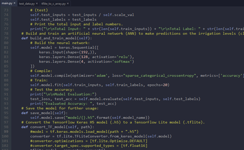

Then, I built my artificial neural network model (ANN) by using Keras and trained it with the training set for twenty epochs.
You can inspect these tutorials to learn about activation functions, loss functions, epochs, etc.
    def build_and_train_model(self):
        # Build the neural network:
        self.model = keras.Sequential([
            keras.Input(shape=(192,)),
            keras.layers.Dense(128, activation='relu'),
            keras.layers.Dense(4, activation='softmax')
        # Compile:
        self.model.compile(optimizer='adam', loss="sparse_categorical_crossentropy", metrics=['accuracy'])
        # Train:
        self.model.fit(self.train_inputs, self.train_labels, epochs=20)
After training with the training set (1264 inputs and labels), the accuracy of my neural network model is between 0.93 and 0.97.
Step 13: Evaluating the Model Accuracy and Converting the Model to a C Array
After building and training my artificial neural network model, I tested its accuracy and validity by utilizing the testing data set (inputs and labels).
The evaluated accuracy of the model is 0.9167.
        # Test the accuracy:
        print("\n\nModel Evaluation:")
        test_loss, test_acc = self.model.evaluate(self.test_inputs, self.test_labels)
        print("Evaluated Accuracy: ", test_acc)
After evaluating my neural network model, I saved it as a TensorFlow Keras H5 model (irrigation_model.h5) to the model folder.
    def save_model(self):
        self.model.save("model/{}.h5".format(self.model_name))
However, running a TensorFlow Keras H5 model on the Wio Terminal to make predictions on the irrigation levels (classes) is not eligible and efficient considering size, latency, and power consumption.

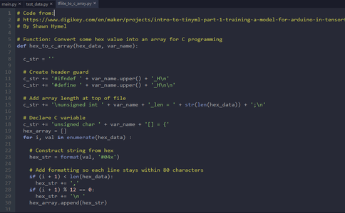

To alter the TensorFlow Lite model to a C array, I applied the hex_to_c_array function copied directly from this tutorial to the tflite_to_c_array.py file.
⭐ In the convert_TF_model function, convert the recently trained and evaluated model to a TensorFlow Lite model by applying the TensorFlow Lite converter(tf.lite.TFLiteConverter.from_keras_model).
⭐ Then, save the converted TensorFlow Lite model (irrigation_model.tflite) to the model folder.
⭐ Modify the recently created TensorFlow Lite model to a C array (.h file) by executing the hex_to_c_array function.
⭐ Finally, save the converted C array (irrigation_model.h) to the model folder.
    def convert_TF_model(self, path):
        #model = tf.keras.models.load_model(path + ".h5")
        converter = tf.lite.TFLiteConverter.from_keras_model(self.model)
        #converter.optimizations = [tf.lite.Optimize.DEFAULT]
        #converter.target_spec.supported_types = [tf.float16]
        tflite_model = converter.convert()
        # Save the TensorFlow Lite model.
        with open(path + '.tflite', 'wb') as f:
            f.write(tflite_model)
        print("\r\nTensorFlow Keras H5 model converted to a TensorFlow Lite model!\r\n")
        # Convert the recently created TensorFlow Lite model to hex bytes (C array) to generate a .h file string.
        with open("model/{}.h".format(self.model_name), 'w') as file:
            file.write(hex_to_c_array(tflite_model, self.model_name))
        print("\r\nTensorFlow Lite model converted to a C header (.h) file!\r\n")

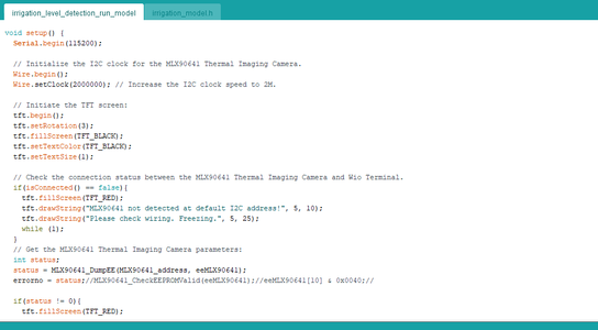

Step 14: Setting Up the Model on Wio Terminal
After building, training, and converting my neural network model to a C array (.h file), I needed to upload and run the model directly on the Wio Terminal so as to create an easy-to-use device without any dependencies.
Fortunately, there is an official library provided by TensorFlow to run inferences on microcontrollers with the TensorFlow Lite models converted to C arrays. Although, for now, it only supports a few development boards, including the Wio Terminal, it is a fast and efficient library for running basic neural network models on microcontrollers. Since TensorFlow Lite for Microcontrollers does not require operating system support, any standard C or C++ libraries, or dynamic memory allocation, the Wio Terminal can detect irrigation levels (classes) without needing Wi-Fi connectivity.
⭐ To download the TensorFlow Lite library on the Arduino IDE, go to Sketch ➡ Include Library ➡ Manage Libraries… and search for TensorFlow. Then, install the latest version of the Arduino_TensorFlowLite library.
After installing the TensorFlow Lite library on the Arduino IDE, I needed to import my neural network model modified as a C array (irrigation_model.h) to run inferences.
⭐ To import the converted C array (.h file), go to Sketch ➡ Add File...
After importing the converted C array (.h file) successfully to the Arduino IDE, I modified the code in this tutorial from TensorFlow to run my neural network model. I utilized the 5-way switch integrated into the Wio Terminal to run inference to detect irrigation levels (classes):
  • Press ➡ Run Inference
You can download the irrigation_level_detection_run_model.ino file to try and inspect the code for running TensorFlow Lite neural network models on Wio Terminal.
⭐ Since the min and max functions defined for the Wio Terminal are also defined in the TensorFlow Lite library, add #undef max and #undef min to avoid compile errors.
// Add to avoid system errors.
#undef max
#undef min
#include <Wire.h>
⭐ Import the required TensorFlow modules.
#include "TensorFlowLite.h"
#include "tensorflow/lite/micro/kernels/micro_ops.h"
#include "tensorflow/lite/micro/micro_error_reporter.h"
#include "tensorflow/lite/micro/micro_interpreter.h"
#include "tensorflow/lite/micro/all_ops_resolver.h"
#include "tensorflow/lite/version.h"
⭐ Include the TensorFlow Lite model modified as a C array (.h file).
⭐ Define the TFLite globals used for compatibility with Arduino-style sketches.
⭐ Create an area of memory to use for input, output, and other TensorFlow arrays.
#include "irrigation_model.h"
// TFLite globals, used for compatibility with Arduino-style sketches:
namespace {
  tflite::ErrorReporter* error_reporter = nullptr;
  const tflite::Model* model = nullptr;
  tflite::MicroInterpreter* interpreter = nullptr;
  TfLiteTensor* model_input = nullptr;
  TfLiteTensor* model_output = nullptr;
  // Create an area of memory to use for input, output, and other TensorFlow arrays.
  constexpr int kTensorArenaSize = 15 * 1024;
  uint8_t tensor_arena[kTensorArenaSize];
} // namespace
⭐ Define the threshold value for the model outputs (results).
⭐ Define the irrigation level (class) names and color codes:
  • Dry ➡ Green
  • Moderate ➡ Greenyellow
  • Sufficient ➡ Orange
  • Excessive ➡ Red
float threshold = 0.75;
// Define the irrigation level (class) names and color codes:
String classes[] = {"Dry", "Moderate", "Sufficient", "Excessive"};
uint32_t class_color_codes[] = {TFT_GREEN, TFT_GREENYELLOW, TFT_ORANGE, TFT_RED};
int errorno = 0;
  Wire.begin();
  tft.begin();
  tft.setRotation(3);
  tft.setTextSize(1);
    while (1);

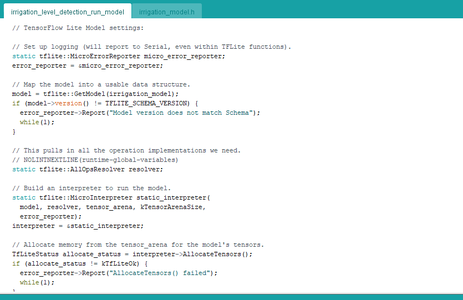

⭐ Define the TensorFlow Lite model settings:
⭐ Set up logging (will report to Serial, even within TFLite functions).
⭐ Map the model into a usable data structure.
  static tflite::MicroErrorReporter micro_error_reporter;
  error_reporter = &micro_error_reporter;
  // Map the model into a usable data structure.
  model = tflite::GetModel(irrigation_model);
  if (model->version() != TFLITE_SCHEMA_VERSION) {
    error_reporter->Report("Model version does not match Schema");
    while(1);
⭐ Pull all the operation implementations.
⭐ Build an interpreter to run the model.
  // This pulls in all the operation implementations we need.
  // NOLINTNEXTLINE(runtime-global-variables)
  static tflite::AllOpsResolver resolver;
  // Build an interpreter to run the model.
  static tflite::MicroInterpreter static_interpreter(
    model, resolver, tensor_arena, kTensorArenaSize,
    error_reporter);
  interpreter = &static_interpreter;
⭐ Allocate memory from the tensor_arena for the model's tensors.
⭐ Assign model input and output buffers (tensors) to pointers.
  TfLiteStatus allocate_status = interpreter->AllocateTensors();
  if (allocate_status != kTfLiteOk) {
    error_reporter->Report("AllocateTensors() failed");
    while(1);
  // Assign model input and output buffers (tensors) to pointers.
  model_input = interpreter->input(0);
  model_output = interpreter->output(0);
⭐ In the draw_menu function, draw the run inference option (Press) and the border of the simple image generated from the thermal imaging array (16x12).
  // Draw the border:
  int offset = 10;
  // Draw options:
  int x_c = 320 / 2; int x_s = x_c - 7; int y_c = 210; int y_s = y_c - 11;
  tft.setTextSize(1);
  tft.drawChar(x_s, y_s, 'P', TFT_BLACK, TFT_WHITE, 3);
  tft.drawString("'Press' to run the NN model", x_c - 80, y_c - 33);
⭐ Create the thermal imaging array - MLX90641To.
  int x = start_x;
    x = x + w;
    // Start a new row:
    int l = i + 1;
⭐ In the run_inference_to_make_predictions function:
⭐ Initiate the results (outputs) screen.
⭐ Copy the recently generated thermal imaging array (MLX90641To) to the input buffer (tensor).
⭐ Run inference.
⭐ Read predicted y values (irrigation classes) from the output buffer (tensor).
⭐ Display the detection result greater than the given threshold (0.75). It represents the most accurate label (irrigation class) predicted by the model.
void run_inference_to_make_predictions(){
    // Initiate the results screen.
    tft.fillScreen(TFT_PURPLE);
    // Copy values (thermal imaging array) to the input buffer (tensor):
    for(int i = 0; i < 192; i++){
      model_input->data.f[i] = MLX90641To[i];
    // Run inference:
    TfLiteStatus invoke_status = interpreter->Invoke();
    if (invoke_status != kTfLiteOk) {
      error_reporter->Report("Invoke failed on the given input.");
    // Read predicted y values (irrigation classes) from the output buffer (tensor):
    for(int i = 0; i<4; i++){
      if(model_output->data.f[i] >= threshold){
        // Display the detection result (class).
        // Border:
        int w = 200; int h = 60;
        int x = (320 - w) / 2;
        int y = (240 - h) / 2;
        int offset = 15; int border = 1;
        int r = 20;
        tft.drawRoundRect(x - offset - border, y - offset - border, w + (2*offset) + (2*border), h + (2*offset) + (2*border), r, TFT_WHITE);
        tft.fillRoundRect(x - offset, y - offset, w + (2*offset), h + (2*offset), r, TFT_MAGENTA);
        tft.fillRoundRect(x, y, w, h, r, class_color_codes[i]);
        // Print:
        int str_x = classes[i].length() * 11;
        int str_y = 12;
        tft.setTextSize(2);
        tft.drawString(classes[i], (320 - str_x) / 2, (240 - str_y) / 2);
    // Exit and clear.
    delay(3000);
    tft.setTextSize(1);

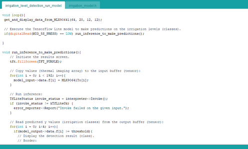

⭐ If the 5-way switch is pressed, run inference to detect irrigation levels (classes).
 // Execute the TensorFlow Lite model to make predictions on the irrigation levels (classes).
 if(digitalRead(WIO_5S_PRESS) == LOW) run_inference_to_make_predictions();
In Step 4, you can inspect GetColor and Getabcd functions in detail.

After importing and setting up the model (as a C array) on the Wio Terminal successfully, I run the model to detect irrigation levels (classes) of various plants in my garden and balcony.
After executing the code for running the model on the Wio Terminal:
🌿💧 The device displays thermal imaging arrays as a real-time video stream on the screen.
🌿💧 If the 5-way switch is pressed, the device runs inference with the model by employing the most recently generated thermal imaging array as the input array.
🌿💧 Then, the device displays the output, which represents the most accurate label (irrigation class) predicted by the model.
🌿💧 Each irrigation level (class) as the output has its unique color code:
  • Dry ➡ Green
  • Excessive ➡ Red
🌿💧 As far as my experiments go, the device works impeccably while detecting irrigation levels (classes) of various plants in different conditions :)
