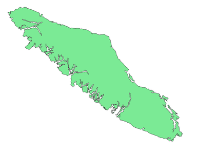

Sourcing vector data
I got my vector data (first image) from a map of the health authorities in British Columbia here. This data covers the whole province, so I used QGIS to strip off the parts that I didn't want to include in my map. You can often find vector data for your area of interest by searching through government open data repositories. In the US and Canada (and likely other countries!), census data often includes detailed boundary files at varying scales.
If you want your area of interest to just be a basic shape instead of using a specified border, you can create that in QGIS and don't need to download any vector data.

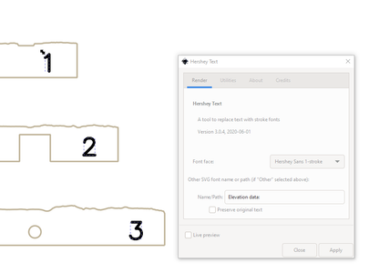

Step 4: Individual Map Pieces
Each piece of the map looks something like this image and consists of 5 basic parts:
  • Ridgeline: The elevation profile for the piece.
  • Baseline: The bottom of the piece that creates a closed shape to send to the laser cutter.
  • Threaded rod hole: Each piece will have at least one hole in it for threaded rod to pass through to align and hold all of the pieces together.
  • Nut notch: Not every piece will have one of these. Only the ones on the ends of each threaded rods need a notch for the nut to fit in.
  • Label: The label isn't strictly necessary (especially if your map only has a few pieces), but is super helpful for making sure everything is in the right order. The label will be created in QGIS and edited in Inkscape.

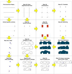

Step 5: Overview of the Process
These images show a generalized overview of the steps used to create the map. I've labeled each part with the appropriate step in the Instructable so you can quickly reference what you're working on. I tried to make it as easy to follow as possible with the arrows, but it can be a bit confusing since some intermediate steps are used multiple times to create future layers. In a lot of the steps, the overview just shows a single line or shape, but it's important to know that QGIS will be doing the operation to all of the pieces of the project at once.
In QGIS, almost every process that you run creates a new temporary layer by default, meaning that the layer is not saved after the program is closed or crashes. I generally don't keep all of the intermediate layers when I'm done with a project, but it can be good practice to do so if you're worried about losing your progress. I will be renaming my layers as I go though to make sure I know what each one is doing!
If you make a mistake somewhere along the line, don't worry! It's easy to delete layers (right-click on the layer and click "Remove Layer...") then try again.

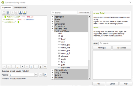

Step 17: Translate Points
Why?
To make the points look like mountain ridgelines, we need to shift them up based on their sampled elevation value. We can do this using the "Translate" tool.
How?
When doing this step, you need to think about how tall you want your physical map to be. The vertical scale of 3D maps is often exaggerated to show the terrain in more detail, so it's good to plan for that. You can do this in one of two ways:
  • Simple scale: By doing this, you just multiply the elevation parameter by a single value and see if you think it looks good.
  • Set height: If you have a maximum height in mind that you want your physical map to be, you can find your maximum elevation value and calculate the multiplication factor you'd need to reach your desired height. This is the method that I'll use and will explain how it's done below.

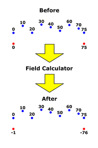

In addition to increasing the elevation of most points, you may also want to consider decreasing the elevation of points that are over water. In my case, there are some inlets that I'd like to reduce the elevation of in order to make the edges of these areas more well-defined. By lowering them by 0.3mm, it will create a clearer edge to differentiate the land from the water.
Translate tool
In the Translate tool, click on the menu to the right side of the "Offset distance (y-axis)" parameter and select "Edit". What this does is allow you to use an equation to define the amount of translation, rather than just using a set value for each feature.
An expression bar will come up and you can use simple math operators or more complex conditional equations. In my case, I want to set a few conditions:
  • If the sampled elevation is equal to or less than 0, I want to shift it down by 0.3mm, which in map units is:
1470.3 x 0.3 = 441.12 meters
  • I want the maximum height of the physical map to be 4mm, which in map units is
4mm x 1470.4m/mm = 5881.6 meters
  • So I want to scale the maximum sampled elevation by a factor k such that the translated value ends up being 5881.6 meters:
maximum sampled elevation (for all points) x k = 5881.6
Therefore
k = 5881.6/maximum sampled elevation
  • I'll then use the parameter k to scale every other elevation as well such that
translated value (for each point) = sampled elevation x k
so
translated value = sampled elevation x 5881.6/maximum sampled elevation
  • So if the sampled elevation is less than or equal to zero, translate the point down by 441.12 meters, otherwise move it up by the sampled elevation times the k parameter.
  • The full expression that we want to use then is:
if("elevation_1"<=0,-441.12,"elevation_1"*5881.6/maximum("elevation_1"))
  • You can either type "elevation_1" in with quotation marks, or select it from the "Fields and Values" menu in the expression editor. Make sure you use the maximum function and not just a max function, since the maximum function looks through all of the features to find the highest value while the max function does not.
  • From what I understand, the maximum function was introduced in QGIS 3. If you don't have the function, you can calculate the k parameter by hand by sorting by elevation in the attribute table of the sampled points layer to find the maximum sampled elevation value.
  • Check the preview to make sure that your function is valid. Check for missing quotation marks, commas, or parentheses if it says the expression isn't valid!

Step 19: More Extracted Vertices and Field Calculating!
It may seem silly that we're using points to represent the border of each of our map pieces, but it's very easy to merge point layers then make QGIS connect the dots to make outlines.
With the translated layer that you just created, use the "Extract Vertices" tool to get the endpoints. I'm going to name this layer "baseline_points".
Why?
Thinking ahead, we'll need to merge this layer with the translated sampled points layer in order to use the Points to Path tool to create a full boundary. Recall that this tool requires an order field for QGIS to follow so it knows which points to connect.
Both of the point layers that we'll be merging have a "distance" field. In both of these layers, the value of that field starts at 0 and increases as it moves to the right. In the third image, you can see a basic example of how this works.
To force QGIS to follow the points clockwise or counterclockwise, I'm going to modify the values of the points in the baseline points layer to make them negative. I'll do this with a tool called the field calculator.
How?
Select the baseline points layer, then click on the "Open Field Calculator" icon.
In the field calculator:
  • Select "Update existing field" and select the "distance" field.
  • In the expression window, use an equation like:
("distance"+1)*-1
  • This equation will take the 0 value and turn it into a -1 and will change the other distance value to a more negative number. Now when QGIS connects the dots, it will start at the right baseline point then progress clockwise around.
  • Note that when you run the field calculator, it will automatically turn on layer editing, so you'll need to turn that off again when you're finished.

Step 36: Convert Text to Single Lines [Optional]
This is an optional step for converting text to single lines to make them faster to cut on the laser cutter and will only work in Inkscape 1.0 and higher. If you don't do this step, you should change your QGIS export settings to export text as paths so that the laser cutter software will import it properly.
Most laser cutter software has an option to either fill areas or just cut in a straight line. The fill function works like a printer, where the laser cutter head passes back and forth and the laser turns on and off rapidly to create solid areas. This process works great and can be used to create text, but can take a rather long time, especially if you have a large map.
Alternatively, we can trace the outlines of the text shapes. This can also be time-consuming, however, and may create unreadable text if the features are too small.
In my opinion, the best way to do things is to convert text to so-called Hershey Text, which uses a single stroke to represent text characters. It took me quite a while to figure out how to do this, but I think it's worth it!
Creating Hershey Text
  • Download the Hershey Text extension for Inkscape.
  • Save your map as a .svg file and close Inkscape.
  • Open the .svg file in a text editor, such as Notepad++
  • In the file, search for 'x="0 ' (without the single quotes, so 0 followed by a space).
    • The way that the file is saved from QGIS sets the start point of each character separated by a space. So a two-digit number (10-99) will have x="0 n", where n is the spacing value. A three digit number (from what I understand) will have x="0 n 2n".
    • The Hershey Text extension doesn't like multiple values in the x= parameter, so we need to change them all to just x="0"
    • To do this, use the find and replace function of your text editor. Start with the longest-digit numbers. So in my case:
      • The pattern is x="0 8 16" for 100 (the only three-digit number in my file), so I'll do find and replace x="0 8 16" with x="0"
      • For two-digit number, I'll find x="0 8" and replace with x="0" as well.
  • Resave the .svg file in your text editor and close it.
  • Re-open the file in Inkscape.
  • Click on any one of the text items in Inkscape.
  • In the Edit menu, click Select Same>Fill and Stroke to select all of the text elements.
  • With the text selected, click Extensions>Text>Hershey Text
    • Use the default settings and hit Apply
  • The difference might not be super obvious, but the text is now just represented by a single stroke!

I find this process to be one of the most tedious parts of the whole thing, but it's nice to do to try and use as little material as possible for the cutting.
Sometimes it's easiest to visualize things in Inkscape by changing the view to just see the outlines of each piece rather than the colored stroke lines. To change the view, click View>Display Mode>Outline
Check alignment
Make sure that your labels will all be covered by the pieces in front of them. If needed, shift the labels to the left or right to make sure that they'll be hidden. You should also delete the label on your last piece so that it doesn't show up! Do this before shifting things around otherwise you won't be able to easily see how the pieces line up!
Grouping shapes
To group the shapes, I select one set of lines/holes/labels at a time, then hit Ctrl+G to group them. Now I can move the whole map piece around and it will be treated as a single item in Inkscape.
Creating a boundary
I create a boundary based on the size of the material that I'm going to be cutting. In my case, I'll be cutting using 12"x12" squares. In Inkscape, I create a box that's a little smaller than that to give myself a little bit of wiggle room.
Rearranging
Shift each map piece around to try and fit as many as possible in your boundary. I ended up fitting everything in two squares.
Sending to laser cutter
Most laser cutter software accepts .svg files for import, so just save the completed .svg file from Inkscape. One thing that will probably make things easier is ensuring that the stroke color of the labels and the outlines/holes are different. That way, the laser cutter software should separate them into different cut layers. You'll want to use a very fast cutting speed and low power for the labels so they don't cut through the wood!
