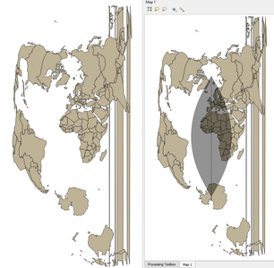

A physical globe is generally made up of a number of gores that are lined up next to each other to make a sphere. My initial thought was that I could take an image like this and just use image editing software to separate it into sections and work with those, but that felt like it would be a one-off thing rather than a repeatable (and educational!) project.
After spending and inordinate amount of time browsing stackexchange for solutions to create a set of map gores in QGIS, I stumbled on this really informative question and answers and specifically Marcin Ciura's link to his Quora post where he mentions the benefits of the Cassini projection. Searching for more about the Casssini projection led me to find some inspiration for the basic construction strategy from this project by Spyridon Staridas and this one from Esri employee John Nelson. Both of these projects utilize the commercial ArcGIS software, so my goal was to figure out how to make things work in QGIS.
This photo shows this map projection in QGIS using the Natural Earth 110m Land Vector. The vectors on the Natural Earth site are in the public domain so they're free to use for any purpose. I'll be using the 110m set to delineate the land border areas for my globe. This map provides only a rough outline of land areas, but that's perfect for this globe as it simplifies what will be cut with the laser later on.
At first look, the Cassini projection is super wonky and doesn't really make any sense (especially bad in this view where Indonesia happens to cross the bottom border and jumps to the top of the map). But if you focus solely on the central portion between the two poles, you can see that the map really doesn't seem distorted at all and actually looks like one of the gores that we want to make! The shaded area shown on the right side of the photo ranges from -30 to +30 degrees.

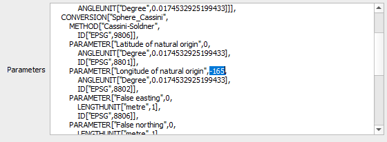

Creating new projections
Thankfully it's pretty straightforward (though not entirely intuitive at first) to create new projections in QGIS:
  • Click on Settings>Custom Projections
  • Click the plus sign to create a new projection
  • Add a name (I use the center line of longitude for my map strip) and make sure that WKT is selected in the format box
  • Click on the copy icon
  • Search for "Sphere_Cassini", select it and click OK
  • Then in the parameters box:
  • Scroll down to the very bottom and delete the last line, and the change the comma on the second to last line to a closed bracket.
  • Scroll back up to the "Longitude of natural origin" parameter and change the value after the comma there to the centerline of the map strip.
  • For each of the rest of the custom projections, I'd recommend copying from the previously defined projection - that way you don't need to erase the last line every time and just need to change the longitude parameter.

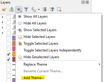

To keep track of them, I grouped them into 4 groups, then created what are called "themes" in QGIS. Themes allow you to quickly display or hide layers. To create a theme, select all of the layers that you want in that theme, then click the "themes" icon in the layers panel>"Add theme". I'd create a theme for all of the features in one strip, then move on to the next until I had all 12 themes.

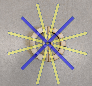

The frame is designed to be assembled in two sections that can then be put together. This way, a light can be put inside the globe and taken out later if needed.
The ribs for the frame are designed as two separate types. I wanted to get the tips of the ribs as close to each other as possible at the top and bottom of the globe so that the individual gores would bend down to almost flat on the top and bottom. 4 ribs with longer tips are spaced out as shown (blue and 2nd image) so that their tips almost touch. The other 8 ribs (yellow and 3rd image) are slotted in between them so they don't interfere with the longer ones. I didn't think to take a picture of this with the actual ribs there, sorry!
