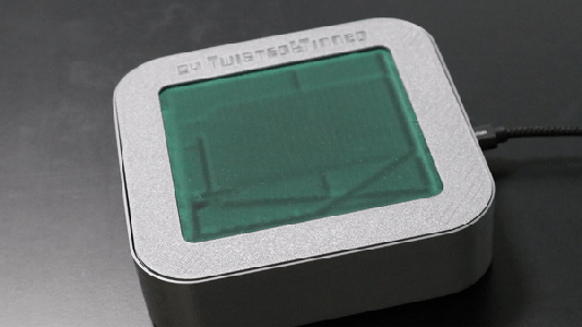

In my search for unique display ideas I came up with this concept. It can be described as the fully magnetic equivalent of a kinetic sand art table (e.g. like this one). Below a magnetic field viewing film a small magnet is moved in 2D by PCB coils. In this way the magnet can draw patterns on the film like the ball bearing does on sand. The display can be used to draw patterns but because I am a big fan of unique clocks I also programmed it so that it can display the time.

Step 1: PCB Coils
The PCB coil design is from this cool project by bobricius. It is a 2-layer PCB with coils for the x- and y-direction. The coils are arranged so that they can be driven like a standard bipolar stepper motor.
In order for the coils on the bottom layer to work the PCB should be as thin as possible. I tried out standard FR4 material with 0.6mm thickness and also flexible PCBs based on polyimide both manufactured by PCBWay. The flex PCBs are only about 0.1mm thick so the force from the bottom coils is much stronger. In my tests I found out that the 0.6mm PCB does in principle work to move the magnet in both x- and y-directions. However when the stepper controller is holding the position with the top coils the bottom coils are to weak to move the magnet. Although this problem could be circumvented by adapting the code for the stepper controller I ended up using the flex PCBs.

Step 5: Code
The code for the ESP8266 can be found on my GitHub. It is based on the AccelStepper library. One issue with the library is that you have to be careful not trigger the watchdog timer of the ESP because it uses blocking functions.
The github repo also includes gcode files with patterns I created from sandify.org. The gcode files can be uploaded to the ESP8266 using the LittleFS tool. The code includes a pattern drawing mode and a clock mode. In the latter the ESP first opens an AP wheren you can configure your wifi credentails. After that it connects to your wifi and the current time is fetched from an NTP server and then drawn on the display.
