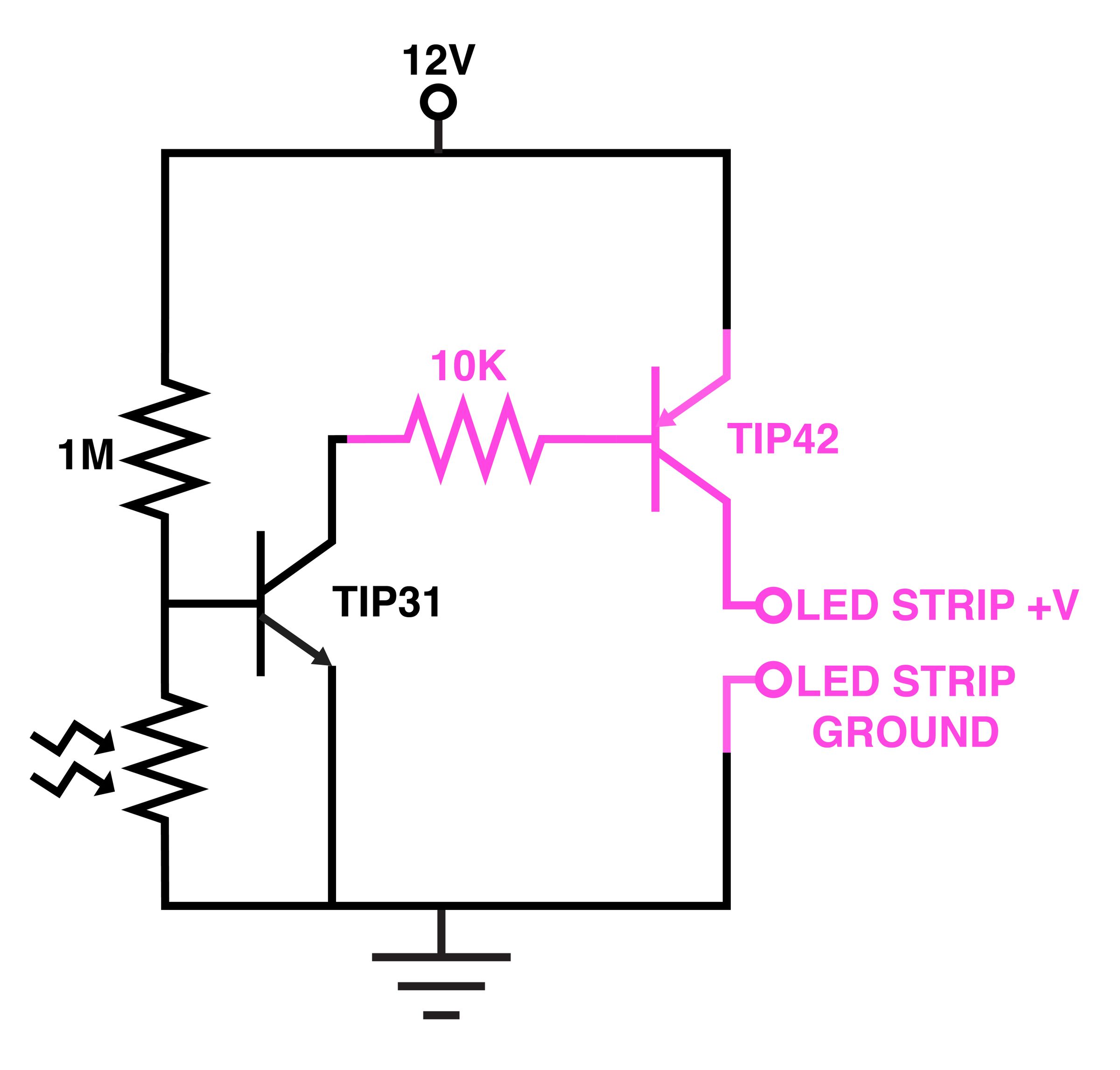

In this circuit we are using two transistors to fade an LED strip on and off. In short, the first transistor responds to changes of light, and triggers the second transistor which responds by turning on and off the LED strip.
By using a two transistor NPN/PNP DC amplifier circuit, we can amplify the input from a photocell to control a relatively high current LED strip. When the base of the NPN gets toggled on via the photocell, the base of the PNP gets toggled off and allows the lights to glow. The default setting for the NPN is to be off when it's light, and on when it's dark. The PNP transistor is obviously the opposite.

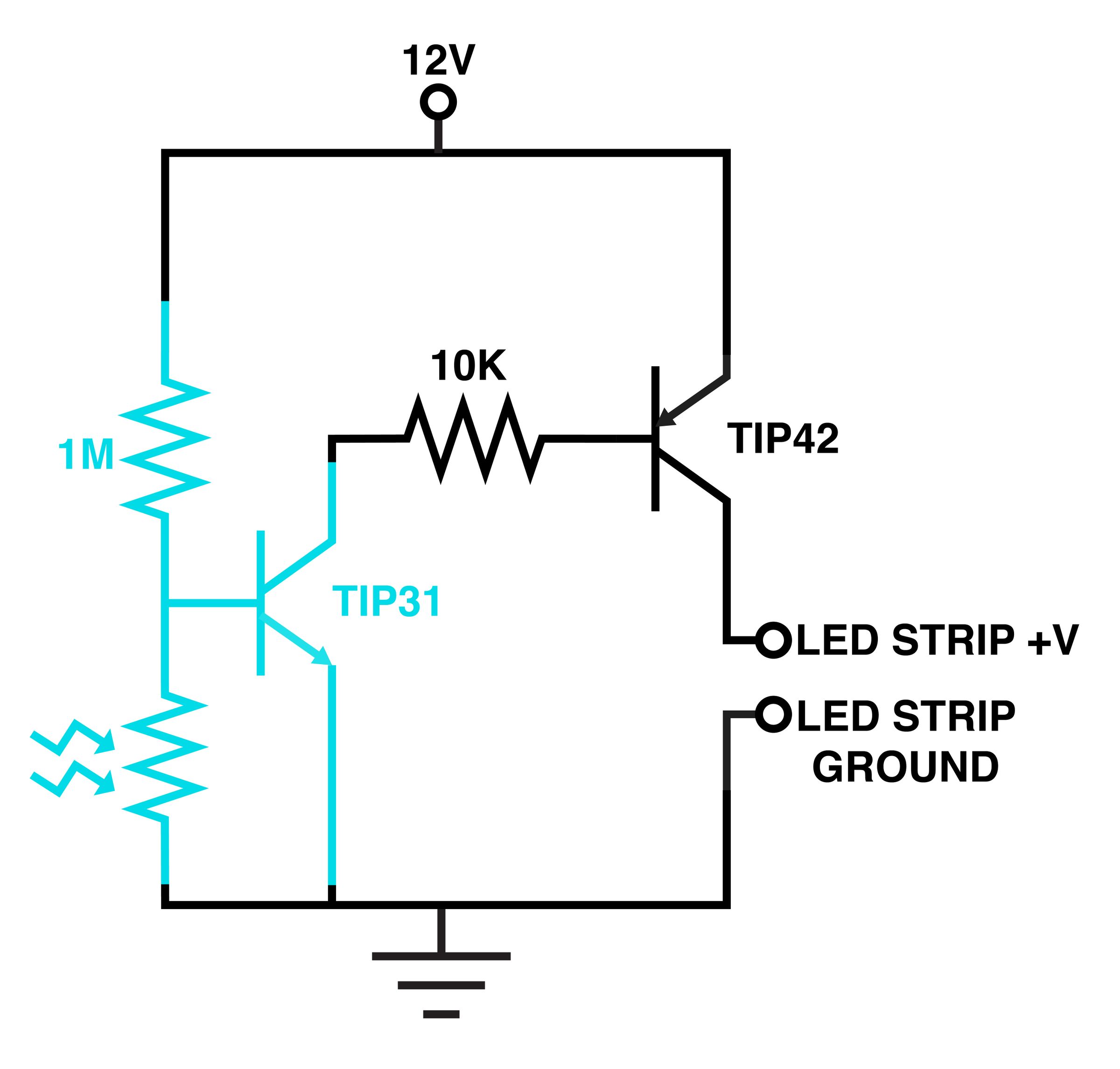

This is considered is a two-stage transistor circuit because each transistor connected together is considered a stage. All this basically means is that each adds some level of amplification to the next transistor. In the first stage, there is a voltage divider on the base pin of the NPN transistor consisting of a 1M ohm resistor connected to power and a photocell connected to ground. This divider provides a varied amount of current to the base pin depending on levels of light. As the light goes down, for instance, the resistance of the photocell increases, and in turn more power is able to flow to the transistor's base. This enables more current to flow between the collector and emitter of the NPN.
In the second stage, a PNP transistor has its base pin connected to the collector of the NPN through a 10K resistor. The resistor is just there to provide a little protection and prevent the PNP transistor from being damaged since the first transistor is amplifying the current on the second transistor's base pin. More significantly, the current flowing through the NPN transistor is actually varying the base pin of the PNP based on the light input from the photocell. By using the gain of the first transistor to increase the power to the base of the second, we are able to provide it with more current and get the LED strip to glow more brightly when the lights go out.

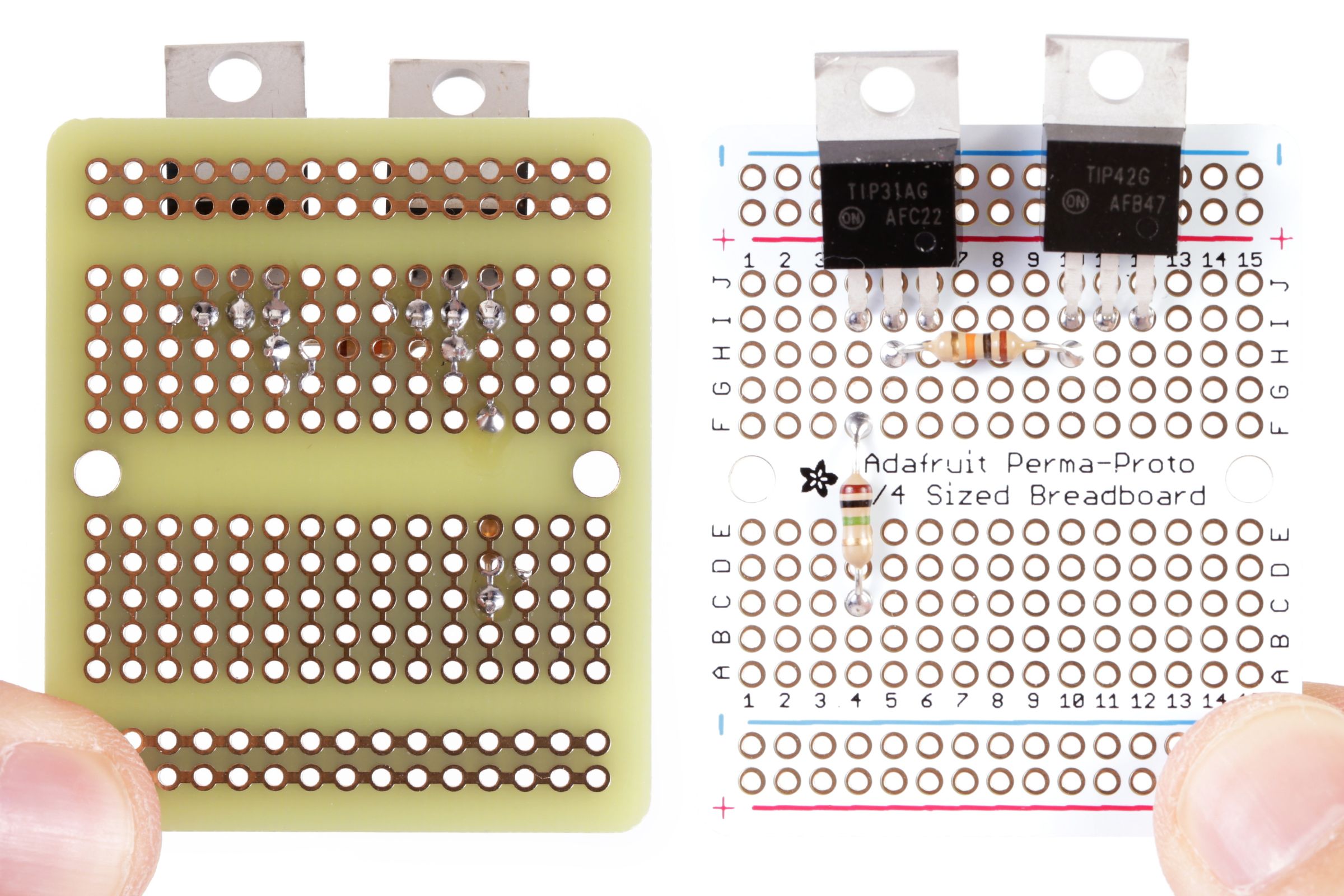

[Now is time to build the circuit board. As a reminder, always go by the schematic and not my pictures. These are more of a loose visual guide of my process than a blueprint.
To begin, I soldered the transistors to the board at a slight angle in order to make sure they would fit between the back of the wooden ring and the wall. However, I was careful not to lay them flat because the metal tab in the back is connected to the collector, and I did not want to risk shorting them together (or to any other part) on any of the solder bus pads.
I then attached the resistors to the board.

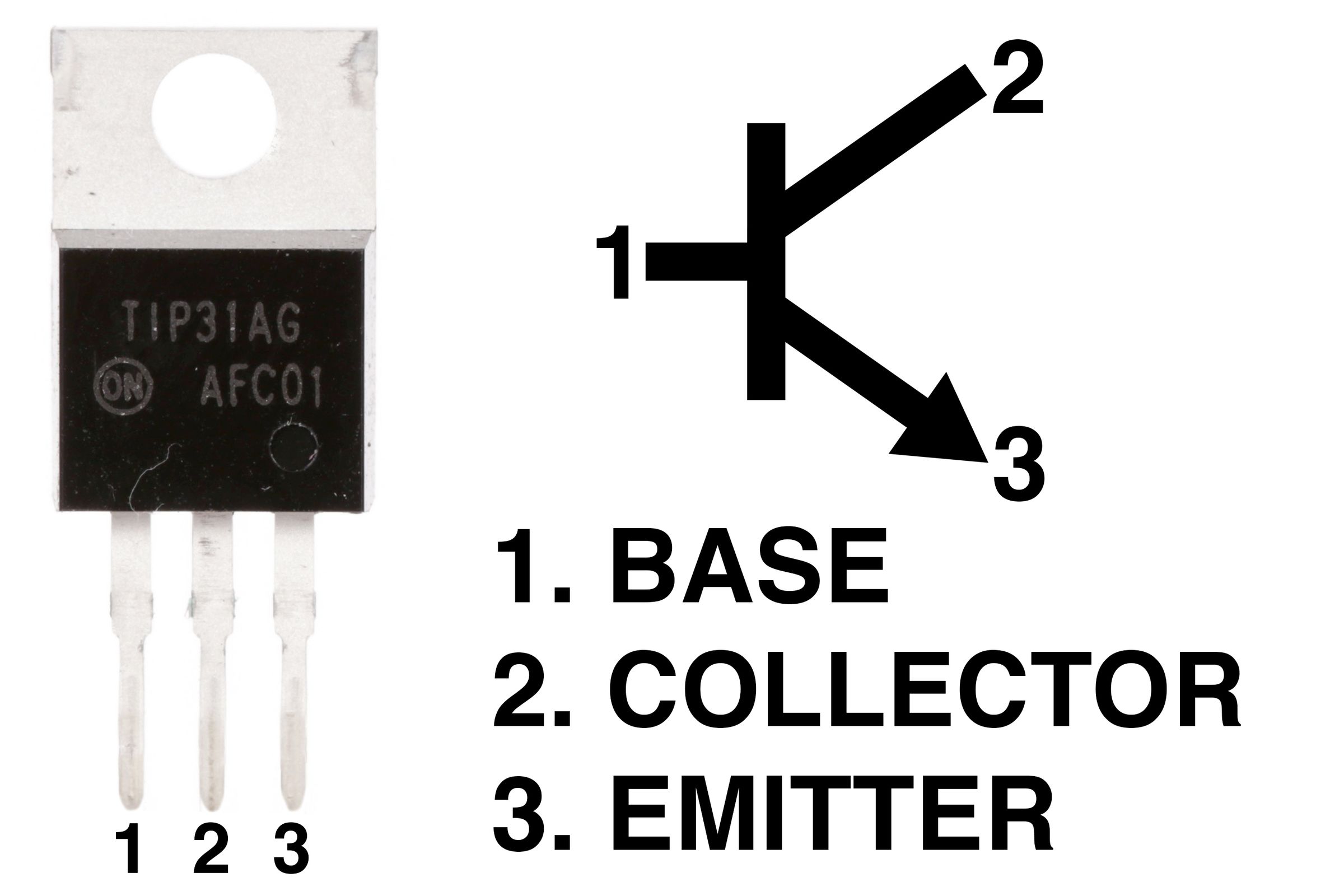

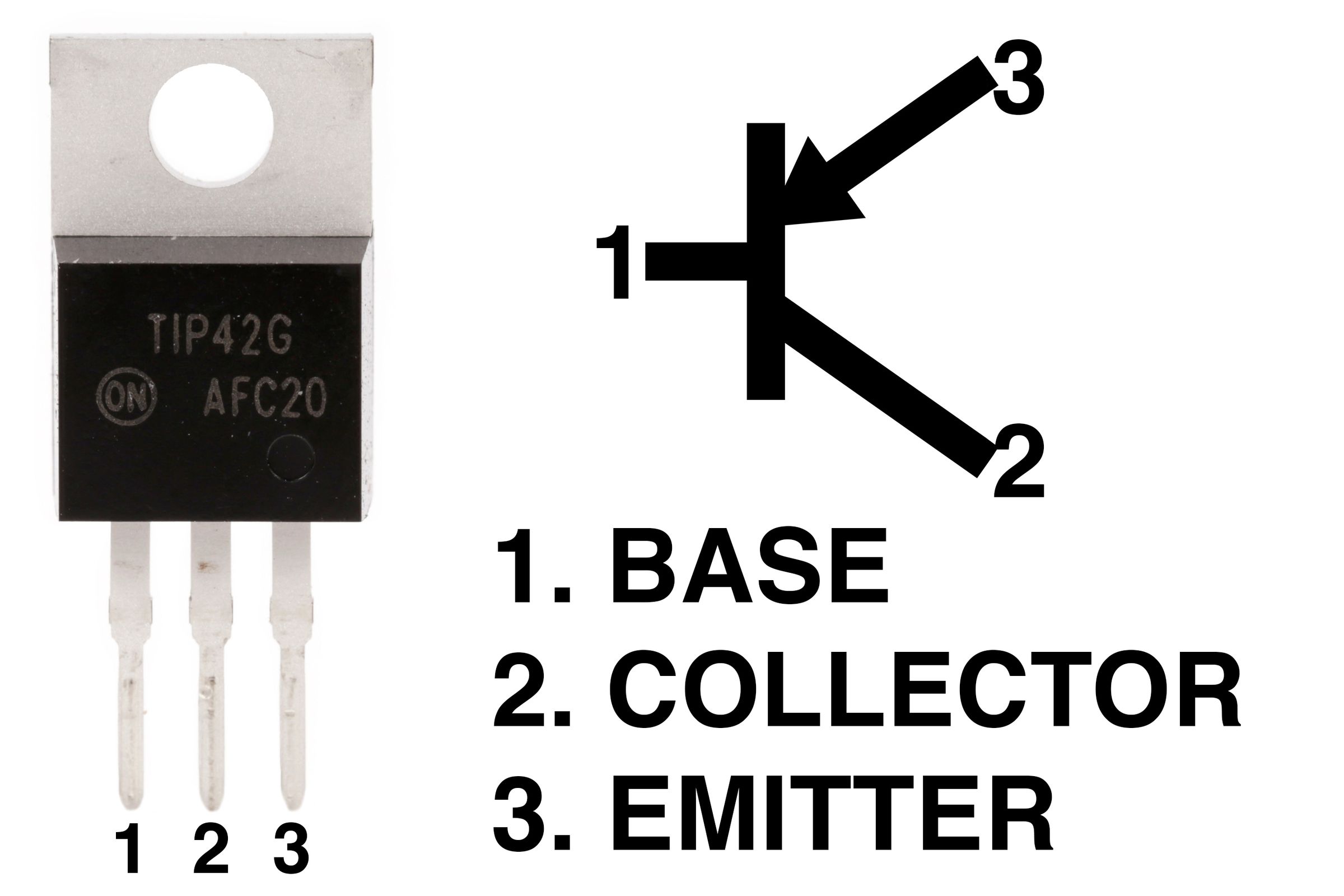

To figure out which pin was which, I used the following pin diagram for the TIP31 and TIP42 transistors.

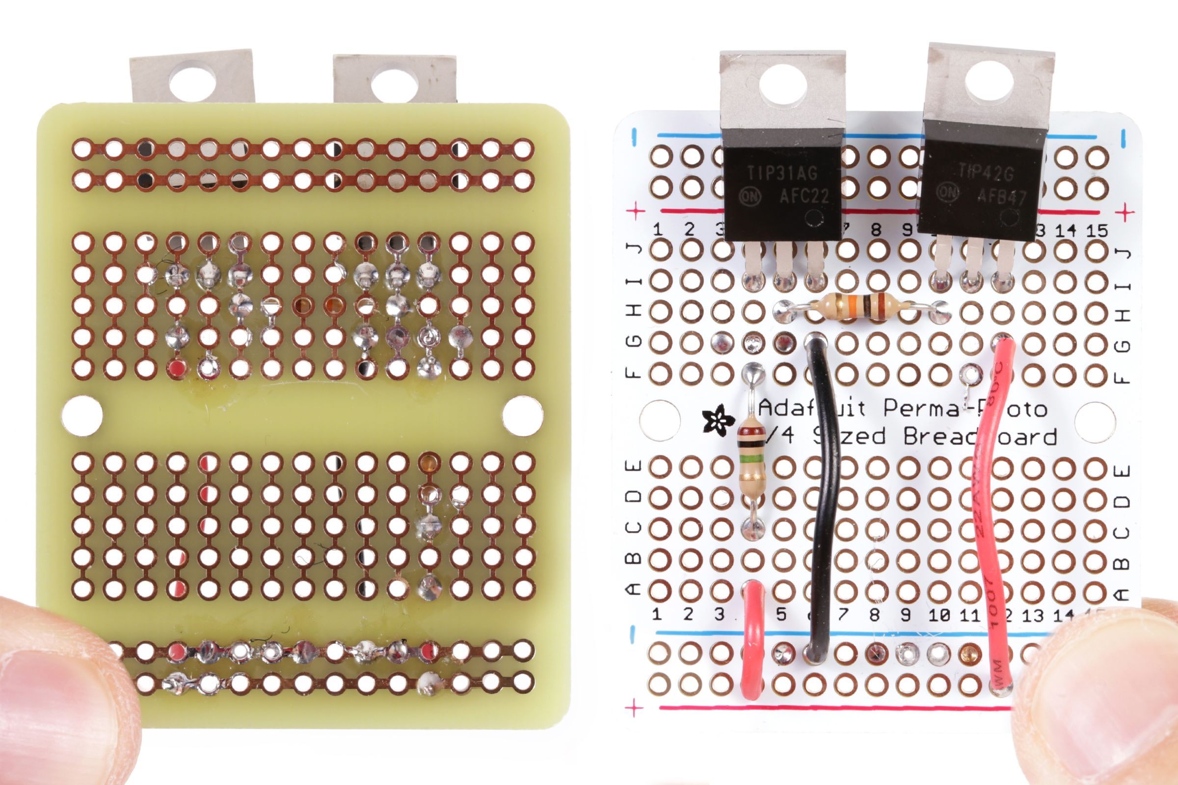

Finally, I connected all of the remaining wiring.
