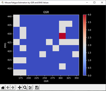

After scrutinizing recent research papers on mouse fatigue, I decided to utilize GSR (galvanic skin response) and EMG (Electromyography) measurements denoting forearm muscle soreness and create a budget-friendly device to forecast muscle soreness levels in the hope of averting permanent mouse-related injuries.
Since muscle soreness levels depending on GSR and EMG measurements fluctuates for different muscle groups, it is not possible to extrapolate and interpret forearm muscle soreness levels by merely employing limited data without applying complex algorithms. Therefore, I decided to build and train an artificial neural network model by utilizing the empirically assigned soreness classes to predict forearm muscle soreness levels based on GSR and EMG measurements.
I decided to employ Wio Terminal in this project since it can easily collect muscle soreness data (GSR and EMG measurements) and run my neural network model after being trained to forecast forearm muscle soreness levels. To obtain the required data to train my model, I connected a GSR sensor (Grove) and an EMG detector (Grove) to Wio Terminal. Also, Wio Terminal can display the collected muscle soreness data on its integrated TFT LCD screen.
Since Wio Terminal supports reading and writing information from/to files on an SD card, I stored the collected data in a CSV file on the SD card to create a data set. In this regard, although Wio Terminal provides Wi-Fi connectivity, I was able to save data packets via Wio Terminal without requiring any additional procedures.

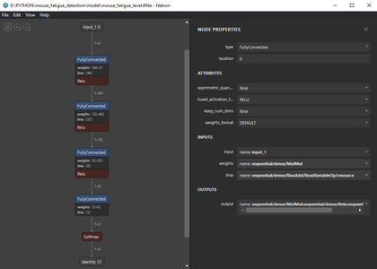

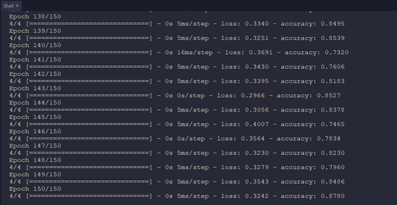

After completing my data set, I built my artificial neural network model (ANN) with TensorFlow to make predictions on forearm muscle soreness levels (classes) based on GSR and EMG measurements. As labels, I employed the empirically assigned muscle soreness classes for each data record while collecting data:
  • Relaxed
  • Tense
  • Exhausted

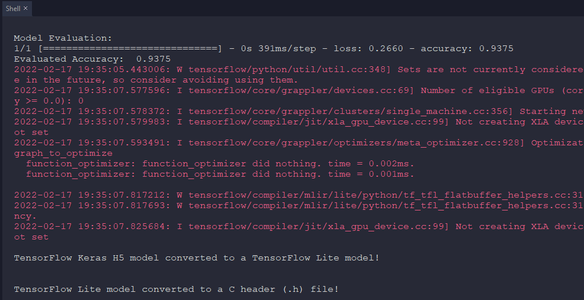

After training and testing my neural network model, I converted it from a TensorFlow Keras H5 model to a C array (.h file) to execute the model on Wio Terminal. Therefore, the device is capable of detecting precise forearm muscle soreness levels (classes) by running the model independently.

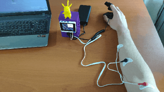

Lastly, to make the device as compact and robust as possible while operating, I designed a Pikachu-inspired case (3D printable).

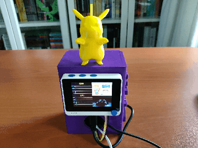

Step 2: Designing and Printing a Pikachu-inspired Case
Since I wanted to collect forearm muscle soreness data and run the model while working or studying, I decided to design a Pikachu-inspired case to create a compact and sturdy device operating flawlessly on my desk. I thought adding Pikachu to my case would be funny due to Pikachu's notorious Thunder Shock attack stunning the opponent's muscles.
I designed the main case and its back cover in Autodesk Fusion 360. You can download their STL files below.
For the Pikachu affixed to the main case, I utilized this model from Thingiverse:
Then, I sliced 3D models (STL files) in Ultimaker Cura.
Since I wanted to create a solid structure for the case and apply a stylish theme to the device, I utilized these PLA filaments:
  • Purple
  • Yellow
Finally, I printed all parts (models) with my Creality CR-6 SE 3D Printer. Although I am a novice in 3D printing and it is my first FDM 3D printer, I got incredible results effortlessly with the CR-6 SE :)

To collect and display forearm muscle soreness data, I connected the GSR sensor (Grove) and the EMG detector (Grove) to Wio Terminal. Since Wio Terminal has one Grove port supporting analog sensors, I connected the EMG (Electromyography) detector via a Grove male jumper conversion cable, as shown in the schematics below.
GSR (galvanic skin response) sensor needs to be calibrated by adjusting the integrated resistor until the sensor generates 512 as the output signal on the serial monitor before wearing it.
You can get more information regarding coding in Step 3.
After printing all parts (models) and completing sensor connections successfully, I fastened all components to the main case and made connection points rigid by utilizing screws and a hot glue gun.
Finally, I attached the back cover to the main case via screws and affixed Pikachu to the top via the hot glue gun.

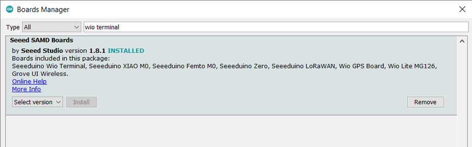

#️⃣ To set up the Seeed SAMD Arduino Core, open the Arduino IDE, click Tools ➡ Board ➡ Boards Manager, and search for Wio Terminal in the search box. Then, install Seeed SAMD Boards.

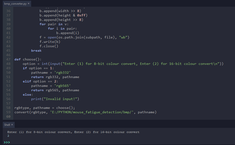

Step 5: Loading and Displaying Images From the SD Card
To display images on the TFT LCD screen integrated into Wio Terminal successfully, I needed to convert them to a compatible BMP file format and then load them from the SD card.
#️⃣ First, open Microsoft Paint to rescale images to the required sizes and save them as the 24-bit bitmap (.bmp) files in the bmp folder.
#️⃣ To convert the 24-bit bitmap (.bmp) files to Wio Terminal's required BMP file format, download the bmp_converter.py file and save it to the bmp folder.
#️⃣ Then, modify the folder location in the bmp_converter.py file and run it.
#️⃣ Enter 1 for 8-bit BMP file format conversion or 2 for 16-bit BMP file format conversion.
#️⃣ Finally, the bmp_converter.py file converts all the given 24-bit bitmap (.bmp) files and saves them to rgb332 (8-bit) or rgb565 (16-bit) folders in the bmp folder.
#️⃣ To display the converted BMP files on the TFT LCD screen, move them to the SD card.
#️⃣ Then, copy the RawImage.h file to the sketches on the Arduino IDE.

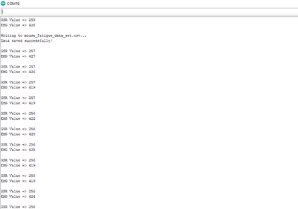

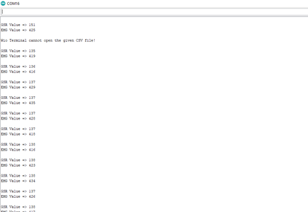

Step 6: Collecting and Storing Forearm Muscle Soreness Data by GSR and EMG W/ Wio Terminal
After setting up Wio Terminal and installing the required libraries and modules, I programmed Wio Terminal to collect GSR and EMG measurements and save them to the given CSV file on the SD card.
Since I needed to assign forearm muscle soreness levels (classes) empirically as labels for each data record to create a valid data set, I utilized the configurable buttons integrated into Wio Terminal to choose among muscle soreness classes. After selecting a muscle soreness class, Wio Terminal adds the selected class to the collected muscle soreness data and then saves the data record to the given CSV file on the SD card as a new row.
  • Button A ➡ Relaxed
  • Button B ➡ Tense
  • Button C ➡ Exhausted
You can download the mouse_fatigue_detection_data_collect.ino file to try and inspect the code for collecting forearm muscle soreness data and saving information to a given CSV file on the SD card.

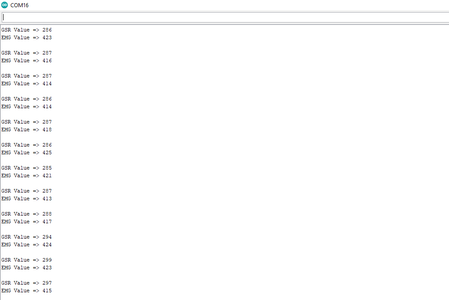

⭐ In the get_GSR_data function, calculate the average of the last ten GSR sensor measurements to remove the glitch.
⭐ Also, add a calibration value if necessary to rectify the generated results.
void get_GSR_data(int calibration){
  long sum = 0;
  // Calculate the average of the last ten GSR sensor measurements to remove the glitch.
  for(int i=0;i<10;i++){
    sum += analogRead(GSR);
    delay(5);
  gsr_value = (sum / 10) - calibration;
  Serial.print("GSR Value => "); Serial.println(gsr_value);
⭐ In the get_EMG_data function, evaluate the summation of the last 32 EMG sensor measurements.
⭐ Then, shift the summation by five with the right shift operator (>>) to obtain the correct EMG value.
void get_EMG_data(){
  long sum = 0;
  // Evaluate the summation of the last 32 EMG sensor measurements.
  for(int i=0;i<32;i++){
    sum += analogRead(EMG);
  // Shift the summation by five with the right shift operator (>>) to obtain the EMG value.
  emg_value = sum >> 5;
  Serial.print("EMG Value => "); Serial.println(emg_value); Serial.println();
  delay(10);

⭐ In the save_data_to_SD_Card function, open the given CSV file on the SD card in the APPEND file mode.
There are three file modes supported by Wio Terminal: WRITE, READ, and APPEND.
⭐ If the given CSV file is opened successfully, create the data record including the selected muscle soreness class to be inserted as a new row.
⭐ Then, append the data record as a new row and close the CSV file.
⭐ After appending the given data record successfully, notify the user by displaying the selected muscle soreness class on the TFT screen.
⭐ If Wio Terminal cannot open the given CSV file successfully, print this message on the TFT screen: Wio Terminal cannot open the file!
void save_data_to_SD_Card(String Soreness){
  // Open the given CSV file on the SD card in the APPEND file mode.
  // FILE MODES: WRITE, READ, APPEND
  myFile = SD.open(data_file, FILE_APPEND);

Step 7: Logging Forearm Muscle Soreness Data in a CSV File on the SD Card
After uploading and running the code for collecting forearm muscle soreness data and saving information to a given CSV file on the SD card on Wio Terminal:
💪💻 The device displays real-time GSR and EMG measurements as line charts on the TFT screen.
💪💻 If Button A (configurable button) is pressed, the device appends a new row (data record) to the mouse_fatigue_data_set.csv file on the SD card by adding the Relaxed [0] muscle soreness class under the Soreness data field. Then, if the device saves the data record successfully to the given CSV file on the SD card, it shows:
💪💻 If Button B (configurable button) is pressed, the device appends a new row (data record) to the mouse_fatigue_data_set.csv file on the SD card by adding the Tense [1] muscle soreness class under the Soreness data field. Then, if the device saves the data record successfully to the given CSV file on the SD card, it shows:
💪💻 If Button C (configurable button) is pressed, the device appends a new row (data record) to the mouse_fatigue_data_set.csv file on the SD card by adding the Exhausted [2] muscle soreness class under the Soreness data field. Then, if the device saves the data record successfully to the given CSV file on the SD card, it shows:
💪💻 If Wio Terminal cannot open the given CSV file successfully, the device displays the error message on the TFT screen.
💪💻 Also, the device prints notifications and sensor measurements on the serial monitor for debugging.
After logging the collected forearm muscle soreness data in a CSV file on the SD card for 15 days, I elicited my data set with eminent validity :)

After scaling (normalizing) and preprocessing inputs, I obtained two input variables and one label for each data record in my data set. Then, I built an artificial neural network model with TensorFlow and trained it with my training data set to acquire the best results and predictions possible.
Layers:
  • 2 [Input]
  • 64 [Hidden]
  • 32 [Hidden]
  • 8 [Hidden]
  • 3 [Output]

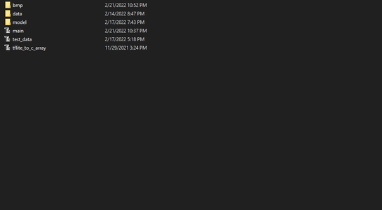

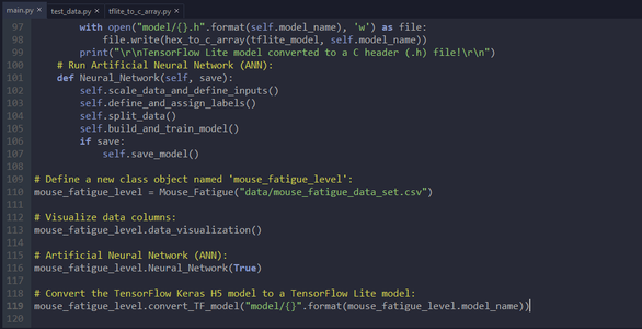

To execute all steps above and convert my model from a TensorFlow Keras H5 model to a C array (.h file) so as to run it successfully on Wio Terminal, I developed an application in Python. As shown below, the application consists of three code files and three folders:
  • main.py
  • test_data.py
  • tflite_to_c_array.py
  • /data
  • /model
  • /bmp
First of all, I created a class named Mouse_Fatigue in the main.py file to execute the following functions precisely.

Step 9: Visualizing the Forearm Muscle Soreness Data Set
Since it is essential to understand a given data set to pass appropriately formatted inputs and labels to a neural network model, I decided to visualize my data set and scale (normalize) it in Python after extracting it from the mouse_fatigue_data_set.csv file saved in the data folder.
⭐ In the graphics function, visualize the requested data column (field) from the given data set by utilizing the Matplotlib library.
    def graphics(self, column_1, column_2, x_label, y_label):
        # Show the requested data column from the data set:
        plt.style.use("dark_background")
        plt.gcf().canvas.set_window_title('Mouse Fatigue Estimation by GSR and EMG Values')
        plt.hist2d(self.df[column_1], self.df[column_2], cmap="coolwarm")
        plt.colorbar()
        plt.xlabel(x_label)
        plt.ylabel(y_label)
        plt.title(x_label)
        plt.show()
⭐ In the data_visualization function, scrutinize all data columns (fields) before scaling and preprocessing the given data set so as to build a neural network model with appropriately formatted data.
    def data_visualization(self):
        # Scrutinize data columns to build a model with appropriately formatted data:
        self.graphics('GSR', 'EMG', 'GSR', 'EMG')

Then, I built my artificial neural network model (ANN) by utilizing Keras and trained it with the training set for 150 epochs.
You can inspect these tutorials to learn about activation functions, loss functions, epochs, etc.
    def build_and_train_model(self):
        # Build the neural network:
        self.model = keras.Sequential([
            keras.Input(shape=(2,)),
            keras.layers.Dense(64, activation='relu'),
            keras.layers.Dense(32, activation='relu'),
            keras.layers.Dense(8, activation='relu'),
            keras.layers.Dense(3, activation='softmax')
        # Compile:
        self.model.compile(optimizer='adam', loss="sparse_categorical_crossentropy", metrics=['accuracy'])
        # Train:
        self.model.fit(self.train_inputs, self.train_labels, epochs=150)
After training with the training set (inputs and labels), the accuracy of my neural network model is between 0.83 and 0.88.
Step 12: Evaluating the Model Accuracy and Converting the Model to a C Array
After building and training my artificial neural network model, I tested its accuracy and validity by utilizing the testing data set (inputs and labels).
The evaluated accuracy of the model is 0.9375.
        # Test the model accuracy:
        print("\n\nModel Evaluation:")
        test_loss, test_acc = self.model.evaluate(self.test_inputs, self.test_labels)
        print("Evaluated Accuracy: ", test_acc)

Thus, I converted my neural network model from a TensorFlow Keras H5 model (.h5) to a TensorFlow Lite model (.tflite). Then, I modified the TensorFlow Lite model to create a C array (.h file) to run the model on Wio Terminal successfully.
To revise the TensorFlow Lite model as a C array, I applied the hex_to_c_array function copied directly from this tutorial to the tflite_to_c_array.py file.
⭐ In the convert_TF_model function, convert the recently trained and evaluated model to a TensorFlow Lite model by applying the TensorFlow Lite converter(tf.lite.TFLiteConverter.from_keras_model).
⭐ Then, save the generated TensorFlow Lite model to the model folder (mouse_fatigue_level.tflite).
⭐ Modify the saved TensorFlow Lite model to a C array (.h file) by executing the hex_to_c_array function.
⭐ Finally, save the generated C array to the model folder (mouse_fatigue_level.h).
    def convert_TF_model(self, path):
        #model = tf.keras.models.load_model(path + ".h5")
        converter = tf.lite.TFLiteConverter.from_keras_model(self.model)
        #converter.optimizations = [tf.lite.Optimize.DEFAULT]
        #converter.target_spec.supported_types = [tf.float16]
        tflite_model = converter.convert()
        # Save the recently converted TensorFlow Lite model.
        with open(path + '.tflite', 'wb') as f:
            f.write(tflite_model)
        print("\r\nTensorFlow Keras H5 model converted to a TensorFlow Lite model!\r\n")
        # Convert the recently created TensorFlow Lite model to hex bytes (C array) to generate a .h file string.
        with open("model/{}.h".format(self.model_name), 'w') as file:
            file.write(hex_to_c_array(tflite_model, self.model_name))
        print("\r\nTensorFlow Lite model converted to a C header (.h) file!\r\n")

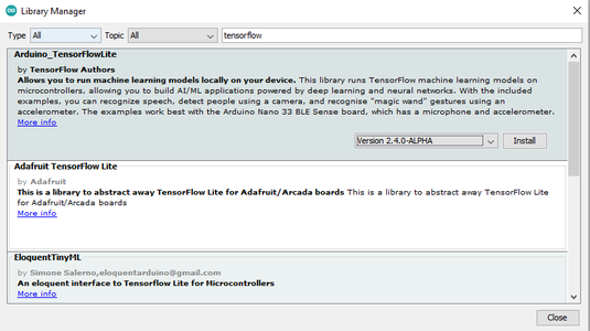

Step 13: Setting Up the Model on Wio Terminal
After building, training, and converting my neural network model to a C array (.h file), I needed to upload and run my model directly on Wio Terminal so as to create an easy-to-use and capable device without any dependencies.
Plausibly, TensorFlow provides an official library to run inferences on microcontrollers with the TensorFlow Lite models converted to C arrays. Although, for now, it only supports a few development boards, including Wio Terminal, it is a fast and efficient library for running basic neural network models on microcontrollers. Since TensorFlow Lite for Microcontrollers does not require operating system support, any standard C or C++ libraries, or dynamic memory allocation, Wio Terminal can forecast forearm muscle soreness levels without needing Wi-Fi connectivity.
#️⃣ To download the official TensorFlow library on the Arduino IDE, go to Sketch ➡ Include Library ➡ Manage Libraries… and search for TensorFlow. Then, install the latest version of the Arduino_TensorFlowLite library.
After installing the TensorFlow library on the Arduino IDE, I needed to import my neural network model modified as a C array (mouse_fatigue_level.h) to run inferences.
#️⃣ To import the TensorFlow Lite model converted as a C array (.h file), go to Sketch ➡ Add File...
After importing the converted model (.h file) successfully to the Arduino IDE, I modified the code in this tutorial from TensorFlow to run my neural network model. Then, I employed the 5-way switch integrated into Wio Terminal to run inferences so as to forecast forearm muscle soreness levels:

After importing and setting up my neural network model as a C array on Wio Terminal successfully, I utilized the model to run inferences to forecast muscle soreness levels.
After executing the code for running inferences on Wio Terminal:
💪💻 If the 5-way switch is pressed, the device runs inference with the model by employing the most recently generated GSR and EMG measurements as the input.
💪💻 Then, the device displays the output, which represents the most accurate label (muscle soreness class) predicted by the model.
💪💻 Each muscle soreness level (class) has a unique image (16-bit BMP file) and color code to be shown on the TFT screen when being detected as the output:
As far as my experiments go, the device operates impeccably while predicting forearm muscle soreness levels (classes) :)
