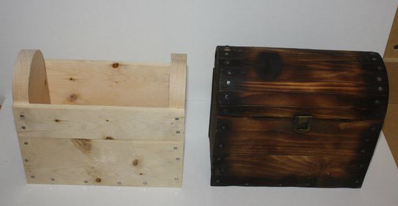

Step 3: Front and Back
While waiting for the glue to dry, cut the front, back and top pieces. I used thin material for the front, back and top.
Since this is a rustic looking pirate chest, I didn't make the panels the exact same. Cut a bunch of different sized pieces that are all the same length.
Glue and clamp the front and back panels on just like you did with the sides.
Once the glue is set and the clamps are removed, drill 1/16th inch holes wherever you want nails. I spaced my out very sloppy to go with my rustic/sloppy theme. If you try and just hammer nails in, the wood will almost always split. The nails are there just for show anyways, the glue is doing all the work. I've also put nails in the sides.

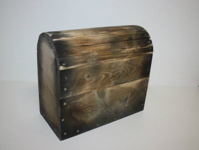

Step 5: Painting and Burning
Give your box a quick anding to help round off the top and remove any sharp edges. If you try and skip the paint step, your burning won't go well. The torch won't be a able to get into the little nooks and crannies that the paint does.
Lightly paint the all the edges and a put a few shots on the faces of the body. Pay special attention to the nail heads, the torch won't do a good job around them
Once the paint is dry, fire up the torch and lightly burn the entire chest. You can always go back and darken areas that need it so don't get carried away.
After the box is completely burnt and cooled, rough it up once more with some sand paper to expose some fresh wood. and break up the paint.

Step 7: Hinges and Latch
The possibilities are endless when it comes to hinges and latches, I use whatever I can find. If you can't find antique brass hardware or screws, I've always had good luck heating shiny parts up with my torch until they are red hot and then letting them cool. Instant Antique!
Place the hinge or hinges where you want on the back and screw them into place. I find the small hinges hard to work with so I put a small dab of super glue under them before I try to screw them in. Same goes for the latch on the front.
Once its all assembled and dry, I like to rub the entire chest with tung oil. Its not necessary so I didn't mention it earlier but it adds a warm look to the chest and also helps to protect the wood from drying out, cracking etc.
