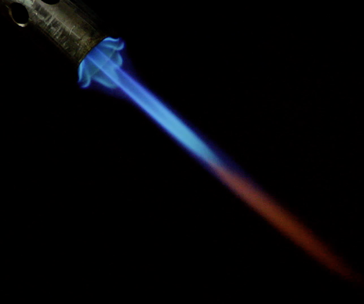

Today, I will tell you about the process of making a catalytic burner. This is a catalytic heater that does not have an open flame outside its casing. So, we can observe the fire, but it will never burst outside! Therefore, this burner is safe and actively used in hiking trips when it comes to heating a tent or a person outdoors, even in strong gusty winds!

Using the paper template, we cut out the metallic mesh, keeping an eye on all the height dimensions provided by me. It is essential to seal the seams in the mesh joints well so that catalytic vapors only come out through small holes and immediately ignite. Otherwise, your flame will burst outside, the project's essence will be disrupted, and you'll end up with a regular open flame that has nothing to do with the catalytic process.
