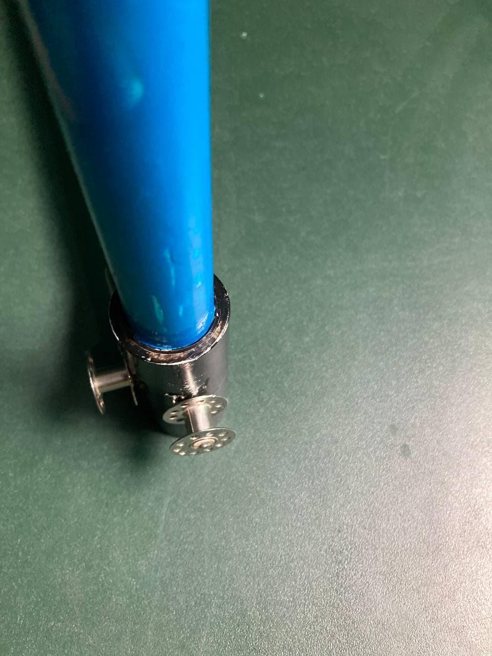

For moving along X-axis, a circular slider is used and For the Y-axis a piece of PVC pipe is used with a small piece of cardboard.
Step 4: How It Works!
For sliding purpose 4 bobbins are used.
2 bobbins for the slider of X-axis and other 2 bobbins for the slider of Y-axis.
Thread is bent along the bobbins which is glued with the sliders of each axis.
By rotating Bobbins the slider can be moved in to and fro translational motion.
