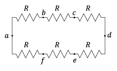

Step 4: Make a Ring
Perform the final connection so that the 6 resistors form a ring. The multimeter leads can now be connected to 6 different positions, let’s call them a, b, c, d, e and f.
What resistance do you expect when measuring the resistance between a and d ? We now have two branches in parallel, each with a resistance of 3R. The equivalent resistance of resistors in parallel is calculated as the sum of inverses: 1/Req=1/R1+1/R2+1/R3+... . In case of two resistors, this simplifies to the product divided by the sum: Req=(R1*R2)/(R1+R2). And in case of n identical resistors, the parallel resistance is simply R/n. So we expect 3R/2=1,5R. Is that what you measure?
Of course, the multimeter leads can be connected at other points too: what about the resistance between point a and c? We then have one branch with a resistance of 4R and one branch with a resistance of 2R. So in parallel, this gives Req=(4R*2R)/(4R+2R)=(4/3)R or 1,33R. And between a and b? Req=(5R*R)/(5R+R)=(⅚)R=0,83R

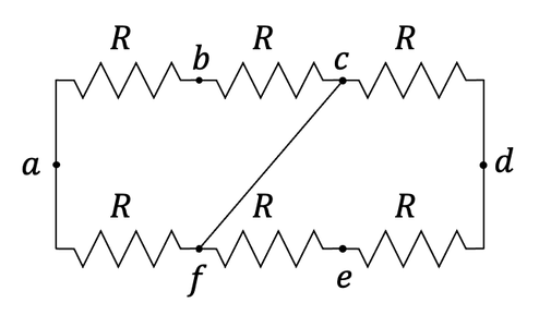

Step 5: Make a Short-cut
Lets go back to the resistance between a and d. The resistance was 1,5R. We will make an additional connection with the crocodile lead between c and f. Before measuring or calculating, argue what you expect: will the resistance remain at 1,5R, or will it get higher or lower? Think of the equivalents: in a network of tubes, you add an additional zero-resistance tube. Or in a city with narrow streets, you open a new wide road, will the traffic increase or decrease? Correct, the extra 0-Ohm connection will make it easier for the current to flow, thus the resistance of the network can only go down.
It may not be immediately obvious, but the network can be redrawn such that it is more obvious that we have now two subcircuits in series: each subcircuit contains an R and a 2R in parallel. So we get Req=2*(R*2R)/(R+2R)=(4/3)R=1,33R. Indeed, the calculations confirm our intuition, the short-cut has reduced the resistance from 1,5R to 1,33R. If all is connected well, the measurement should confirm this
