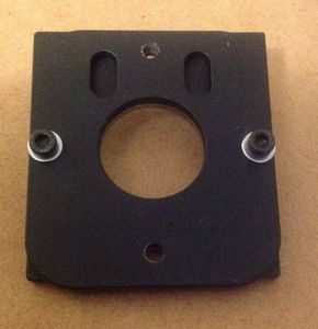

This mode will cut off the front mounting hole for the Z Axis stepper motor, but there is enough room at the back of the plate to make a new one. Using an M3 Nut and Bolt, flip the plates so they face in opposite directions and bolt them together tightly ensuring they are completely square. Drill through the existing holes on each plate into the opposite plate, this will make two new holes while removing the need for guesswork, measuring and maths

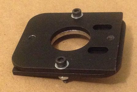

Because there will be a bolt head where there wasn't before, you'll need to notch the shim plate for clearance. Mark centre of the plate between the two mounting holes, centre punch along the line and drill multiple holes to make up the notch. I used a small grinder to clean up the notch after drilling. If you have a bandsaw or grinder you could easily use that.

Once all your drilling is done, its time to remove the excess material on the Z Axis plates that are causing the problem. To do this, you'll need to hold the Z Axis bearing and Wave Spring up to the plates to get your measurements. Hold it in place and mark where you need to cut leaving enough room so the Wave Spring won't stick out beyond the plates. Cut them down as straight as possible using a hacksaw, bandsaw, grinder, water jet... whatever you have at your disposal. I wanted my mod to looks as stock as possible so after cutting, I cleaned up the edges and sanded down the front points so they are rounded like the original.

Follow the original instructions to put everything back together except for 1 important part. Don't use the steel washer on the bottom side of the new hole you drilled. The Z Axis Shim Plate isn't thick enough to fit the bolt head and a washer. The washers aren't doing anything anyways.
Step 8: Lots of Room, No Compromise, One Happy Shapeoko
I was able to move my Mounting Bracket back onto the carriage and doubled nutted it to make sure it never rattles loose. You can see there is lots of clearance now.
